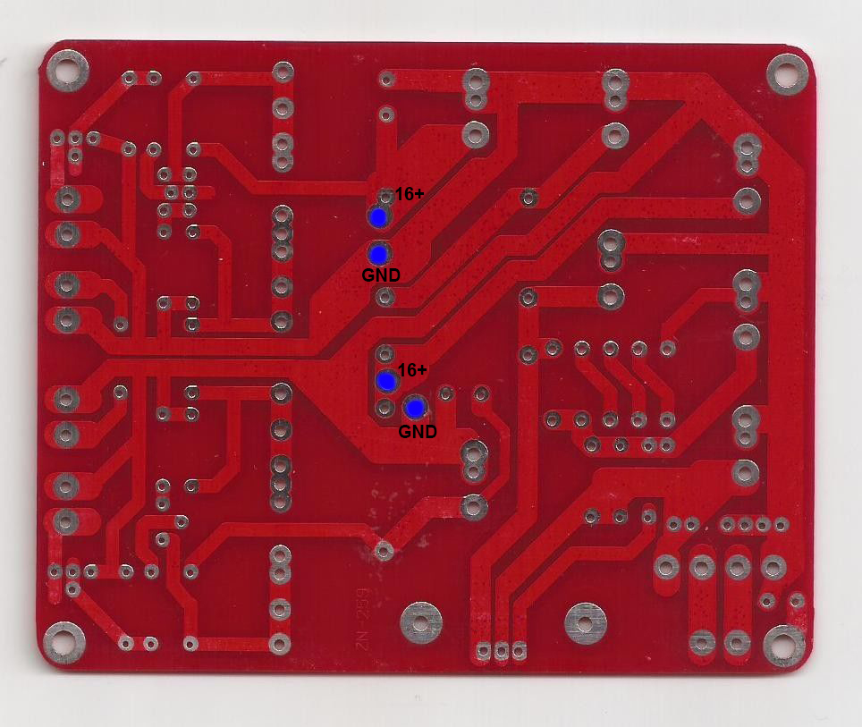

thare are not marked test points on schm and I can't decipher from pcbs what's in case

there must be around 16V at Q1 gate , so around 12V a t drain , going to audio circuit

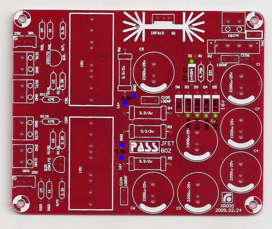

Here you have good view of the PCB, still need to find out the 16+ point on the schematic. Edit; if I look correct one +16 is between r6 and r4
Did some measurement. The zeners read a little less than 4volts. I measured between green points also between D1-D2 etc. I can see it sums up from D1 17.17 to 29.7 D5.
Only thing I don't understand why it is 8.9v at the checking points. Must find out it I need to use less or more zeners.
Sorry I have no background in electronics. Thanks for any help.

check zener string to have 16V across (thats also voltage across C7), then you'll have 12V at mosfet's drain
current through zeners is OK , but they are off value
you can also just add one more ( of those shitty ones) in series
you can combine different values of zeners , as long you get 16 to 16V5 as final voltage across them
Are you sure the correct value zeners are used?
You're getting about 12.8V across the zeners Z2 to Z5. Subtract the Vgs of the Q1 (~4V) and the 8.9V C2 voltage is reasonable.
My guess is that if your goal is to get around 16V to the jfet circuitry then you need
to change the zeners to sum up to closer to 20V. And you may want to decrease
R1 to make sure the zeners have enough current to give a stable voltage.

I have never measures volt on zeners so thanks for the link Dennis. I think I will go for the 16volt to R7 mark as suggested by Nelson. So you are right I probably need 20v zener string D2-D5 and change R1 to 1,5K ohm.
Woody, good that you noticed. I will change C1 as well!
