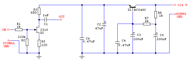

Drawing a load line
I tried to understand how the attached very simple circuit of juma works and how can I draw a load line for it, but I'm not that bright 🙁
I can simulate it, modify it for higher gain or lower THD but I want to understand more.
I read this article Simulating a FET Amplifier, however, it calculated the Rs by knowing the Vgs and Id based on the load line readings.
Can somebody explain it to me. Thanks!
that 7.68V reading tells you the voltage across the drain resistor.
It indicates that the sim has biased the jFET at ~120% of Idss.
You must reduce the bias current.
The -52mV confirms the bias current.
The -ve source voltage will become slightly +ve when the bias current is <Idss.
This will then be the Vgs and is normally a negative voltage.
The sim is showing a +ve Vgs voltage (the gate voltage is above the source voltage).

1. Right
2. The same way as for any similar amplifying device. Google for it.
3. Study the transfer characteristics in the datasheet and think Vgs, not Vin to ground.

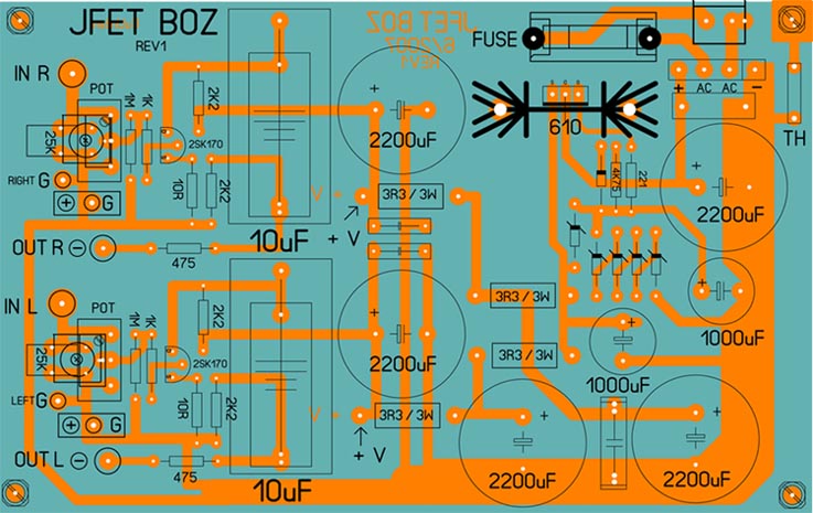

OK...I'm going to try a layout similar to Manu's as seen here:
I have 2 questions...
1. What would be the best way to wire up a center tapped xformer? Namely what to do with the center tap?
2. How would I wire up a toroid with dual secondaries? Namely, how to wire up the 4 secondary wires? Lets say its an Antek with one blue and one green per secondary.

It should be clear for everybody that I made this PCB-layout simply in order to test the JFetboz at the time it was published. And it worked fine for my purpose. I never pretended the layout were perfect, nor ready for production of any kind.
Newly cjkpkg found some similar-looking PCBs for sale on the web and contacted me.
I told him that I don't have anything to do with that, but that he could have the PDFs of my silly layout, if he wants, in order to etch his own PCBs or adapt the layout to his needs...
Thats all ...

besides - I know that Manu later made some much better pcbs

Manu
I did try to do the toner transfer method of Manu's design I got less than desirable results. I found a pcb online that I was able to utilize into my end result.
