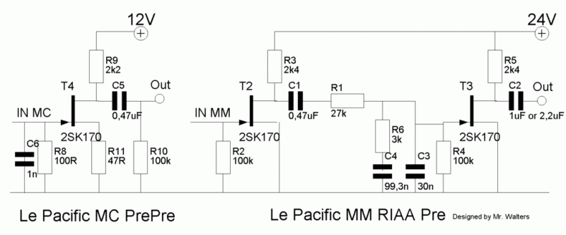

And even simpler...
Just finished reading entire thread.
Man! what a thread! From total OT to simple EE... thoroughly enjoyed.
Before I start tinkering with this circuit, I have just one question: Should I order matched JFETs or just bulk order them? These 2sk170s seem everywhere these days.

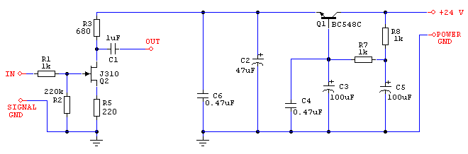

Following the advice from reverend Zen Mod 😉 three months ago I tried J310/JBOZ as a preamp for F5. The results were very good. They were posted and discussed on a local Serbian forum. Id was 10-11 mA. J310 were from ON Semiconductors (Idss 35 mA). Preamp's gain was 2.1 V/V
Here is the schematic:
I want to build the circiut .
Is the value of the power supply capacitors critical ? my spare bin has higher values .
Do I need to match the IDSS of the J310 ?
Thanks for the guidance
kp93300
I would use larger capasitors in the power supply(1000uF+), but the power supply capacitors are not critical.
You'll probably need a larger output capacitor, depending on the power amp you'll be driving and how much you enjoy the lower octaves(normal value is 10uF).
Also add a resistor to ground after the output capacitor (If you look at the initial Nelson Pass schematic, he used 2K2).
You don't need to match the J310's.
You'll probably need a larger output capacitor, depending on the power amp you'll be driving and how much you enjoy the lower octaves(normal value is 10uF). ...
That preamp was designed for F5 (Zin=101k) so 1uF is all that is needed in that case. For any other amp, as you say, requirements may be different.
.... Also add a resistor to ground after the output capacitor (If you look at the initial Nelson Pass schematic, he used 2K2). ...
Nelson used that 2k2 to lower the gain. We don't want that in this sch. so something like 1M will be OK if you don't put this preamp in the same case with the poweramp (as it was intended with F5).
