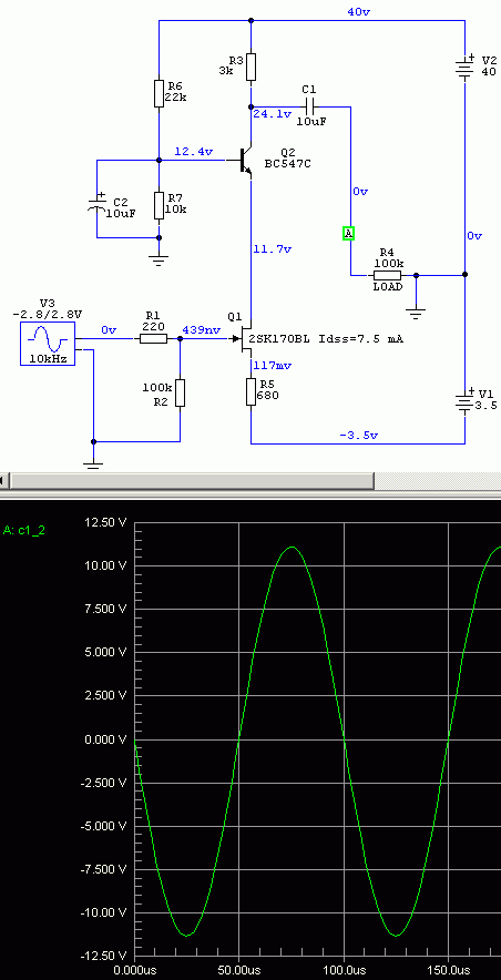

Here you are (2Vrms IN - 8V rms OUT):
Sorry BFNY you missed my point.
The point has nothing to do with output voltage. It has to do with the fact this circuit will not accept greater 500mV at the input.
Here is another image. On the left is the original version with slight resistor changes to reduce the gain slightly. On the right is the Tschrama version.
I just checked that.
I get the same result for original version, however with Tschrama version signal has dropped when measure right at the gate.

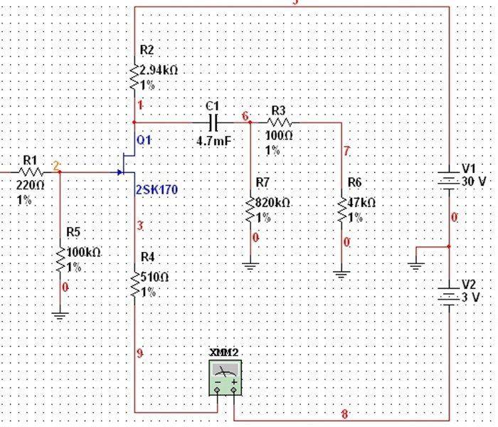

14dB version
I changed the value from Juma's original circuit.
2.94K and +30V. with the sim, I get about 14dB gain.
for my needs, max Vin is 1.25Vrms. I get 6.22Vrms out.
how bad would the distortion be? is this pushing it too far?
I don't know how to check for distortion,etc.. with the sim.
just know the barebones stuff with the demo.
thanks
