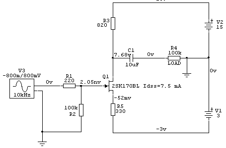

Hi guys,
For the 2sk170, if I have only +/-15V on tap and require only 2~3x gain, how much do I need to scale down the drain resistor?
With the -15V supply, do I need to regulate down to -4V to use 680ohm (refer to Juma circuit) or can I use -15V direct with a larger source resistor?
TIA.🙂
ChuckT said:
Hi guys,
TIA.🙂
If you want to use -15V for negative rail your source resistor needs to have much higher value but then your drain resistor needs to be about 3 times higher than source resistor because their ratio determines the gain of a circuit. Larger value of the drain resistor dictates higher positive rail.
So, there is still no free lunch 😉 you'll have to preregulate negative rail down to about -4V (-3V for +15V pos. rail). In any case +15V (positive rail) is far to low if you want output level higher than 1-2 V RMS.
This is how it would look with +15V (gain of 2.2 , undistorted output about 2-2.5V peak max.) :
Thank you very much. 🙂
I'll definitely try it. I have some matched 2sk170 with Idss around 8.5ma.
So may be I can tweak the values a bit.

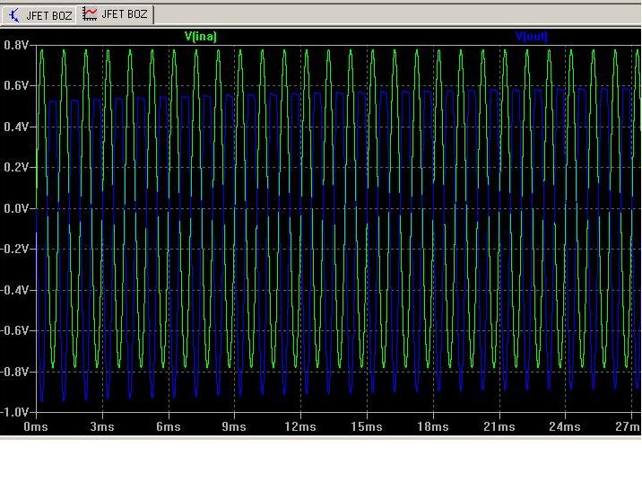

thanh1973 said:
Look at the screen grab
O.K. Maybe you have about 5-5.5V at the drain under no signal conditions? When under positive going input, you swing negative on the output, you are going to clip at about -4.5--5V. If you want more, you will have to raise the quiecent drain voltage.

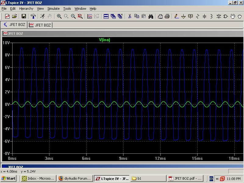

thanh1973 said:
I have a question.
Why does this circuit clip when 500mV (music signal) or greater is seen at the gate of the JFET regardless of gain (ie even at unity gain)?
What do you mean by "even at unity gain"? Using the attenuator in front so input = output?
Or re-adjusting resistor values so the upper and lower ones are equal to give unity gain?
