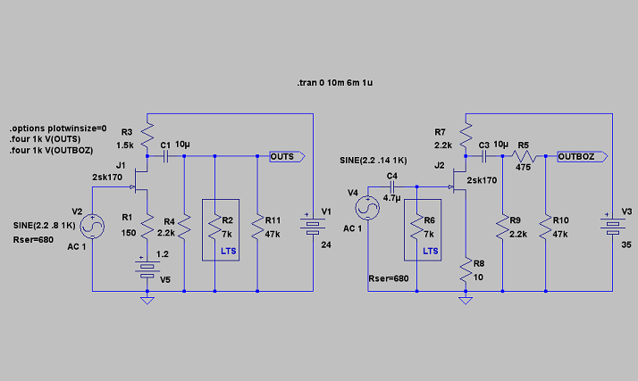

Hey Tolu,
On the left is your single FET solution given the 2,2V offset DAC, your 7kohm Lightspeed and 24V DC.

One of the reasons for considering this circuit is that it has been described as transparent and "live", both parameters that are of the utmost importance for me.
Could you draw your circuit? I think it is one of the most refined among the people that posted in this thread.
A PM/email would be fine as well if you dont want to post it publically.

I probably can post a Jpeg of the board I used for this design I am sure you could follow the circuit quite easily from that. Interested?
Sure, but i'm not in a hurry. If you later have the circuit drawn it would be even better.
I plan to make identical circuit for both bass and highs, since i dunno where i'll cut and want exact same quality.
I tried the original circuit. Distortion was as reported in the previous posted graphs. Not exactly a viola! experience - Worse than a 6SN7 tube line stage.
I tried degeneration - not much help.
Then tried the j310 - Eureka, Washington!
It is tweaky, but after many hours pushing the FFT for results. what emerged was a clear picture - this JFET can rock as a naked single 1 trick pony gain device.
The story is simple - name your gain, and name your voltage. The more clean gain needed, the more voltage needed.
What is clean? how about 3x gain, 1 V rms out @ .02% -
no feedback, no current sources, 25V supply. But you want drive? direct couple to a B1, where the gain stage output biases the buffer input at 1/2 the supply voltage. No caps on input or interstage. Details at 11
