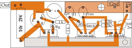

Will it help if I can post a pic of my board layout I did in Coreldraw before making it? (It includes the pre-reg and CCS. The shunt element is on stripboard.)

most critical part of any PSU design is exact physical layout ;
look here , at atached scrible
and - looking at upper half , you'll recognize Shiny ;
look how ground lines are drawn .
conclusion ?
btw. - I'm not good in starring at pcbs ... especially now , with the flue .
maybe someone else can comment , if you post a pic ;
just export it from Corel to any other graph format , then attach here
if you can't do that , send me a cdr file to >choky@neobee.net< , and I'll do that for you

I'm afraid my psu looks nothing like that. It is all modular. Trafo; Board for bridge (Schottky diodes// Russian paper caps) + snubber; crcrc filter section - 330uF - 10ohm - 330uf-10ohm-10000uf//680uf Pana//.22uF polyrop; board for prereg and CCS; another board for diodes and darlington. Each section star-earthed to chassis ground. You think the grounding scheme may be where the problem lies?
BTW, there were some times that I had it stable, but noticed that when I connected the output wires, it started to fluctuate. Wires are about 1.2m long old computer power cable.
I will see what I can do with the cdr file, although that is only the prereg and CCS board.

Sharp eyes. No, just bad drawing. That circle is a resistor on end and it joins to the 2 x 1.5k resistors by its wire, not a track as it appears to be on the drawing.
BTW, many of the resistor values have since been changed in trying to get it sorted out. I also have a decoupling cap next to the trimpot (10uF tantalum).

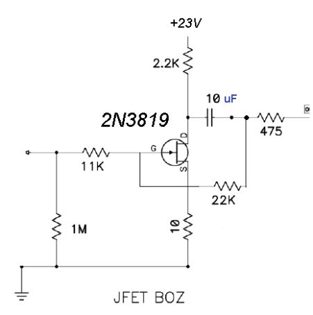

Hello,
I would like to replace the NE5534, single op-amp in the analog out of my CD player, with the appropriate version of the JFET BOZ. However, the BOZ output may be too high for my original BOZ driving a DIY (Andrea Ciuffoli's 2005 Power Follower) SE MOSfet amp.
I have read through the tread looking for discussion on the particular topic of lowering the JBOZ gain and discovered the following posts:
Post #280 : In response to a question about JBOZ as a unity gain buffer, Zen Mod suggested changing the gate stopper resistor to 10K and adding another 10K resistor from the gate to the outside of the output cap.
In Post #579: tschrama suggested that the gain could be increased to 5.5dB with a gate stopper resistor increased to 11k and the feedback resistor increased to 22K.
In post #583 : tschrama posted a schematic of this, but showed a 2N3819 in place of the 2SK170 (see below).
I think the NE5524 is configured for a gain of about 2 in my CD player (Rotel RCD965BX with SAA7323 DAC).
My question is, can I use the modified JBOZ, as posted by tschrama in post #583, to replace the NE5534 and output stage? My CD player is heavily modified and I have only a 10uF Black Gate and a 47R resistor in the signal line between the 5534 and the RCA connector. No muting ransistors or filter networks. I plan to run the JBOZ at +16V.
Do I need to make any changes to the tscharma modified JBOZ to use it as CD analog out? (I would use a 2SK170 instead of the 2N3819 shown)

Re: JBOZ as CD analog out
use original Papa's schematic
put trimer pot of 3k3 instead source resistor
connect just one channel and twiddle pot until you are satisfied with gain
measure resistance of pot , then place resistor of nearest standard value in both channels
that's called source degeneration - fancy word for "local feedback"

Thanks Zen Mod. I will try this in the next couple of days. Have to wait for delivery of 2SK170s.

Hi Zen Mod,
While I am waiting for JFET to arrive, I have another question about using the JBOZ to replace a NE5534 op-amp in a CD analogue output stage. If I put a 3k3 trimmer pot instead of the 10R source resistor to adjust the gain, as you recommend, can I remove the 25K pot on the input?
jnewbold said:
Hi Zen Mod,
even better -you can put 2k2 trimmer (my typo was 3k3) ;
yes - you don't need pot , but leave 1M resistor in place
watch that you don't connect DC on input of Jfet BOZ
Zen Mod said:watch that you don't connect DC on input of Jfet BOZ
I hadn't givent the DC from the DAC any thought. The schematics shows the external op-amp connected directly from the DAC's internal op-amps, so there may not be any DC on the input of the external op-amp. However, I will measure later today and add a cap if there is any DC present.
Just another two questions. If (when) the JBOZ is successful as a CD analogue output, can I then remove the input cap on my original BOZ pre-amp? I don't use any other sources and, in fact, my original BOZ has only one set of input RCAs.
Or, thinking about this a bit more, perhaps I can use the JBOZ as posted by NP (without 25K pot and with the 10R source resisitor) as a high gain CD output and bypass BOZ pre-amp direct to amp, via either a passive pot or a B1 Buffer?
Thanks again,

correct ;
yes ;
you can try that , but success really depends of what are demands for driving your power amp
Checked DC at input in of NE5534 and measured 2.56V, so will have to use a cap at input of JBOZ. Should ther cap be placed after 1M resistor and in series with 1K?
1M is here to keep gate of poor little critter on gnd potential ........ and when current through source resistor is flowing ....... poor critter is suddenly self biased 😉 (via difference often called Ugs , or potential between gate and source )
so - leave 1M near gate , 1K where it belongs , and place needed cap between nasty DAC and cheerful JFet BOZ
