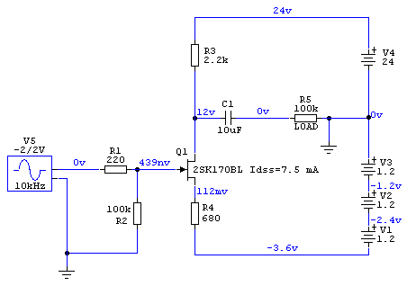

JFET BOZ idea in this thread is troubled with too much gain that 2SK170 gives. To make it acceptable we attenuated the input signal and overloaded the output, whic are not my favorite strategies, so I tried it a bit differently: small negative power supply to Source pin so we can have small gain (6-12 dB, 2 x - 4 x) and high bias (5.5 mA with 7.5 mA Idss JFET) at the same time.
Negative PS is made from 3 x 1.2V rechargeable battery cells or cell-phone battery (most of them are 3.6 V). With 5.5 mA draw either will last for a long time.
I used existing +24V PS but higher PS voltage (up to +35 V) won't change anything important.
Playing with R3, R4 and -PS voltage may give other interesting results. This version works nice for me.
This JFET BOZ can put out clean 5V RMS and it drives F5 very nicely. For some other uses as a preamp it will love B1 on its' output.

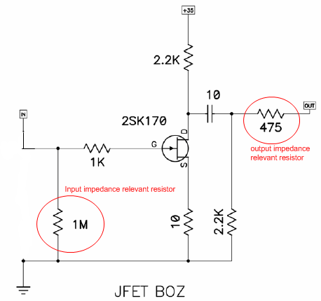

: what are input impedance (1 meg?) and output impedance of JFET BOZ?

Tolu said:Sorry, if repeating: what are input impedance (1 meg?) and output impedance of JFET BOZ?...
Input impedance is dominantly determined by the value of the resistor that connects JFET's gate and ground, but with this type of circuit (common source amplifier) the JFET's input capacitance is not negligible (it makes an LP filter with input resistance). I would keep that resistor at 100k max.
Output impedance roughly equals the Drain resistor's value.

In the original schematic input impedance would than be 1,001 meg Ohm.
The drain resistor you meant, is it the 475 Ohm one?
Usually the relatively low output impedance of whatever is driving the
Gate dominates the high frequency rolloff, so feel free to try whatever
input resistor you want.

Relatively low output impedance of, let's say, grounded cathode amplifier that can often be found in many DACs' output stages, or maybe relatively low output impedance of passive I/V convertors used as an output stage of many DIY NOS DACs ?
But, actually, you are right, he should be free to try everything, that's the best learning method - though expensive sometimes 😀

Was this correct what I assumed? 475 for output and 1 meg for input?
I just ask because of the need of relatively high input impedance (>25k) and relatively low output impedance (< 700 ohm).

Drain resistor is 2.2k and 475 is a short circuit protection resistor. Added together they approximately represent the output impedance of this circuit. 10 uF output capacitor contributes a bit, but it is negligible in audio band for loads higher than 10k.
If you want lower output impedance use B1 on JFET BOZ's output.

2.2 plus 0.475 gives 2.7 kOhm output impedance? Way too much for my Lightspeed! Than I have to put the Lightspeed at that position where in the original schematic the 25k pot is and drive the Lightspeed with 50kOhm input impedance.

Tolu said:2.2 plus 0.475 gives 2.7 kOhm output impedance? Way too much for my Lightspeed! Than I have to put the Lightspeed at that position where in the original schematic the 25k pot is and drive the Lightspeed with 50kOhm input impedance.
That particular circuit has two 2.2K resistors at the output, one to
ground and the other to rail, so that they parallel (for AC) to form
1.1K. Add that to your 475 and you get approximately 1.6K.

what happens when I reduce the value of the 2.2k resistors to e.g. 1.5k and the 475 to 220 ohm? Sorry, but I have no scope or simulator!
I believe that the voltage gain will be reduced.
R of 475 ohms is there to prevent potential oscillation . . . I think.
