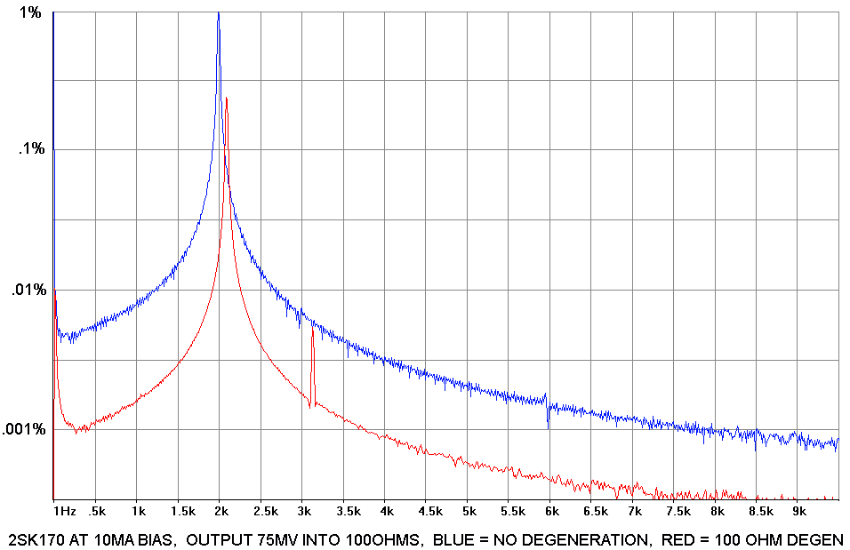

There are simply limits as to what a part will do. You can reduce
the current variation by raising the load resistance for a given
output voltage, but your output impedance will go up proportionally.
Also, you will have to cascode the part to reduce distortion associated
with gain variations due to the AC component of Vds.
Here is a typical spectral curve:

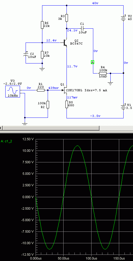

This cascode circuit shows THD of .105% for 1.24Vrms in,
about 11.48dB gain. Does that THD sound right?
Is .1% considered still too high?
I will try this circuit with my proto once I order some of those
BC547C's.

Bengali said:This cascode circuit shows THD of .105% for 1.24Vrms in,
That would be 5 volts rms out at .1%, and the original BOZ
was .2% at 5 volts. I would call that an improvement.

That would be 5 volts rms out at .1%, and the original BOZ. and the original BOZ was .2% at 5 volts. I would call that an improvement.
I was not clear. I meant the circuit I was working on that had .3% THD. yes, definately much better.
