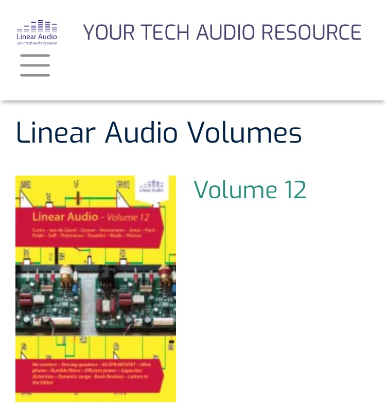

You know very well that Jan Didden has the sole right to disclose.will you disclose the details of your equalizer here in the forum?
So why don’t you ask him.
Hans
So youYou know very well that Jan Didden has the sole right to disclose.
- sold the disclosure of your dimensioning, component selection and topology to Mr. Didden.
- have no rights to your own circuit,
Volume 12
Just under 25 dollars is too much for the secret.
Since Mr. Didden and I are absolutely not friends, I will not ask him to reveal the secret.
What do you do with the production files and the BOM without any knowledge of the schematic? Reverse engineering?
