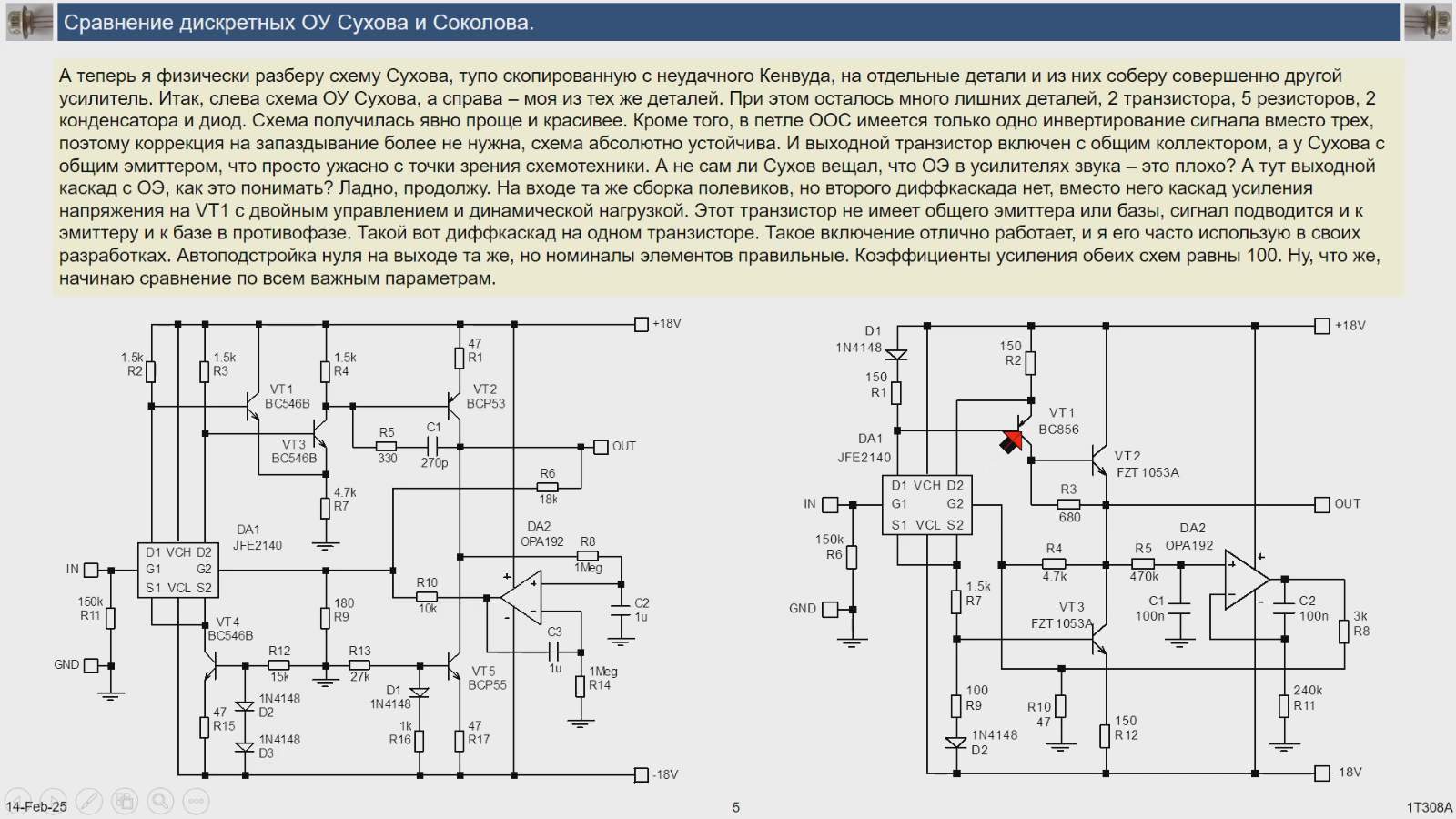

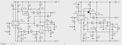

This shouldn't really be here, but in the brevity the network on the right looks nicely simplistic in the comparison (though the -ve PSRR looks could be more problematic). It is nicely integrated though there isn't enough there of a novelty to want to convert the text. What isn't clear is what you are really trying to convey by displaying these two images.
I can read circuits like my mother tongue.
I want to write to you personally (without public view) - there is an idea and several variants of realization
criticism of an experienced specialist is a very valuable opportunity
you are wellcome,I want to write to you personally (without public view) - there is an idea and several variants of realization
PM is still possible ...

@Hierfi and @Svytoslav
It is best for one of you to open a new path /thread for discussion and debate. A direct circuit comparison of the cores is interesting.
The RIAA network must be included in the final discussion later.
I am already looking forward to an open and friendly exchange.
HBt.
HBt.

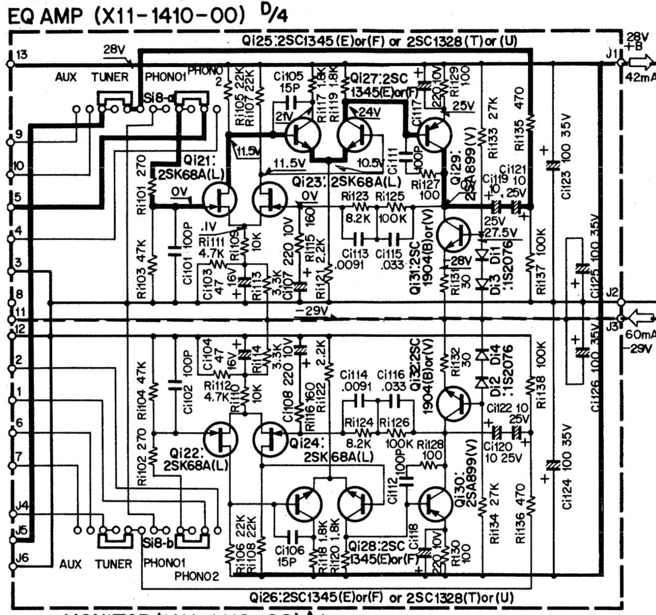

How is your scheme fundamentally different from this ancient Kenwood ka-9100-9150 ?
OK, - if I have a circuit [ freely here https://www.diyaudio.com/community/...ono-stage-85-dba-sn-ratio.387375/post-7662350 ] of universal MM\MC phonopreamp consisting of two modern field-effect and 5 bipolar transistors without transfo and electrolytics
