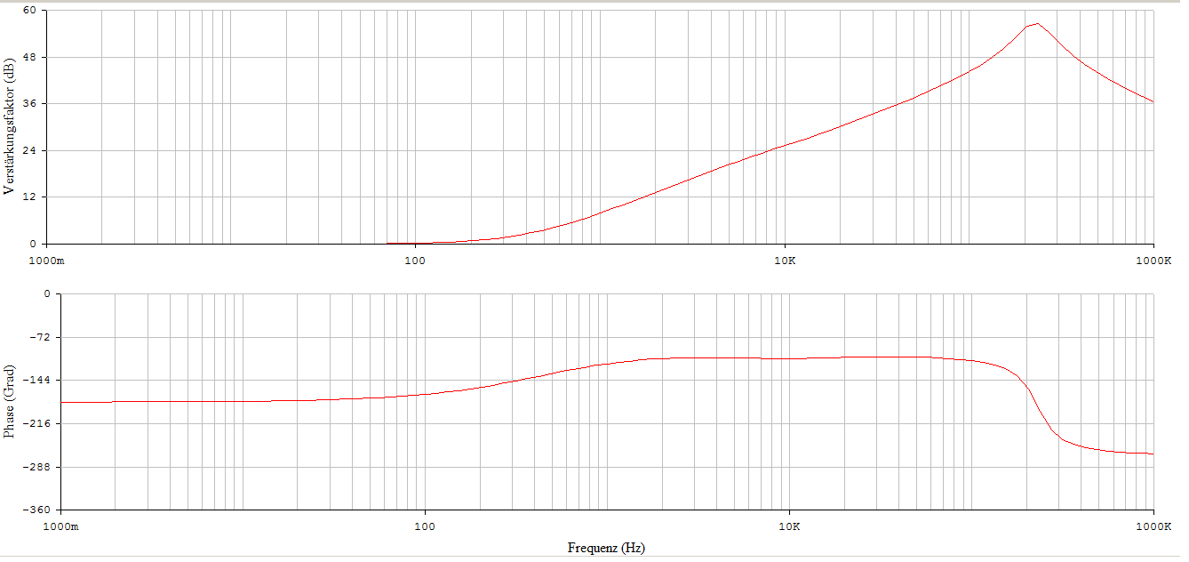

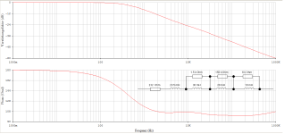

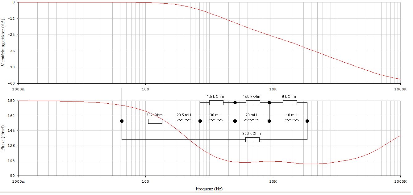

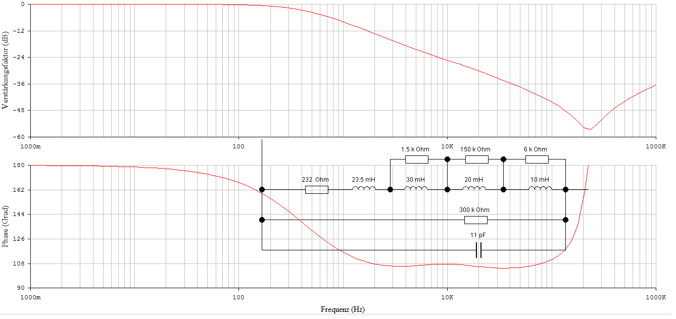

Most likely you created these plots by simulation while using a simple Cart model composed of just Lcart and Rcart.with my AT420E/OCC MM system ... the rest is self-explanatory!
Result with an RC termination is a downgoing -20dB/dec slope at HF.
But a Generator is much more complex than just an L and an R.
And on top of that there is also the cantilevers resonance that in combination with the Generator results in a -40dB/dec downgoing slope
And what you show, -3dB at 100Khz, is technically impossible for several reasons.
Sorry and with all respect, but it is exactly this sort of gross simplification that leads to very wrong conclusions.

I know that - because this is exactly the point of modeling. I'm completely on your side ...
this presentation was a bit mean, sorry. But I already said to Marcel at the end of 2023 that our models are all wrong, or not correct. Let's see what Bob Cordell will contribute to this topic after his long vacation?

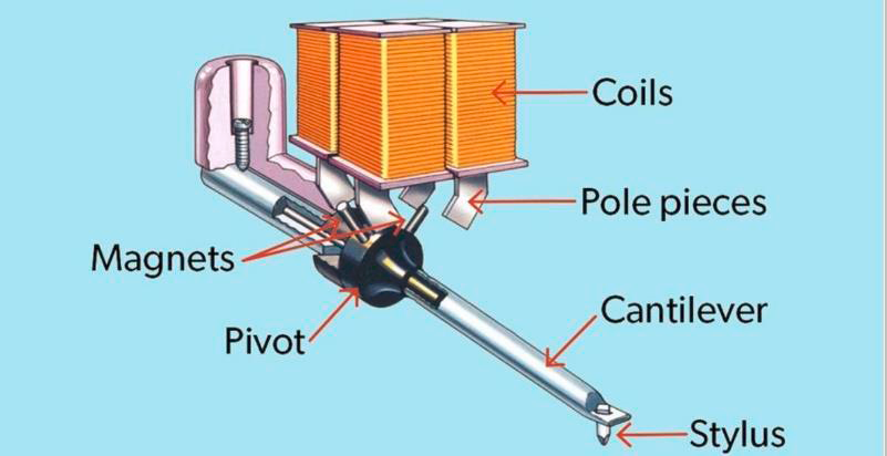

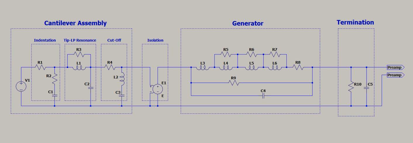

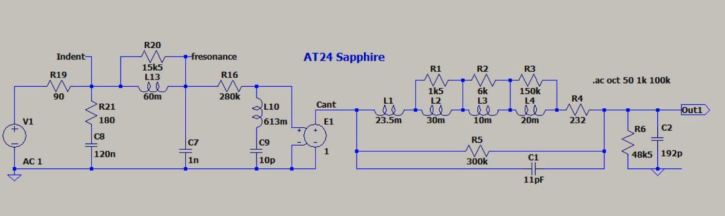

In a joined effort, Bill, Dagfinn and I went into much detail by developing replacement diagrams for MM cartridges, divided into two parts, first the output section with coil, that we called the Generator, and second for the complete Cantilever assembly.
An achievement never realized before to the best of our knowledge.
Having developed the transfer functions for both both parts, we were able to prove that these two parts don't "see" each other, in other words, the external load on the Generator does not influence the Cantilever's movement in any way.

someone sees even more https://www.patreon.com/posts/93731535We see a mechanical and an electrical part ..!

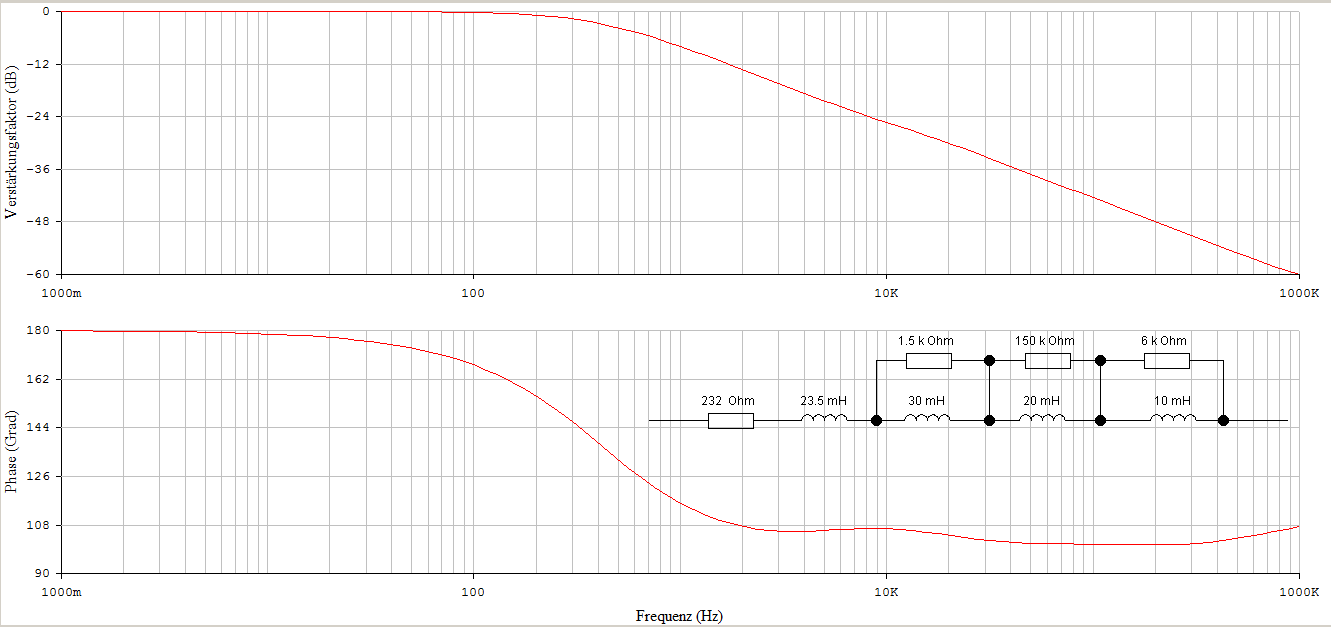

Hans model of the mechanically moving part shows that there must be an upper mechanical limit reflected on the electrical side. f_limit < 25kHz.
Well, that's a truism and the pickup manufacturers usually specify this limit as well. In my above example of the AT420E, AT says 25kHz is the upper limit. And exactly in this range the termination with 47kOhm || 150pF is exactly correct, i.e. if you look at the (let's say incorrectly "Bode") Bode diagram between 10kHz and 30kHz, everything is totally correct quantitatively. Multiplication with the mechanical transfer function is now welcome.
Posting #43 illustrates exactly what it is supposed to illustrate.

Absolutely correct,And what you show, -3dB at 100Khz, is technically impossible for several reasons.
but even without the cantilever component I do not show a cut-off frequency at 100kHz.
34.75kHz (47kOhm)
vs.
77.1kHz (150kOhm)
So we are above the mechanically specified limit ... that's good. Of course, you won't suddenly get more AUDIO out of the back. And that's why it doesn't really matter whether Nick adds a zero at the end.

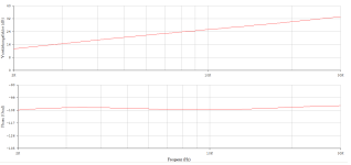

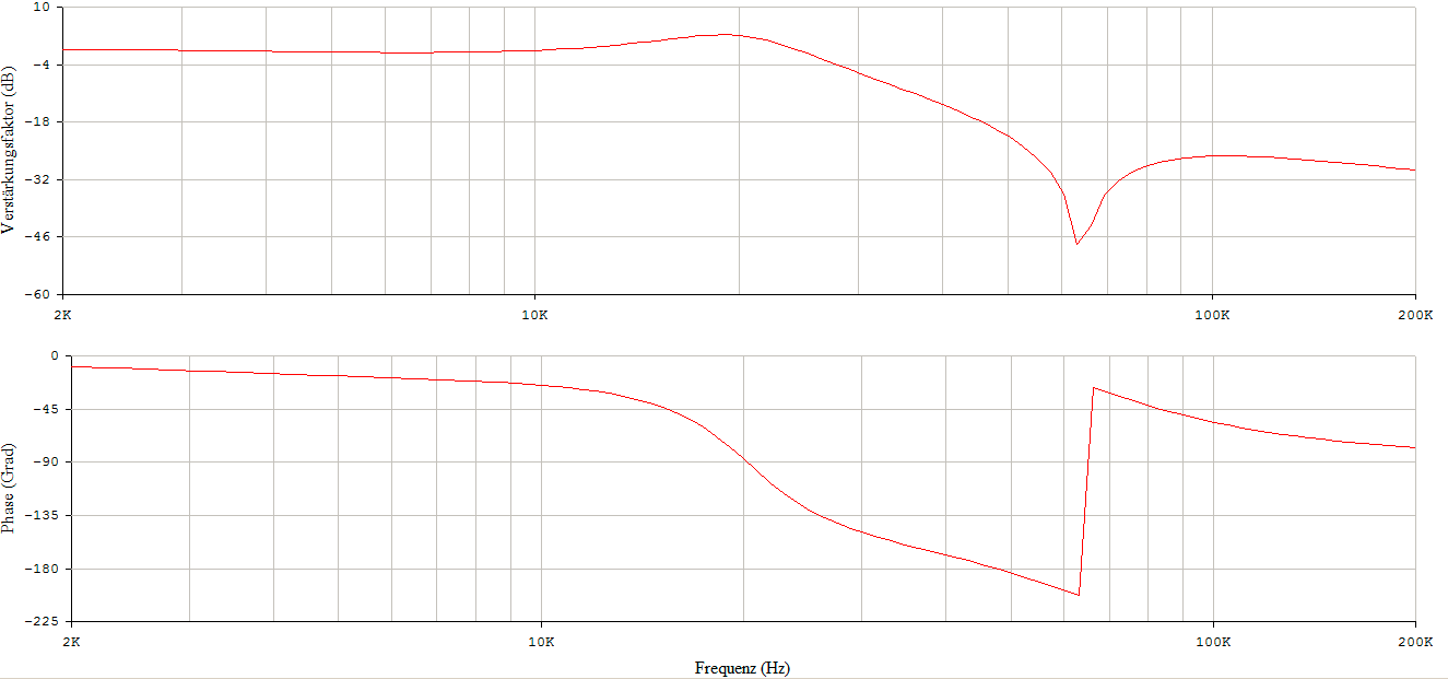

To identify the path ("die Strecke"), you must have recorded the output voltage of the tactile sensor (DUT). The specially made test record with pink noise was used for stimulation... right?
And what exactly did your measuring amplifier look like? For example, I ask about its complex input impedance. Was there an electrical load on the sensor?
You know what I'm getting at!

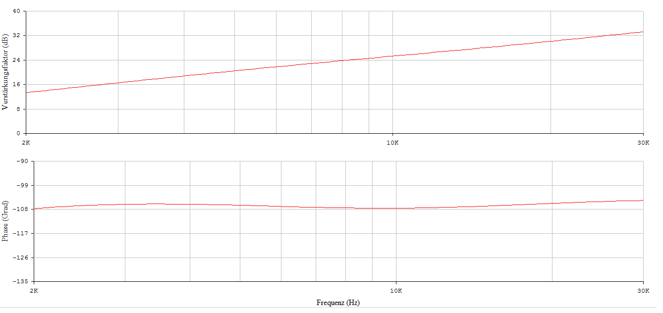

In the meantime, some questions have been answered via PM.
A linear sinusoidal sweep from 2kHz to 30kHz was used as the excitation signal for system identification: TEST-LP 33+1/3 rpm. This automatically means that the published impedance model is only valid within these limits; it shows an increase of a constant +17dB/decade. No more and no less.
The Rp & Cp-termination confirms nothing more than the Audio Technica manufacturer's recommendation.
There was no real measuring amplifier during data recording.
