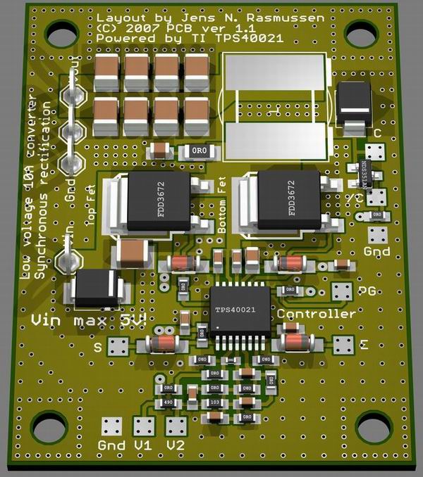

Jens what program do you use to create those realistic board layouts. Tad
The layout is done in Eagle (www.cadsoftusa.com) and i export to povray that does the rendering.... see this page: http://www.matwei.de/doku.php?id=en:eagle3d:eagle3d
