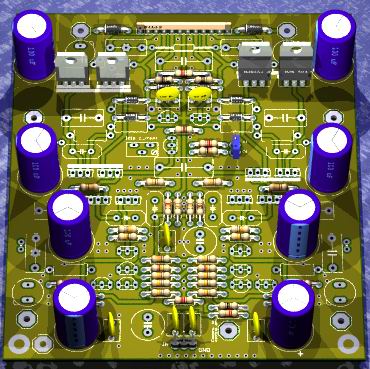

Hi Jens,
If you would rotate fuses f3, f4, f5 and f7 for 90° you could put VS and VS1 near c43. It would be easier to make jumper, and smaller mess with wires. Same for VC. In that case you need to put c15 a bit lower.
Well I do not know if some other traces are making this impossible. I like the layout as it is.

rolandong said:Hi Jens,
Would it be possible to use footprint with three holes (2 holes connected) for decoupling caps for option to use 5mm caps?

All electrolytics are 5 mm pitch on the front end board - do you refer the the film types?

Jens, your newest front end looks great. I am amazed at your ability to incorporate a diversity of input, and how you keep working up improvements for an already solid design.

Jens, Do you feel confident enough about this that we can send the gerbers to the board manufacturers. I for one would really like to begin implementing this into an amplifier design with separate regulated frontend supply. I have never been able to listen to such an amp and would like to hear it.
Will this work with the current 10 transistor output or will it have to be a cascode -- series -- design. It looks very neat and well though out. Thanks Tad
Super front end with regular 10 transistor output stage or with cascade output stage?

Referring to the scheatic Jens just posted, the simplest front end regulation scheme would be to connect a regulated supply at ~output rail voltage to VC2/VS2. Then the whole front end would be regulated at the same voltage.
Along the way someone suggested that regulating each stage separately yielded a sonic improvement. You could omit JP2 an JP4 and have separate regulated supplies for the drivers and VAS/differential (using the jumpers as connections) or also remove JP1 and JP 3 and have separate supplies for each stage.
The differential could use a lower voltage than the output rails, which would allow the use of lower voltage rated, higher hfe devices like the BC546C/556C that I have so many of. For bipolar outputs, you want the front end to clip before the outputs so they should have approximately the same rail voltage.
Of course you could regulate the output stage, too, which some say has sonic benefits as well. PSU 2.2 coud not provide enough current, but could drive a bank of higher power devices with a little creativity.
Hope this helps, I don't have a good way to get you a drawing.

Jens what program do you use to create those realistic board layouts. Tad

Hello Tad,
yes, if you have the super leach amp board front-end you can still do a lo-tim leach amp.....just don't stuff the parts in for super leach and jumper wires here and there, i know this can raise eyebrows, but i have actually seen this done with the original super leach board...it doesn't take a genius to figure this out...
Tad -
To convert the cascode output to a standard one, mentally remove/jumper the transistors closest to the rails and the resistors associated (R46A, etc.) to create a standard output stage. You'd connect a standard output stage's bases to J1J5 and J1J8, Feedback to J1J6 or J1J7 and protection to J1J4 and J1J9.
Hi Jens,
Would it be possible to provide an option to use 5mm film caps by providing extra pad in the middle (C47, C39, C33, C41, C43, C26, C43, C2, C15), so that other film caps can be used ex.Vishay Roederstein MKP1837, Epcos, etc.
