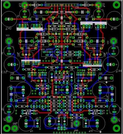

Hi All,
I understand what has been said here and I conclude that people want a front end that allows both the original and super amp option.
This is ok, but what kind of powerstage should I go for? Most likely both the original type and Super amp type will be needed at some point.
Maybe the Super amp redesign and this GB can use the same boards?
Here is a schematic with what I have in mind - comments please
\\\Jens

Jens,
Could you place jumpers in each rail between the differential and VAS and driver/VAS so that nuts like Jacco and me could separately regulate each stage?
If it could be laid out with a pad for a power connection and we'd have to cut a trace if we wanted to separate the stages would cut down on problems for those not as interested in experiments.
Thanks.
Jens. What you have in mind is exactly what I was thinking of when making post #377. I like this version you have posted. Let's use this as the baseline design for the front end. Everything I have read about cascode output stages indicates that they are not very good sounding compared with standard output configurations. My first-hand listening experience confirms this. Nelson Pass, who has designed many amplifiers using cascode output stages, no longer favours them. Given the high voltage output transistors available now, there is really no reason to use a cascode output stage. What about using the front end design you just posted (super amp v5.01) and using a 10+ output stage as used in your previous design. Builders could actually configure their output stages with as many transistors as they wished to. ---HK

Front end getting there
Hi all,
Front end more or less done...
Comments please
