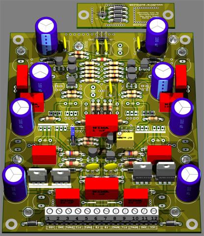

OK, Tony you missed me. I see the connections of which you speak and that if you cascode the VAS, you must also cascode the predriver as it sets the operating point of the VAS cascode.
Perhaps Professor Leach was referring to the predriver, driver and power stage collectively as the output stage (all three stages of the triple Darlington).
What Jens's circuit allows is connecting just a standard Low TIM style output stage to the cascoded predriver/driver stage. As in low TIM, you take the drive from either side of R51 (J1J5 and J1J8), feedback connects to J1J6//J1J7. Is there any reason that would not work?
Bob, no reason for that not to work......as i said, you can get rid of T12A and T22A and jumper their ce and you are go....😀

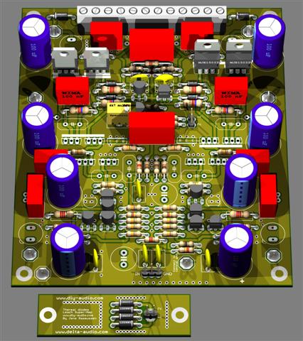

Jens, Where does the small diode pcb connect to this board. I believe this design is going to be quite popular. This layout with a separate frontend board opens up a lot of possibilites to the constructor in terms of output design. Are we getting closer to having some boards produced? You have to be just a little bit anxious to build one yourself by now. Nice picture again.
