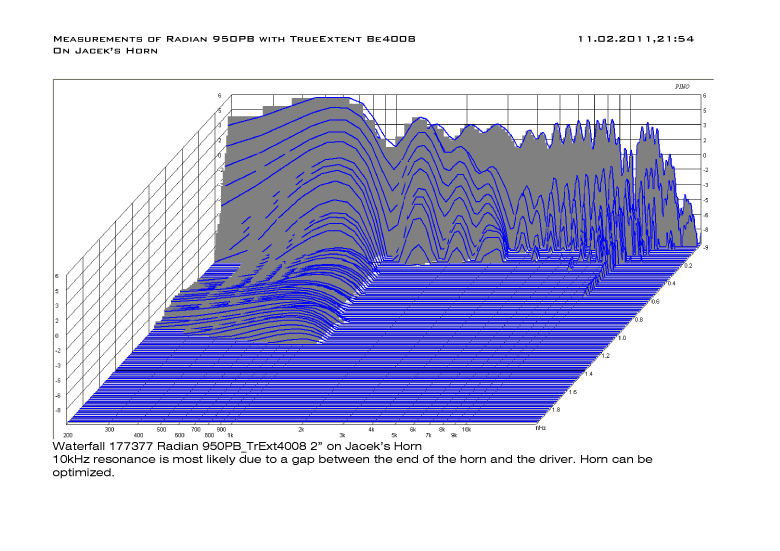

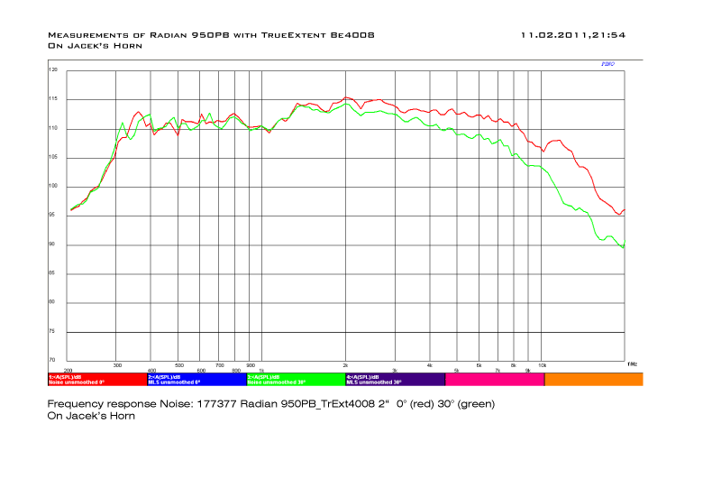

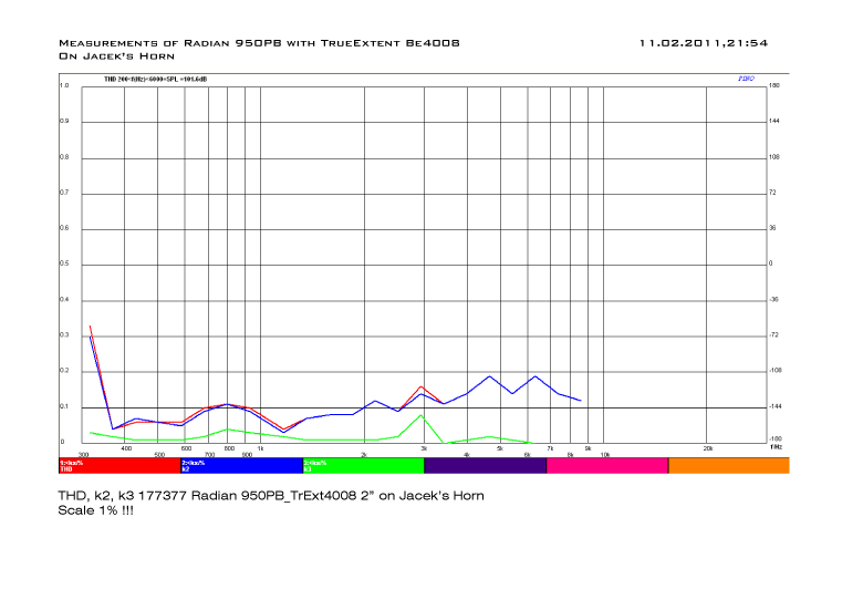

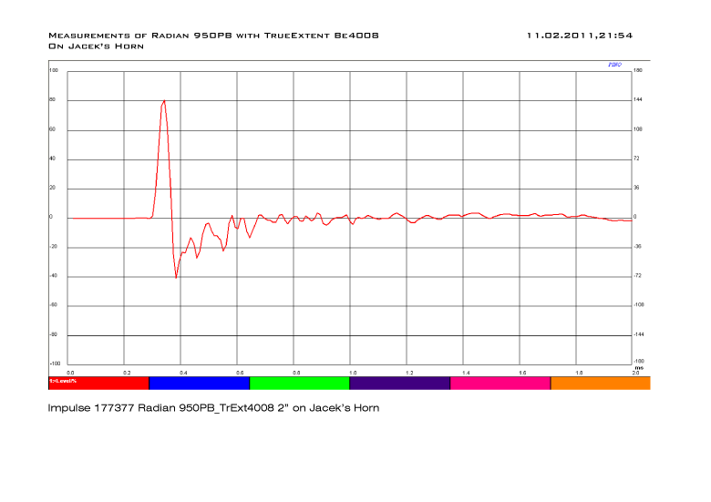

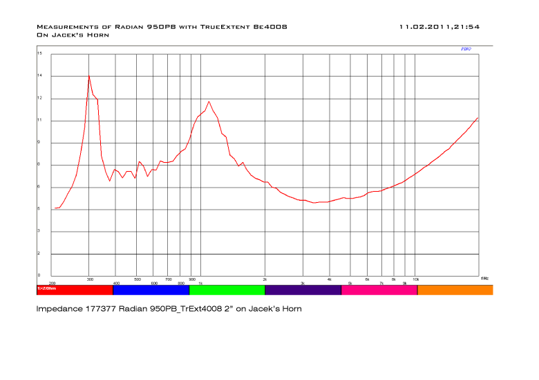

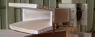

Not yet - need quality 2" driver.
Below JMLC-350 with Radian 950PB and Truextent diaphragm.
