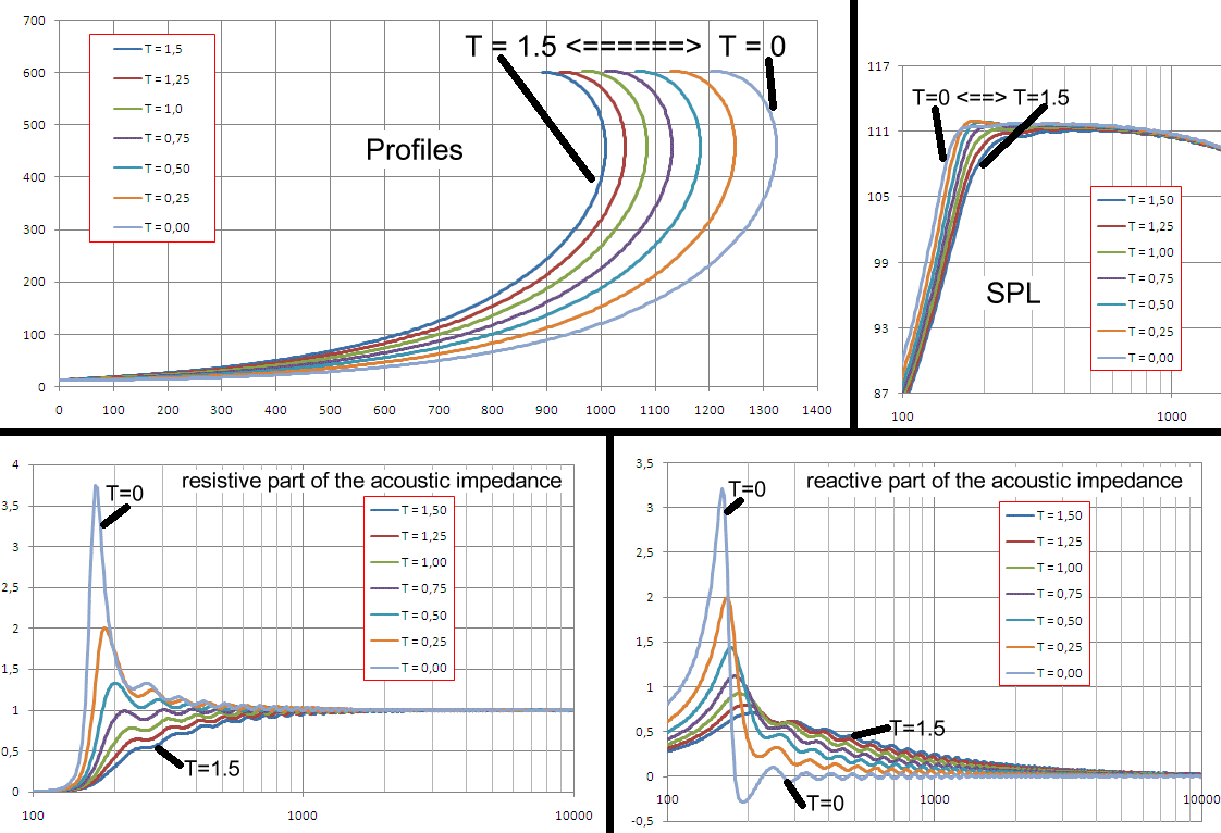

Jean-Michel, would you please explain or point me where I can read more about the T value and how the T value alters the horn (i know it alter the length, thats all).
If a t value of 0, (slightly longer horn) is suited to a particular range of horn etc woud be useful to learn.
Hello 3GGG,
T is a parameter in the formula giving the area versus the distance to throat of the large family called "hyperbolic horns". For a given cut-off frequency the T parameter acts on the shape of the horn and its length while the mouth area will keep the same.
For T = 1 the horn is called exponential.
For T between 0.5 and 0.707 the horn is called hypex.
For T = 0 the horn is called catenoidal.
For large T value over 1 the horn acts more as a waveguide
For very large T value over 1 the horn tend to be conical.
A T value of 0 has some advantages for bass horns and low-mid bass horn. The cut-off frequency becomes smaller (You can gain half an octave or so), but more interesting IMHO is the fact that above the cut-off frequency the reactance (the reactive part of the acoustic impedance) is nearly 0, so the phase distortion (in fact: the group delay distortion) becomes very low. (but better to use an electronic crossover having a very high slope... to benefit of that)
You can see on the attached graph the effect of the variation of the T parameter on a Le Cléac'h horn (Fc = 160Hz).

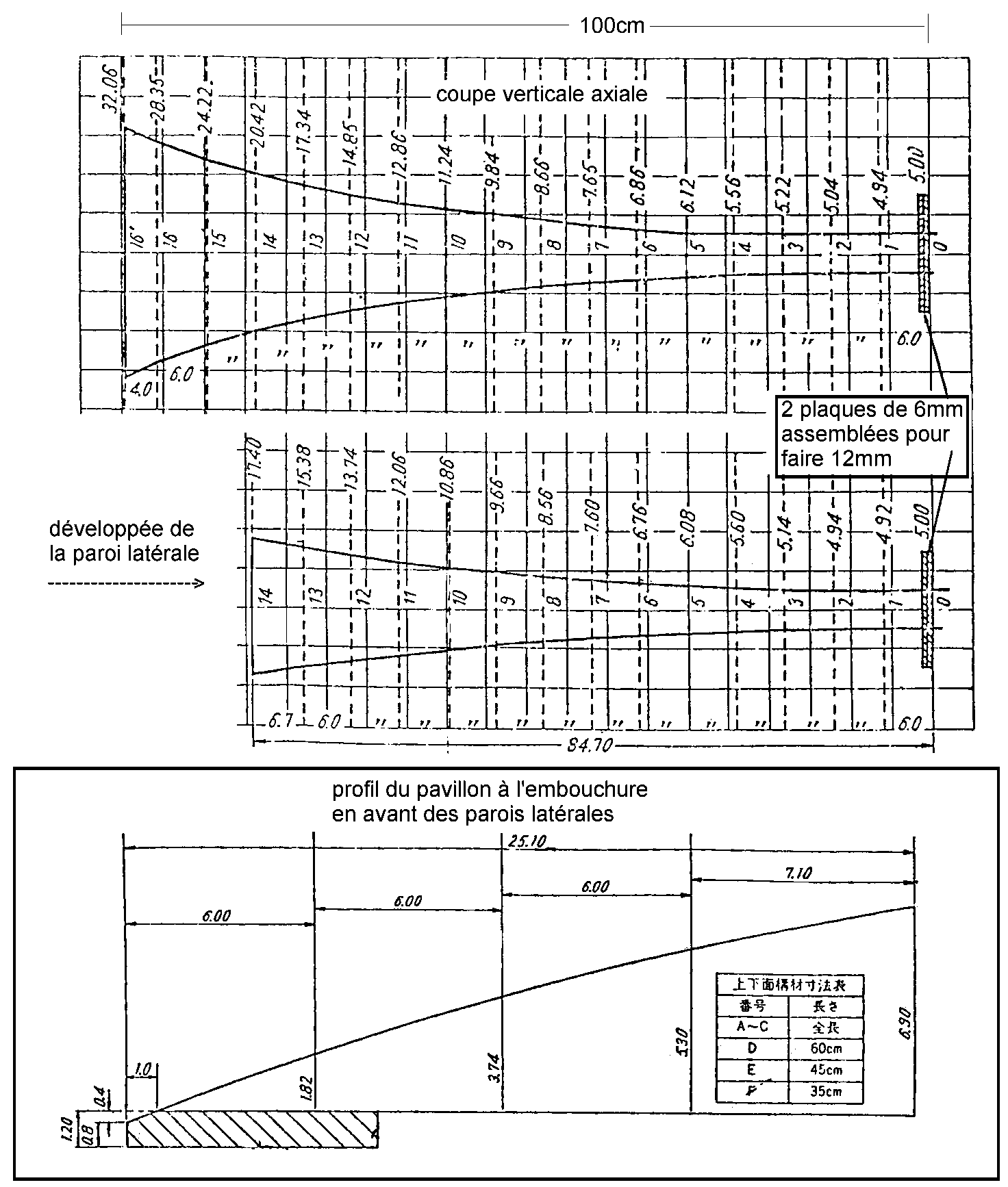

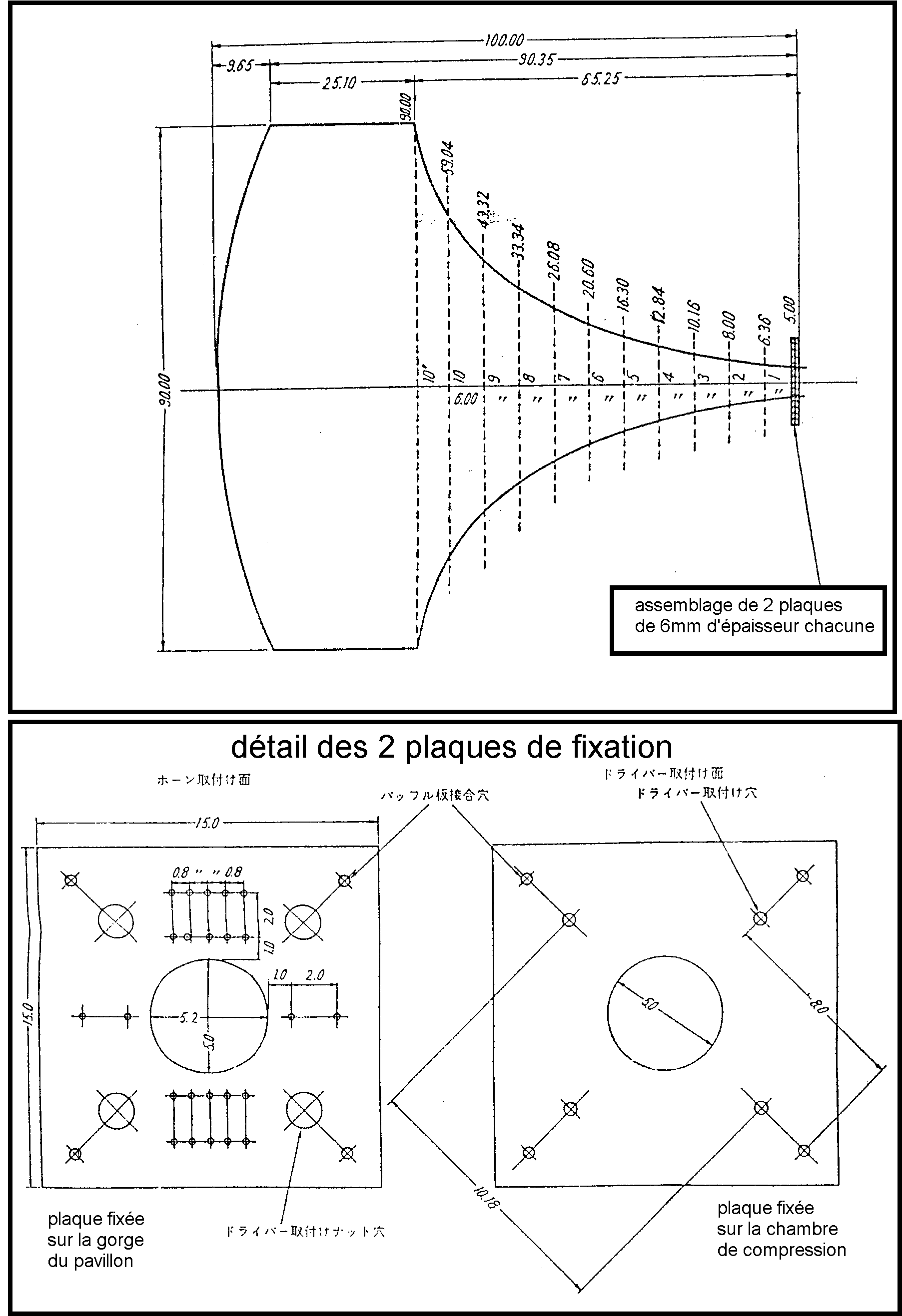

Hello Jean Michel,
could you please explain how to build a Guigue's horn. It's quite based on IWATA's horn but flanges are shorter.
Thank you for your help.

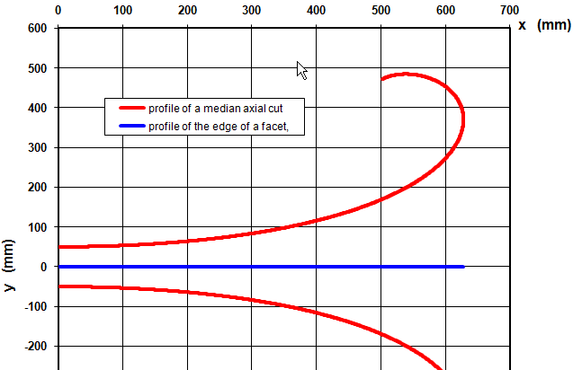

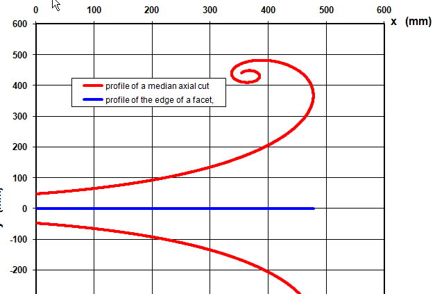

Jean-Michel can you help me understand why the flare terminates just past 270 degrees whenthe T value = 0.
How should this part of the horn be finished in a build?

Hello,
Guigue used to start form the shematics of a low-mid Iwata horn published in the japanese magazine MJ.
To provide a WAS ("wife accepted size") this low mid horn was truncated
laterally.
I guess Guigue used some scaling of the original low-mid Iwata horn in order to design the horns he commercialized.
See the attached plans.

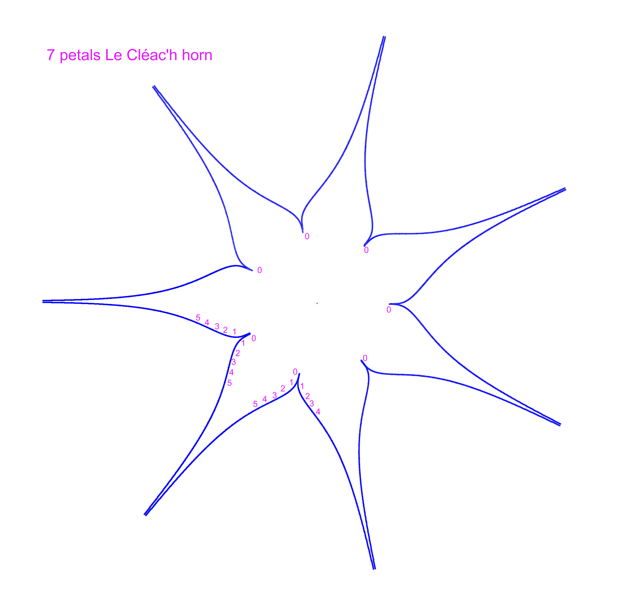

Hello 3gg,

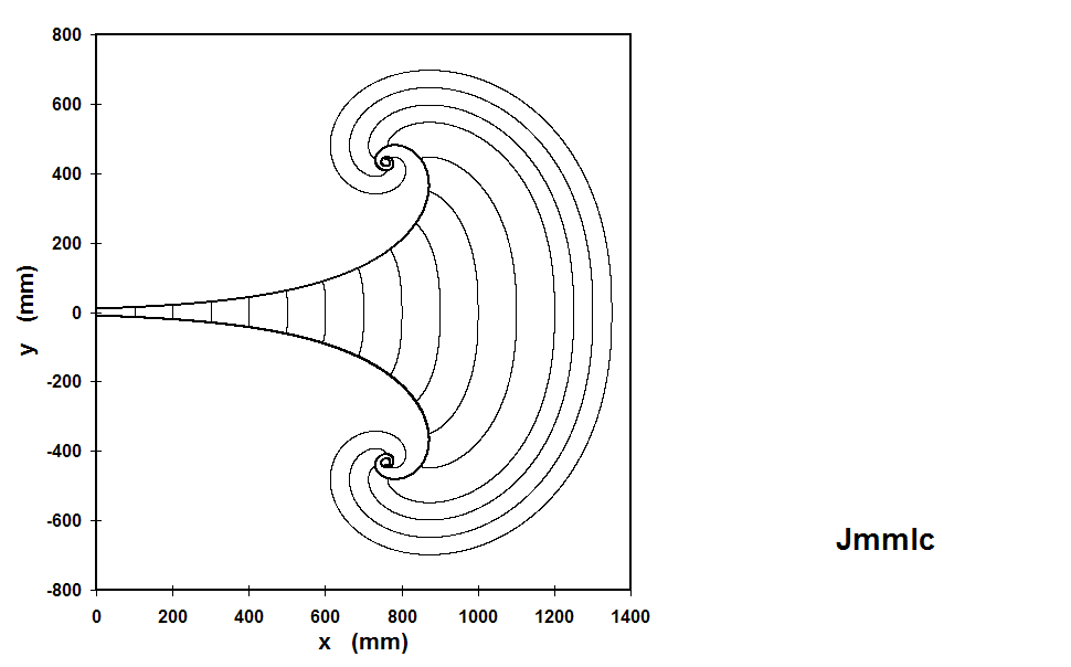

For a gramophone style horn (petals horn). You have to begin to glue edge to edge the petals from the mouth end, then progressively engluing whil curving the petals step by step until the trhoat....
Give a look to the attached schematics.
You'll see also a drawing showing how the wavefronts are propagating from throat to mouth which explains why, in order to maintain the chosen expansion law for the area of the wavefront versus distance to throat, the mouth has to curves back.
Best regards from Paris, France
Jean-Michel Le Cléac'h

Sorry JMMLC, I am building (axixsymmetrical?)l 200hz T=0 horn, made with many, many rings of MDF then turned in a lathe.
I plotted the points on a sheets of thin MDF and the final bit of the curve is all I am missing.
Hello 3GGG,
You can eventually replace the case [D9] by 0,264.
(But don't save the spreadsheet with that modification which is only OK for that peculiar set of input datas)
Here attached the obtained profile.

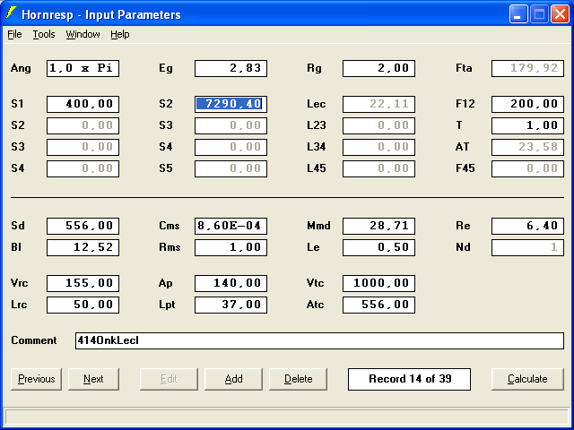

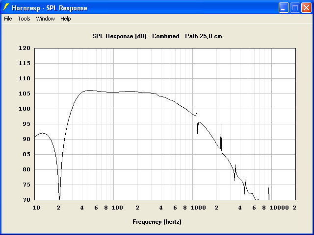

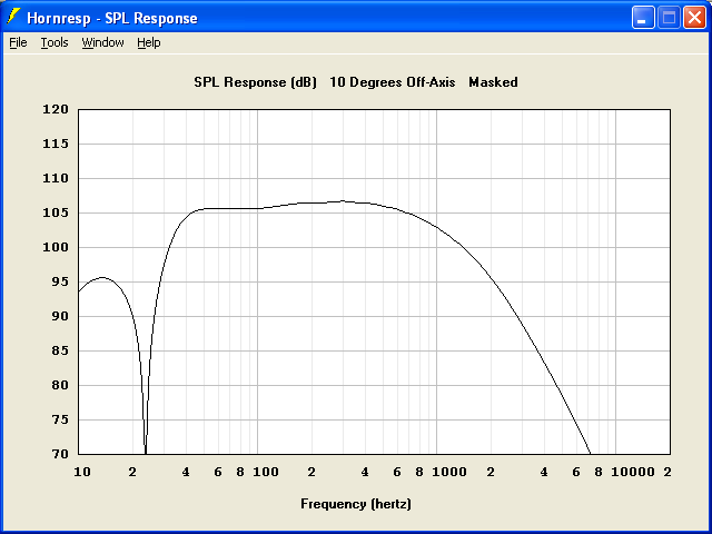

Hello Jean-Michel,
I have been playing around with "hornreflex" and am almost ready with my midbass prototypes with 40dm3 boxes. Here 90 degree JMLC T=1,0 or KW seems to be best. But they are close to the same I guess.
Also did a Hornresp sim with "Le Petite Onken"/Altec414-8A in combination with a 200Hz JMLC. Had to adjust BR area to 1/4th of the original.
The problem is that the frequency-response sims look to good to be true🙂. Any comments on that?
