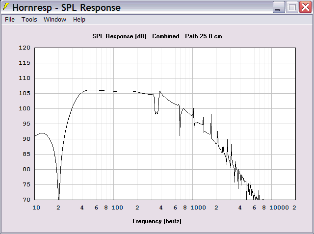

Wonder why I get a bit different combined response? :scratch:
HR v2840.110427:
GM

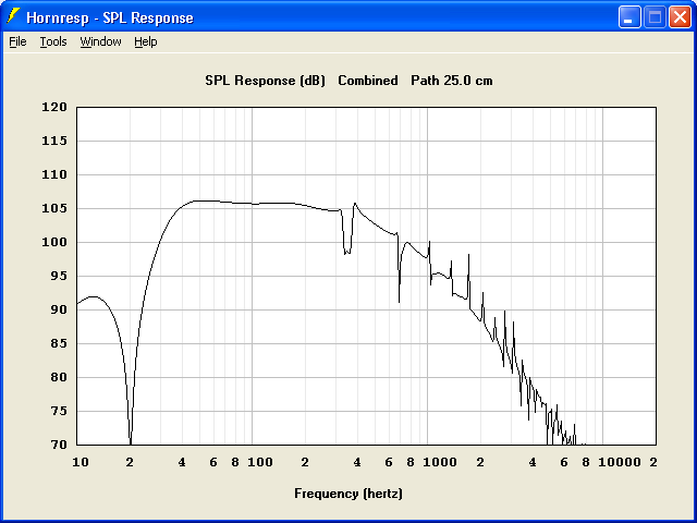

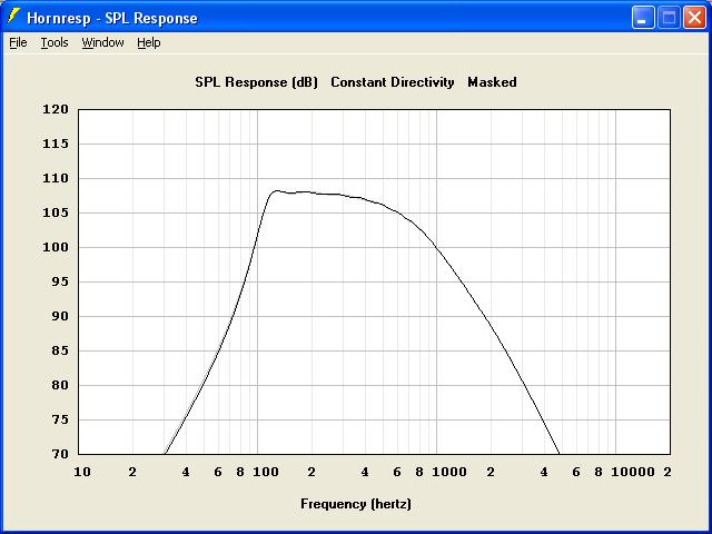

Don't know, can it be done in AkAbak?

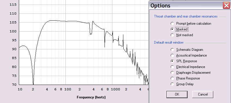

OK, so in my haste, what am I missing this time around? All my sims that apply are 'masked' AFAIK.
GM
Hi GM,
The Hornresp combined response is always calculated 'unmasked', even though the user may have the 'masked' option selected. You can check this for yourself by comparing the combined response with the 'masked' option selected against the combined response with the 'unmasked' option selected. The results will be the same. This is why the masking option is not shown on the combined response chart - it could be confusing.
Incidentally, I get the same combined response result as you do 🙂.
Kind regards,
David

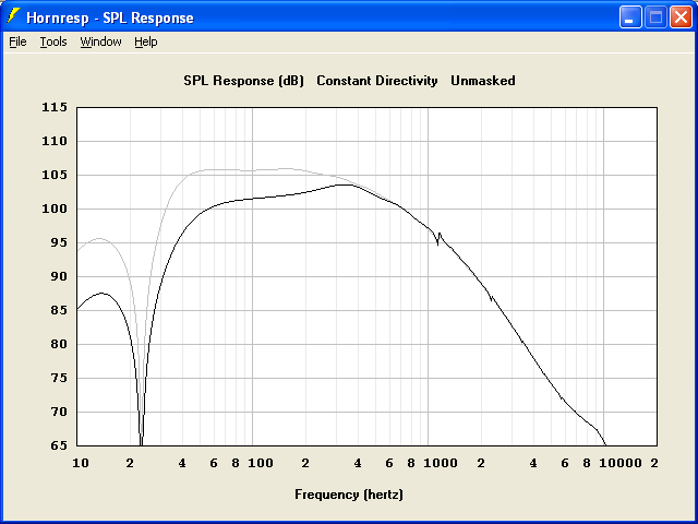

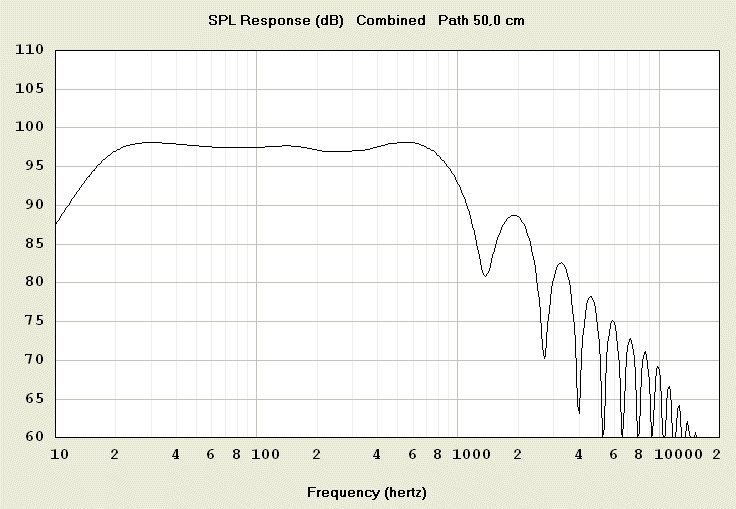

Hello Revintage,
Eventually, just for the fun, you can try the driver + attached horn unbaffled in a corner.
You'll have to use a 8 to 10 series resistor.
Hornresp record and screen copy here attached (pathlength = 50cm for combined response).
Best regards from Paris, France
Jean-Michel Le Cléac'h

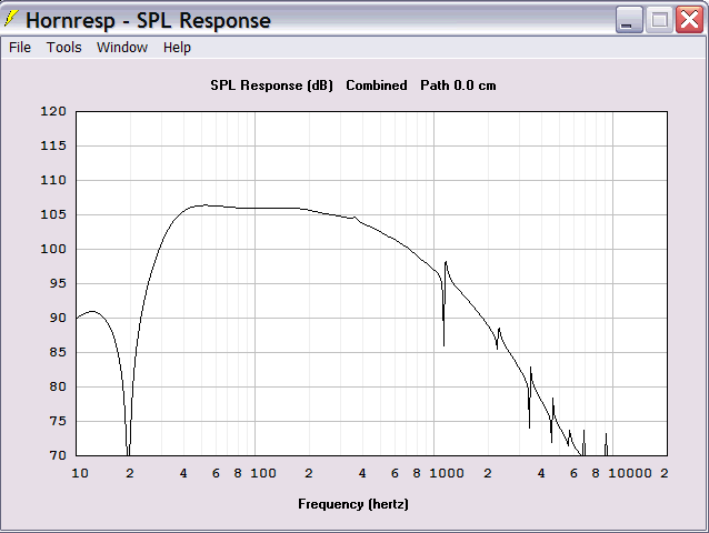

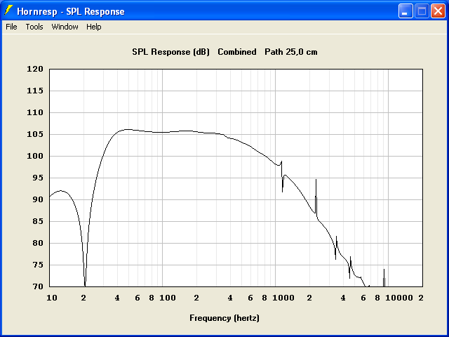

  • Altec 414-8A FLH Onken combined response - 15 cm Lrc [revintage - Lars].gif

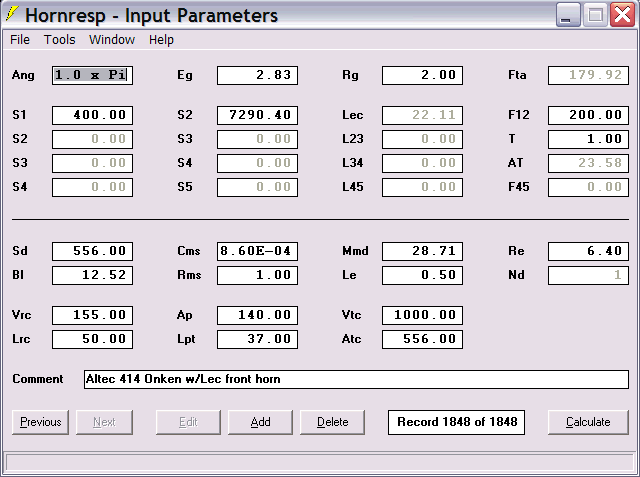

GM, you ran it unmasked after all.
Changing Lrc to 15cm makes everything look good again. But how do we arrange this in a box 50cm deep?
OK, how are you running it masked then? I mean I can't seem to get your smoothness combined with a 20 Hz dip using your posted parameters.
The cab is existing? If so, then seems like the horn has to either mount on the rear to allow a recessed blank baffle/rear cover the way HR sims it or the horn has to fit a recessed baffle from the front with any surrounding airspace filled with a suitably massive material. FWIW, I use kitty litter/oil dry as an acceptable mass/damping/weight trade-off to the more commonly used sterilized sand, Portland cement.

Hi GM,
I must have missed/forgotten this in the HELP files.
You didn't miss or forget anything - it's not documented in the Hornresp Help file 🙂. I didn't think it needed including because there is nothing that the user can do about it anyway...
Still, I can't quite duplicate this combined plot from his input parameters or even with the shortened 15 cm Lrc.
Me neither - I get the same result as you. The SPL responses posted by Lars must have been generated using values slightly different to those shown on his original Input Parameters window screenprint (changing Lrc to 15 cm is obviously only part of the story).
Kind regards,
David
