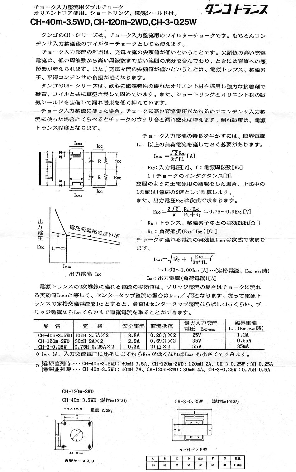

This thread is about to die it seems. A vietnamese friend for whom i brought a pair of LL2733 for choke input a future Nelson Pass amp found a pair of secondhand Tango high current chokes. Because of these having lower mH he will use them as a second choke in a LCLC supply.
Tango can be used as choke input too. See the attachment. You can also see they write a\bout the minimum current needed to make it work as a choke input.

Hello,
I cannot read Japanese but it does contain some information. Maybe the non native English speakers are more eager to give other languages a try?
It is surely Japanese. Vietnamese has an alphabet with some letters similar to ours. Chinese looks like those tiny insects in the palm of history by Thomas Dolby.

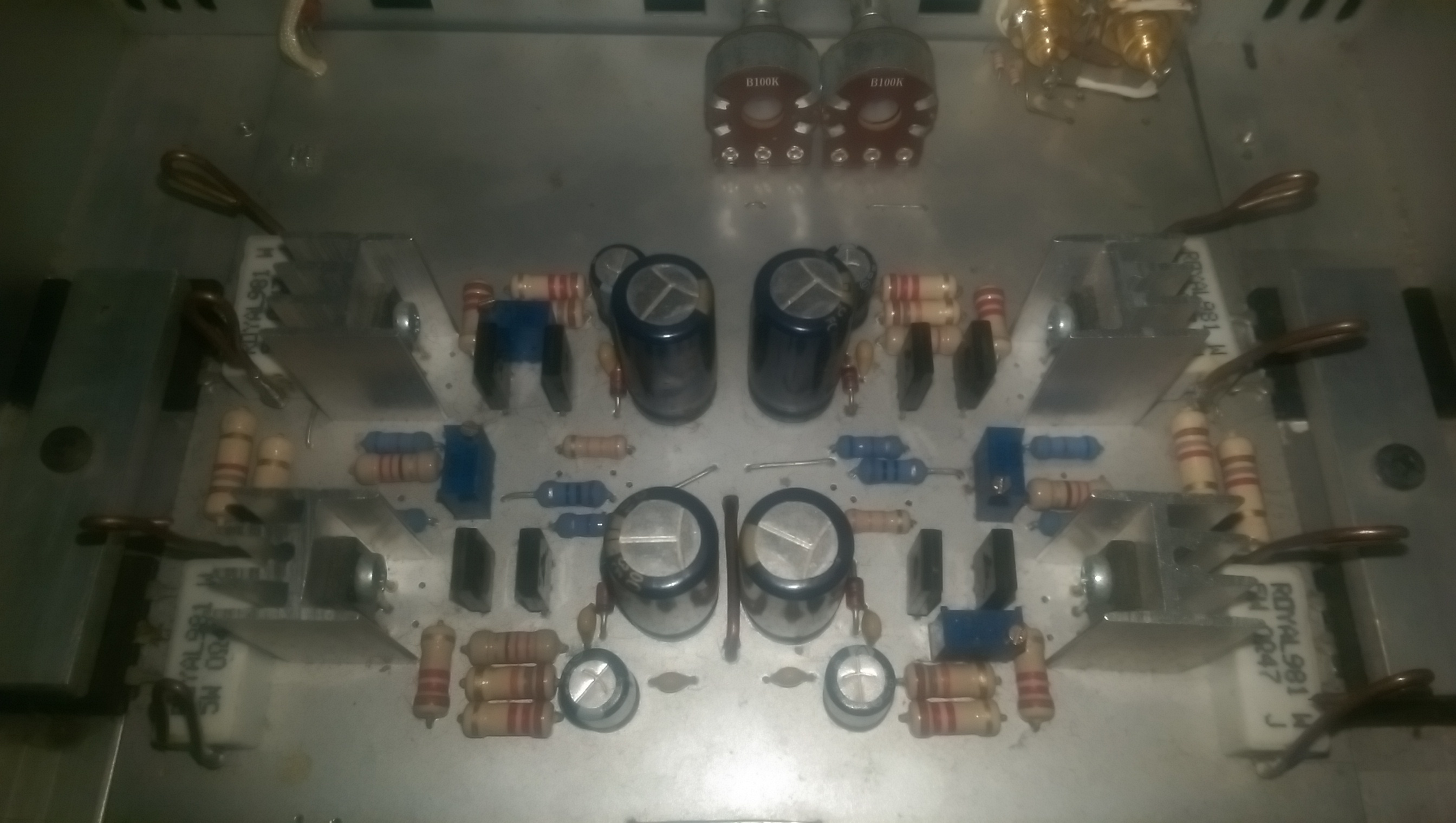

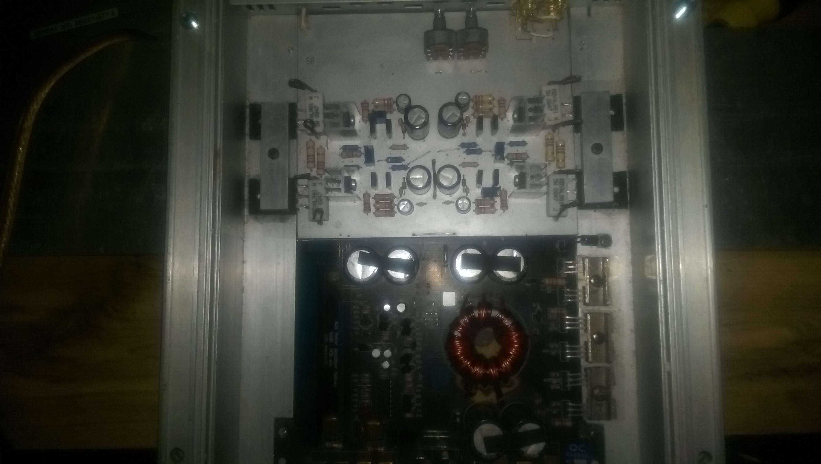

Can anyone help me identify if this amplifier is the Hiraga 30W or not? Its a DIY amplifier I purchased from ebay a few years ago.
I'm pretty sure it's not the lowest power Hiraga amp.
Also note in the pics the components are not the best so I'm wondering if anyone knows what can be done to upgrade this lovely sound machine ?
The power supply can be upgraded for sure to a mains supply, at the moment its running from a Car battery to SMPS, the sound is great but the bass is lacking bottom end.
Its sounding very good at the moment but I wonder what the capacitor and resistor do near the outputs ? the amp is mellow at the top end but perhaps a bit too mellow for me.
The capacitors and resistors look kind of generic ? I would upgrade them all but im not sure what schematic I should be going by, is this the 20w or 30w amp thats the question!
What I do know is the F5 by Nelson Pass when I heard it sounded better than this yet this has a nice mellow charm to it.

warning with the hiragas!
like naims, if you do not have the original transistors (NEC, toshiba, hitachi, Cosmos)(depending on the versions ) and the good supply that goes with it, it will sound, but not hiraga sound.
it's one of those amps that really needs a lot of attention (kaneda school ...)
