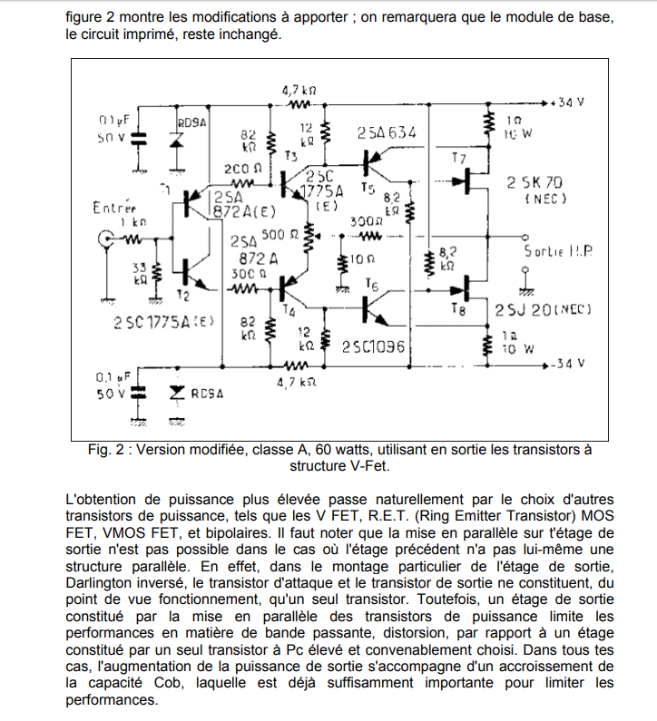

FET Hiraga amp
It is there in the original document...
Ha ha, I haven't a clue, hopefully someone will tell us......
