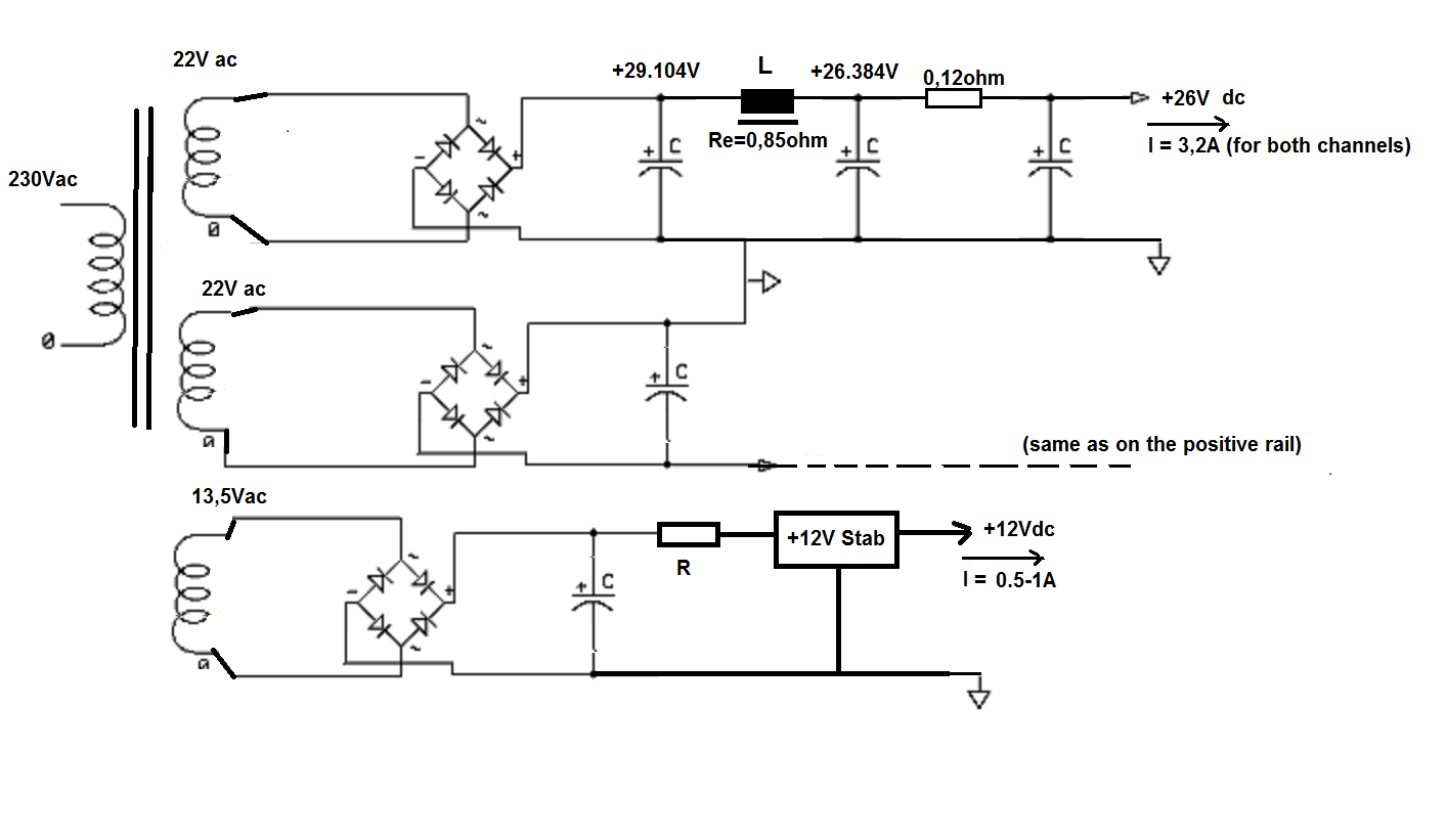

You don't need 12-22-26-30-0-30-26-22-12 voltage windings.
You need a low current (0,5-1A) 13,5Vac separate winding and two high current (8A) identical winding for 20-22-25Vac.

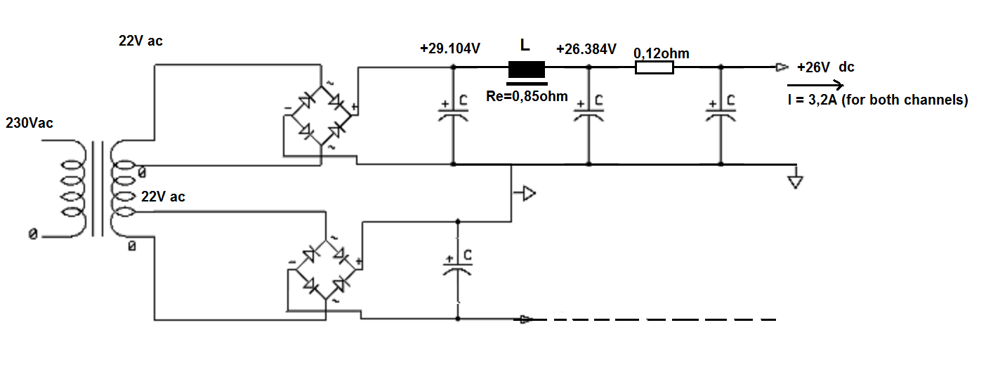

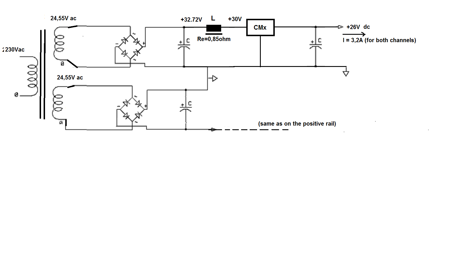

I will post 2 pictures for easy understanding the voltage droped on each element of the PS.
In both cases I assumed 2Vdc lost on rectifying diodes. If you use Schottky diodes you will probably lose only 1.1-1.2Vdc on them.

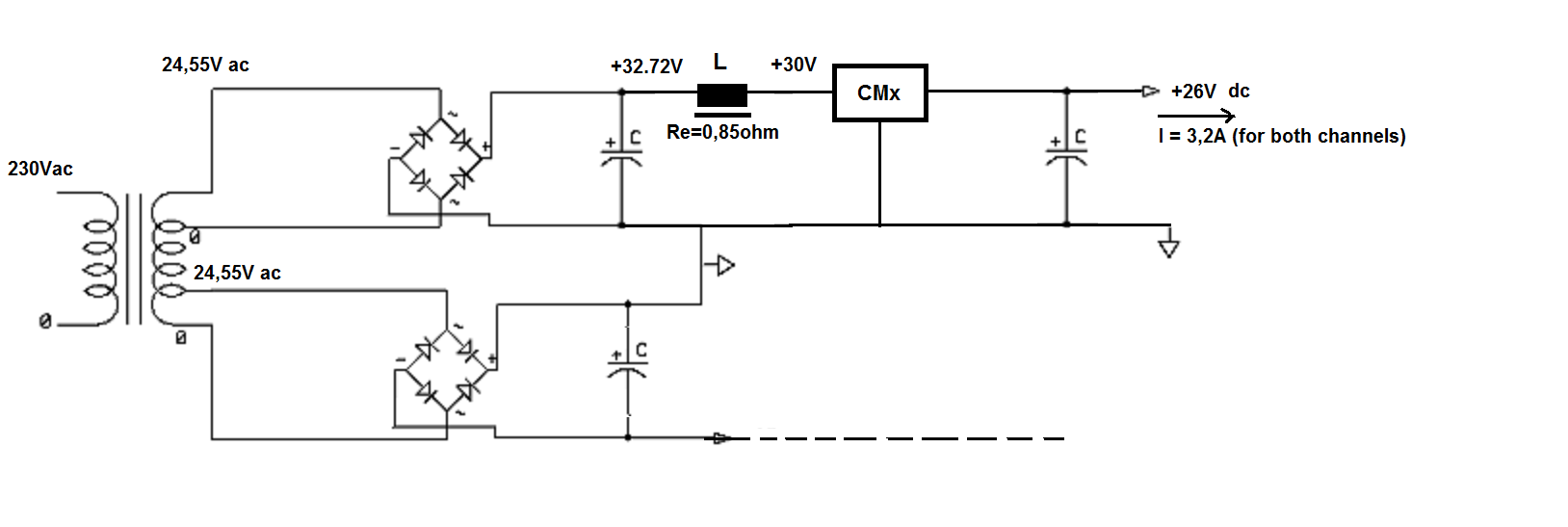

Do not copy the post223 schematics. Both are wrong !!!!!
Andrew, thank you for correction. I was concentrated on the dc voltage and overlook the transformer ambiguous draw (took the first draw at hand and modified it). I apologies for my inattention.
Now it is correct - and concord with the text I wrote.
