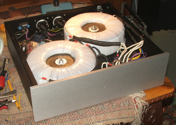

Pieter, I do live in Iasi and have a many years long cooperation with Petra Toroid, for special design trafos. Hope I was not a big pain in the *** of the technical manager; spent many hours calculating together some of those trafos.
In the pic can be seen two big special trafo from Petra, in a passive power conditioner.
