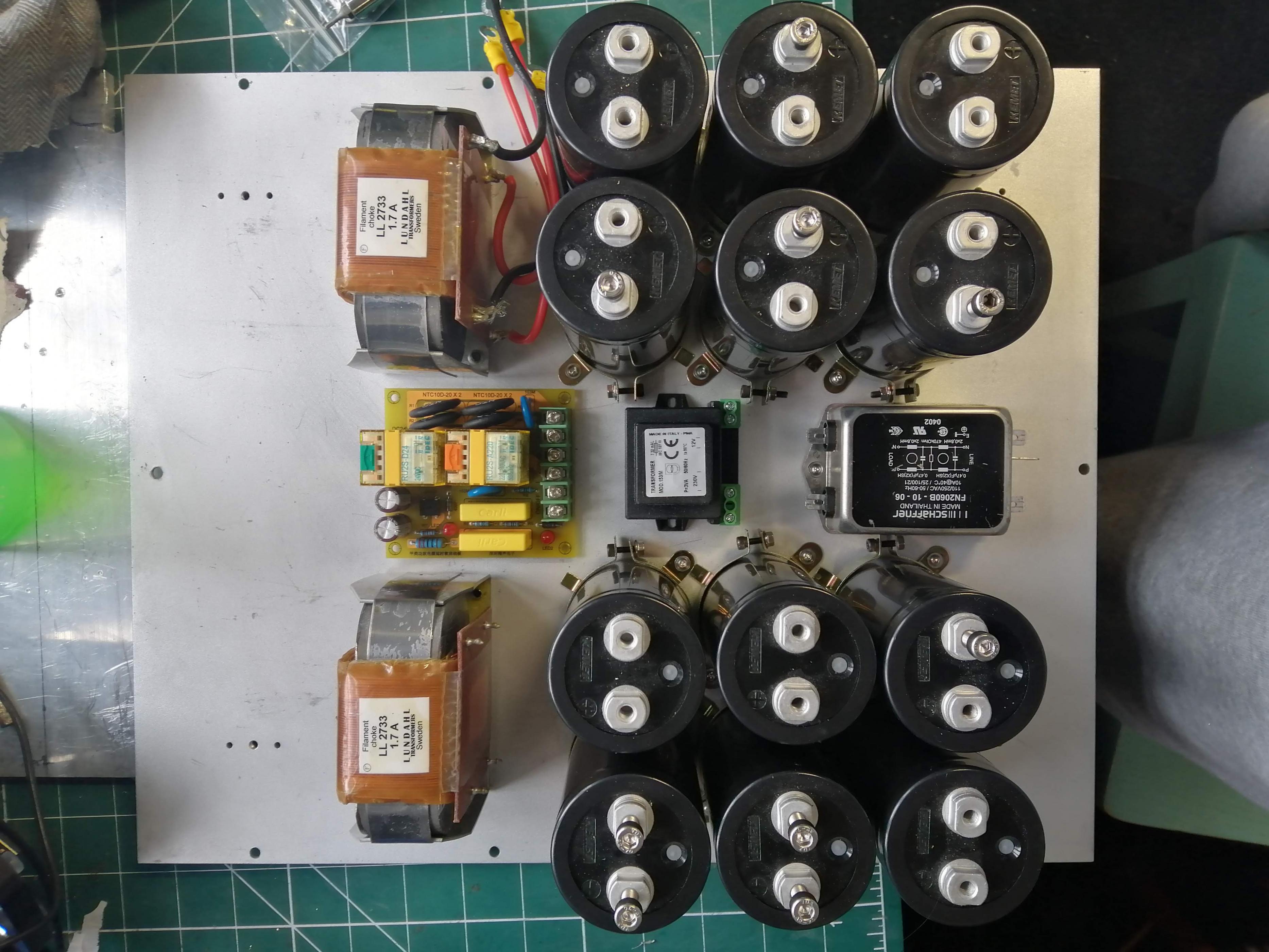

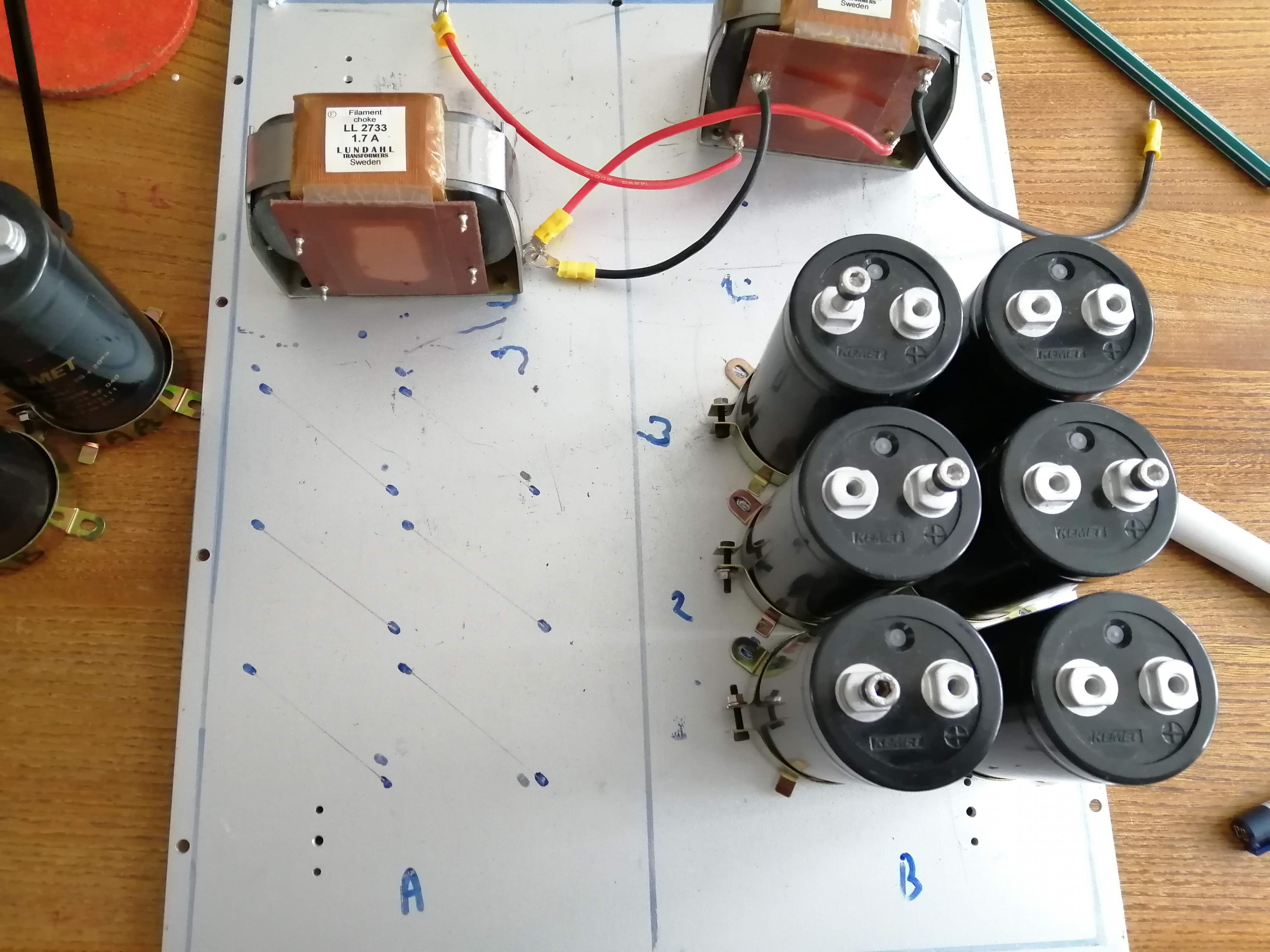

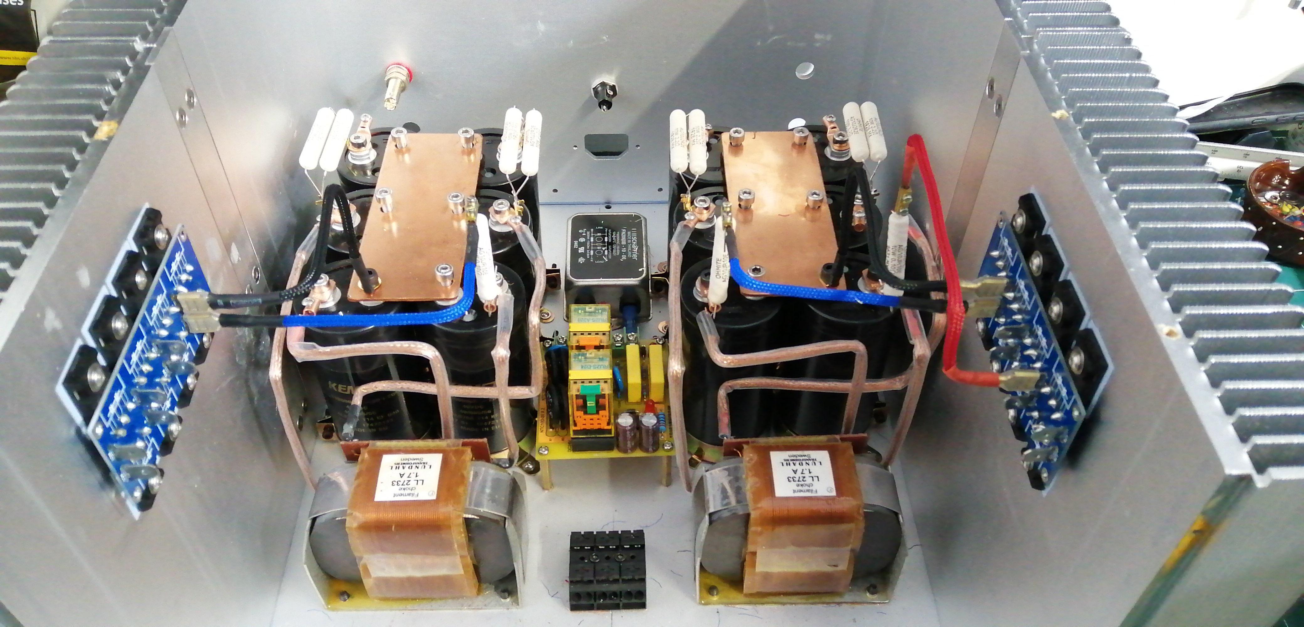

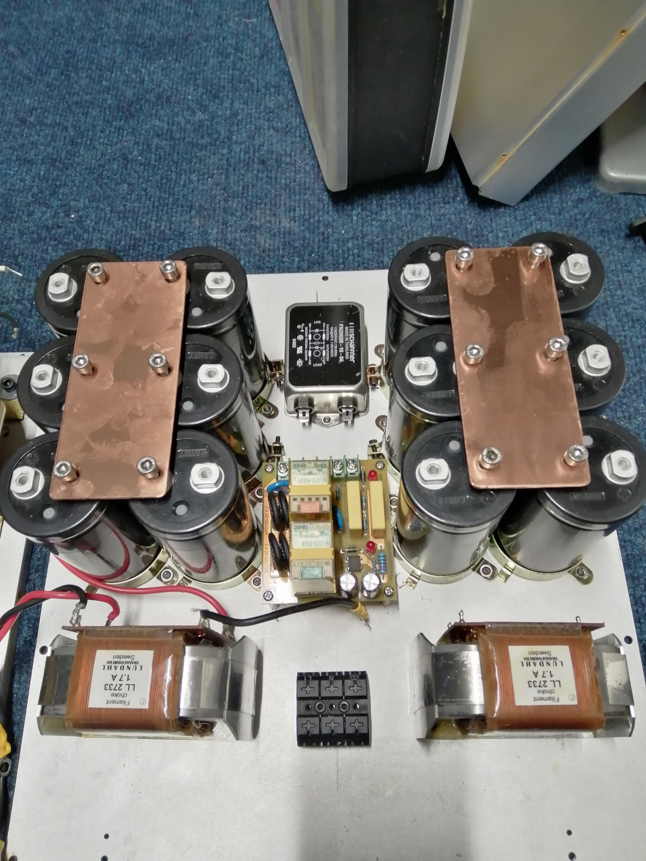

Here in the UK we are on lockdown for the safety of everyone, this has given me the chance to actually have time to finish this overdue Hiraga Build.
So to all my Hiraga building brothers here is the progress so far!

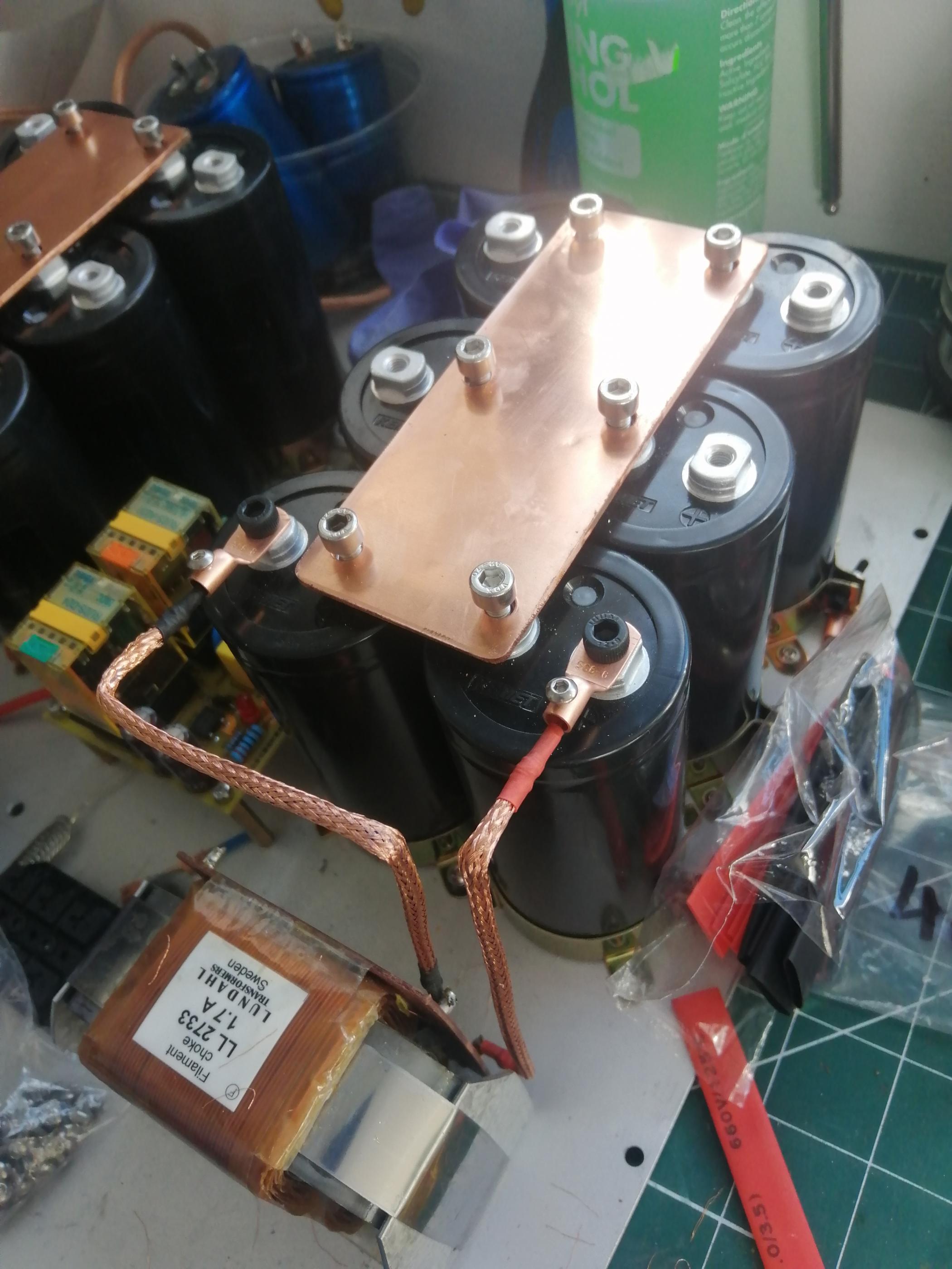

Nice build so far - one point, if it was me I would be putting insulation over the copper braids from the PSU caps to the chokes.
Also, what output transistors are you using, and what is the total capacitance per +/- DC rail?
Keep up the good work.
Thanks Gary, it's only copper sleeving and I was planning to use Clear heat shrink over it. Just forms part of the look I'm going for.
0.66F per channel 28.6v (voltage have to recheck once built)
Output transistors are 2% gain matched output transistors MJL4302A/MJL4281A.
Yes, clear heat shrink will finish it off nicely.

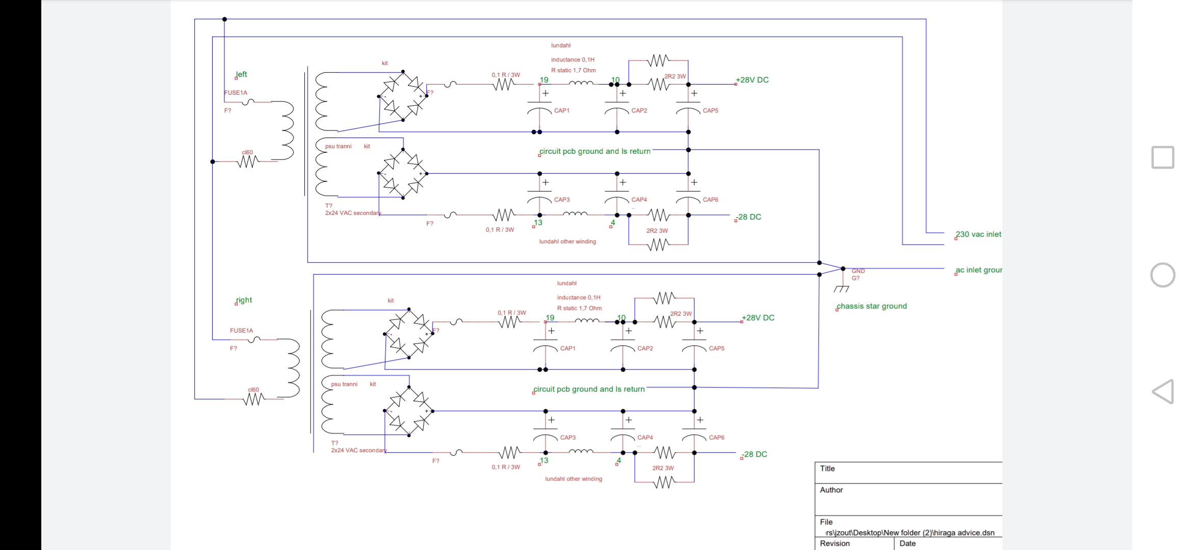

I assume when you say 0.66F per channel (660,000uF) - you mean that is 0.33F per rail for a channel total of 0.66F. That is one mean mono PSU and I seem to recollect that it reflects the original Hiraga design.

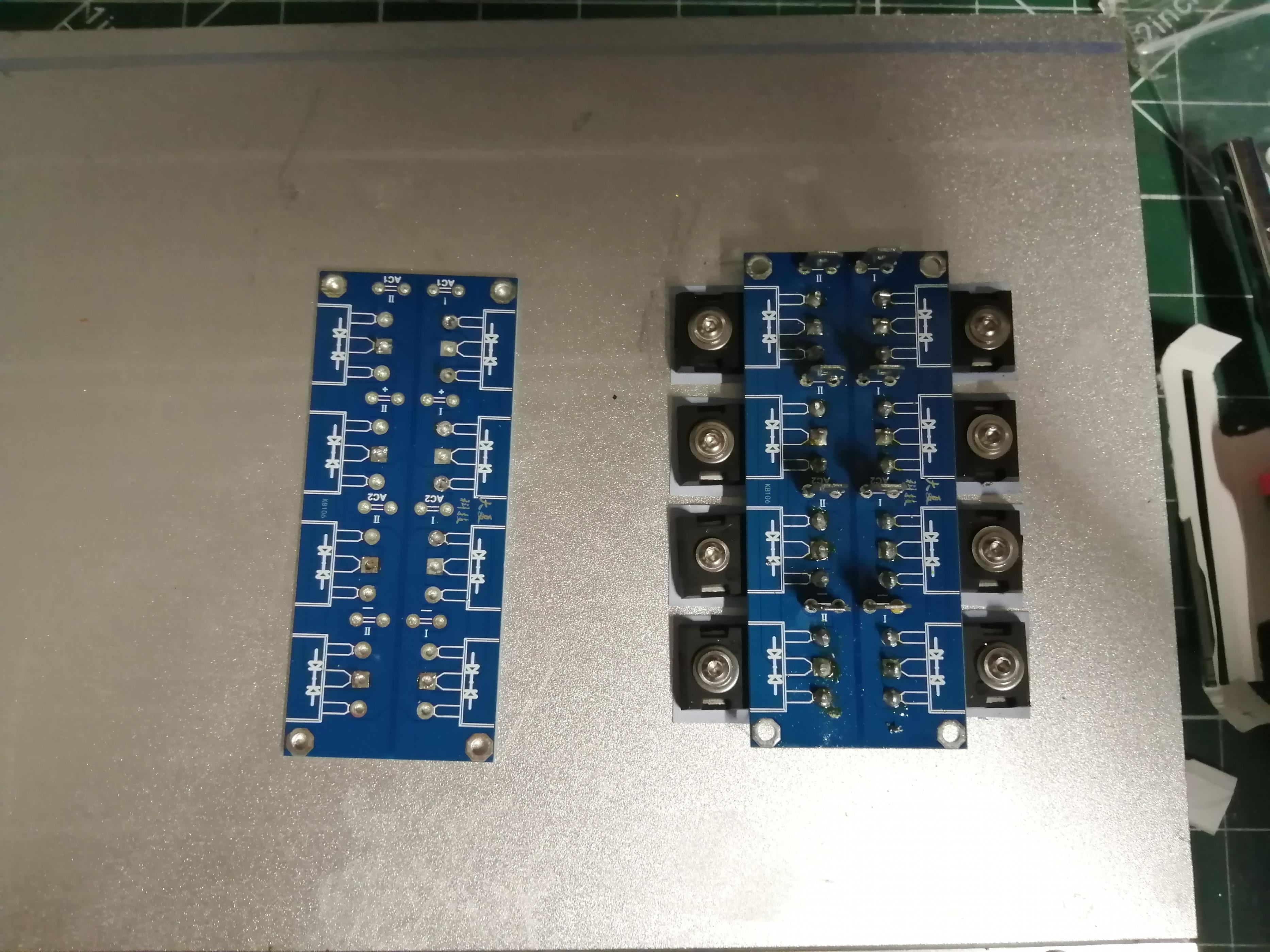

Were you able to buy gain matched output transistors, or did you buy a heap of them and test them yourself? Looks like you are using 4 in parallel per channel for each +/- rail.

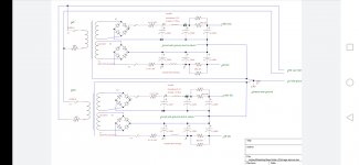

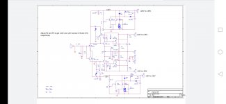

Can you post the schematics of the amp and psu as you are building it, thanks.

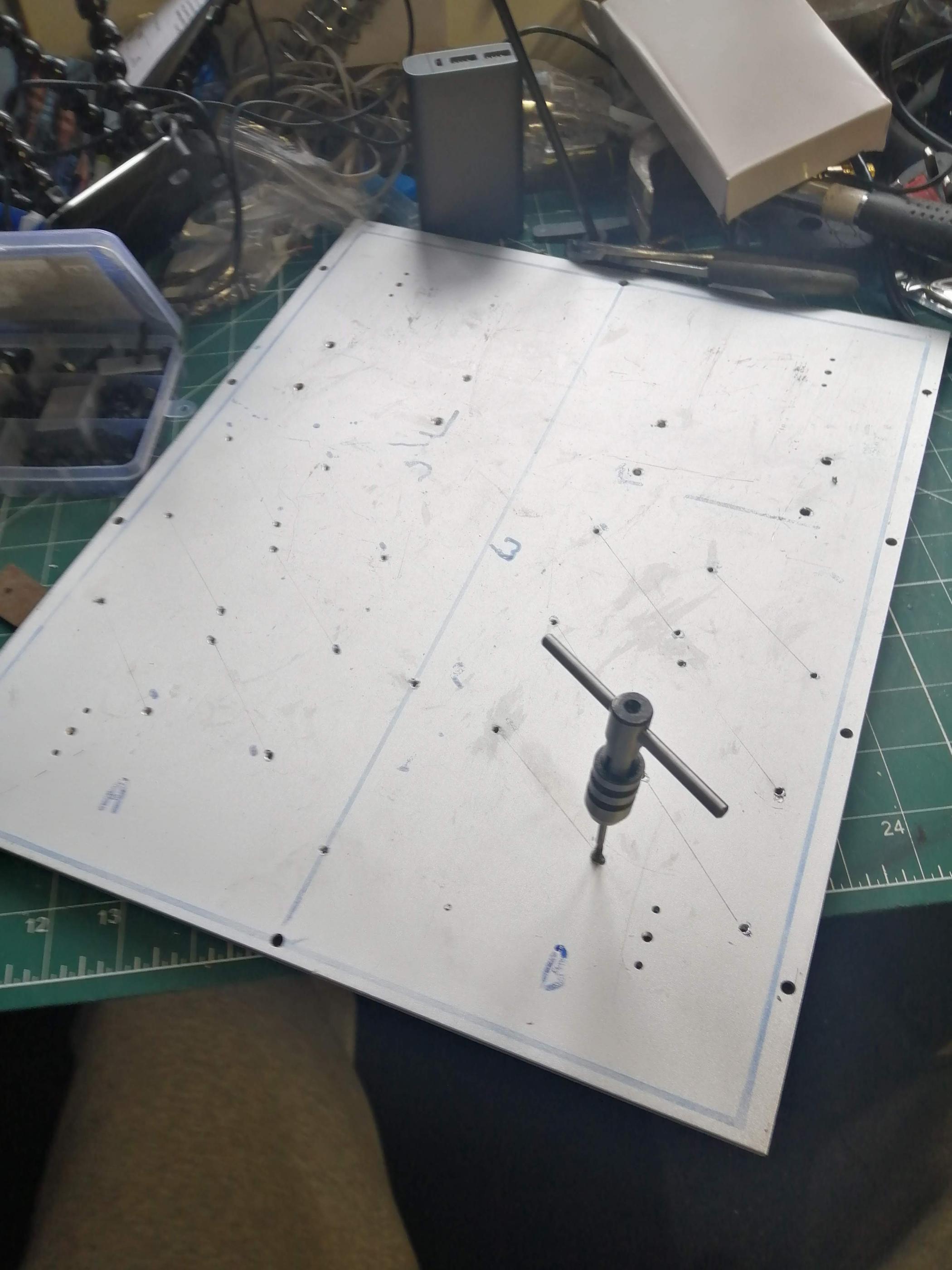

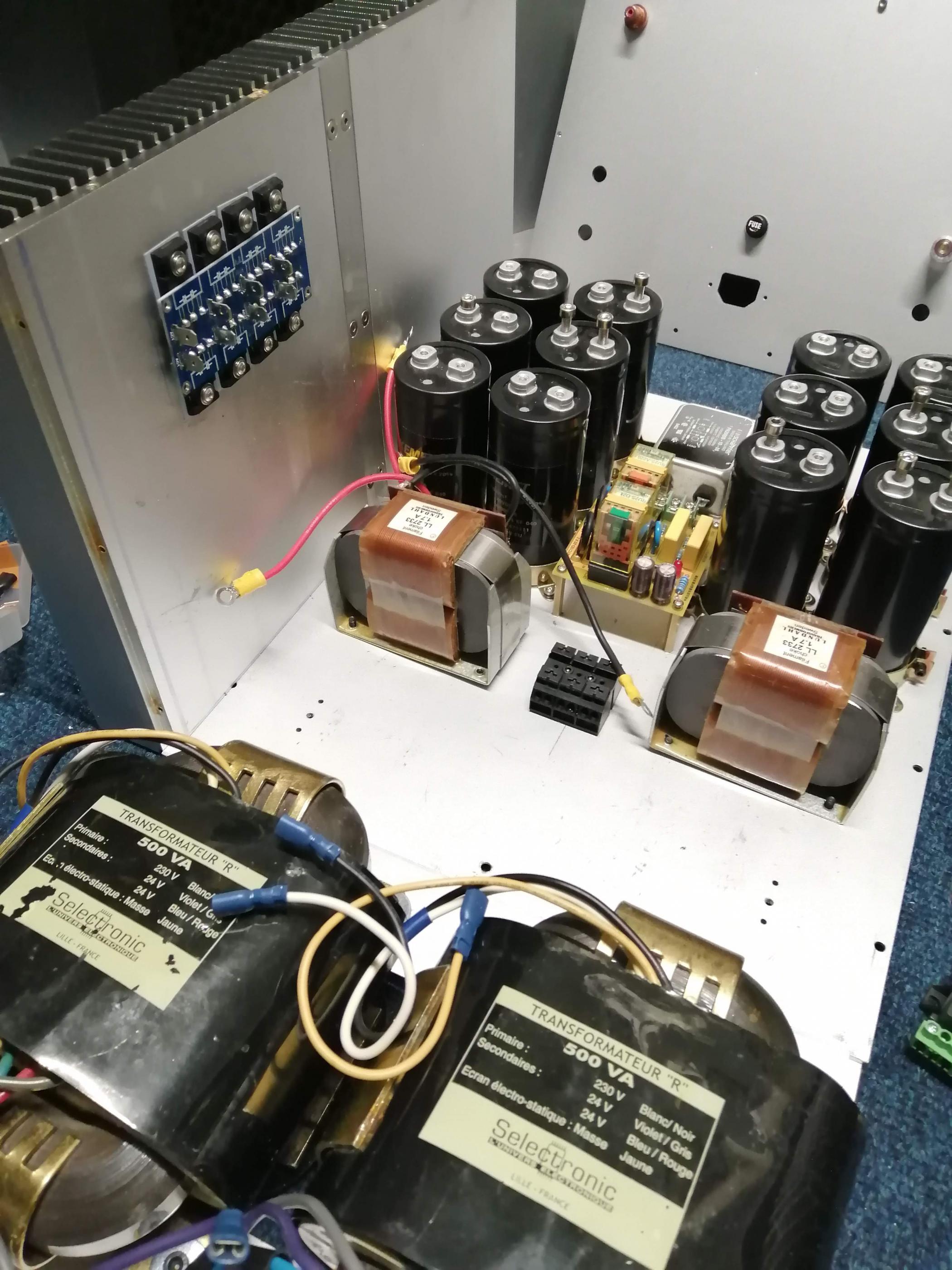

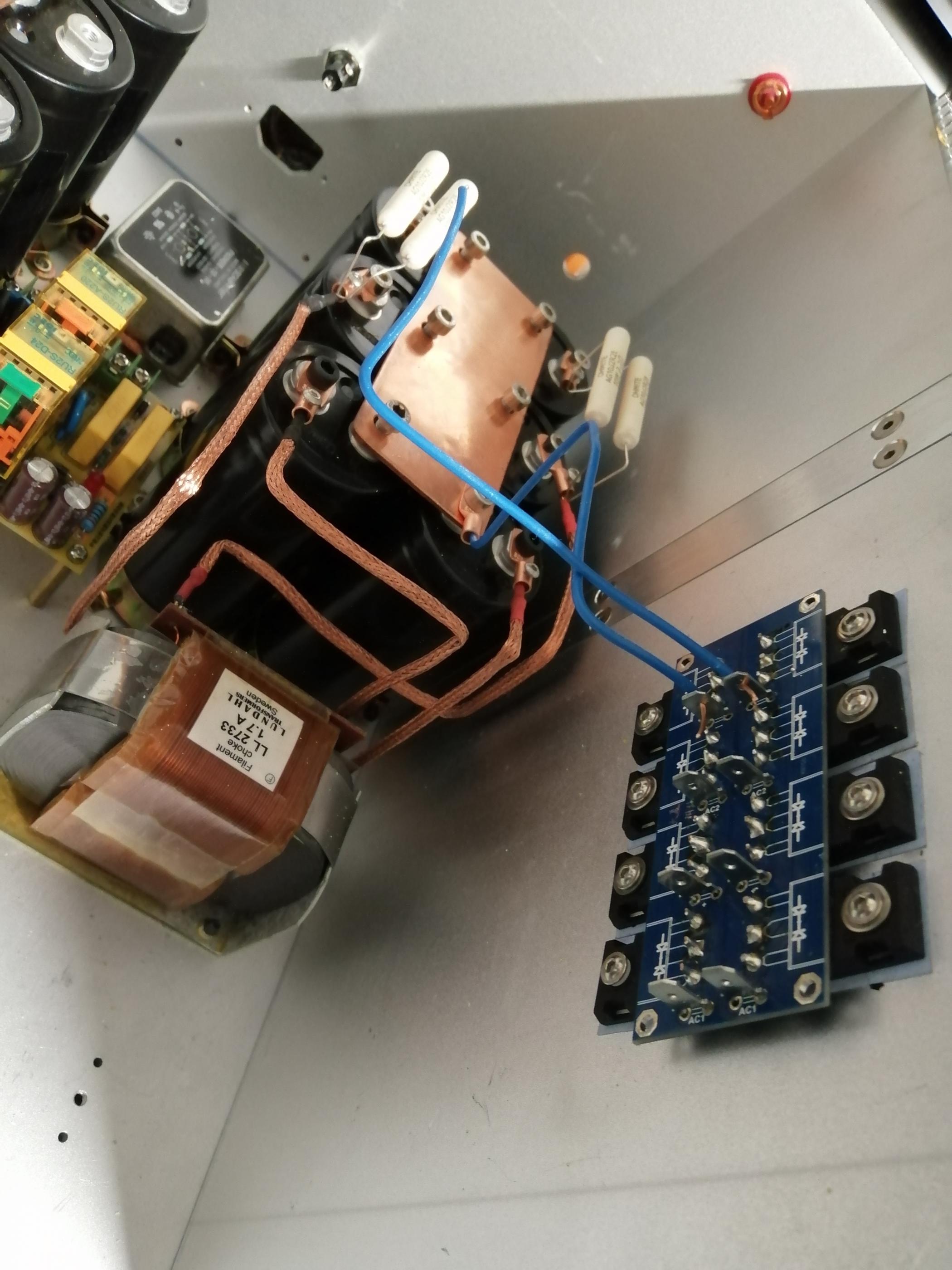

Making this wiring neat and tidy! All about neatness and it looking the part.
Unsupported high current wiring can move due to magnetic fields, you'll want to
brace and/or insulate these braided straps for safety I think, they could deflect a little on each turn-on surge.
Thanks Mark, its actually insulated solid copper wire with copper braided sleeving, it's not going anywhere, I'll also be putting clear shrink on it, that should stiffen it more.

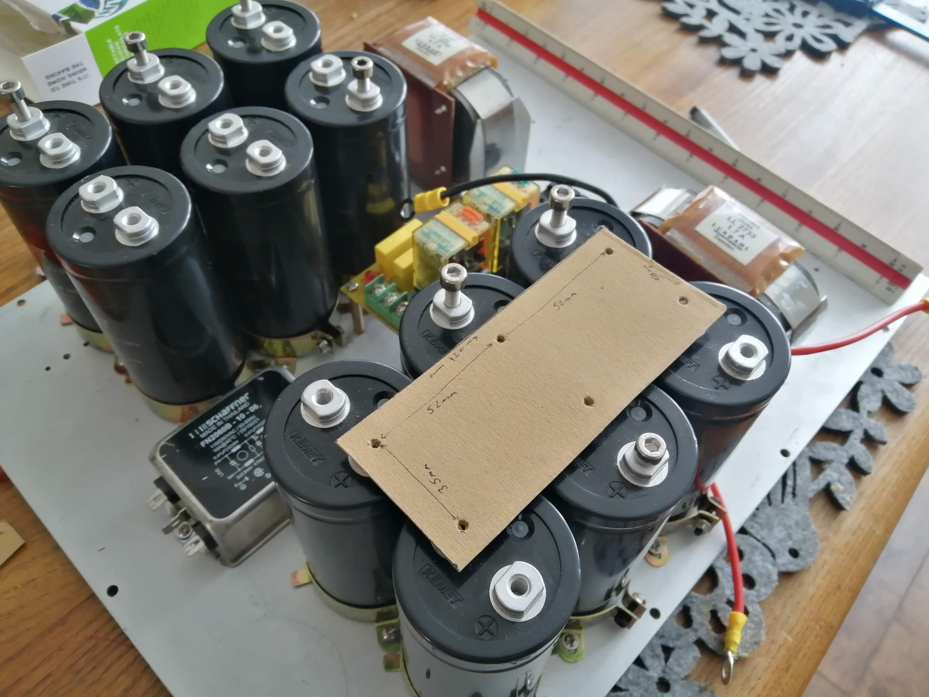

Vish, your build is giving me envious thoughts, really well done!
my 2c, capacitors like it cool, but if I am understanding it right, you have them inside an ‘oven’ so can you create some air flow up through the bottom panel and out the top ?
