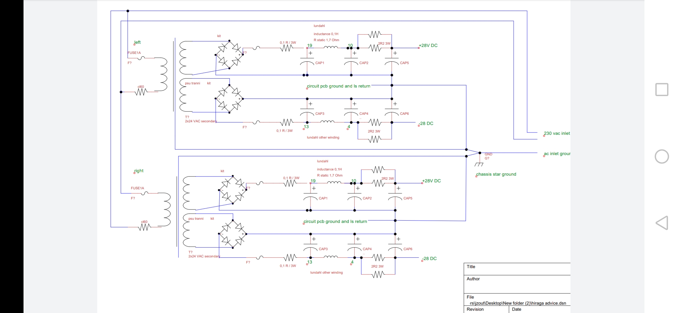

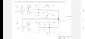

The Hiraga adventure has begun, I followed advices here and used paralelled metal oxide ballast resistors, I have a completed ripple eater, and 0.8 farad 35v capacitors plus chokes, and lastly dual 24 volt 40 amp amps, I will give all 3 power supplys a go and see which one performs best, my guess is the clc supply.
Theres loads of informative stuff in this thread, I'll will read through it thouroughly.

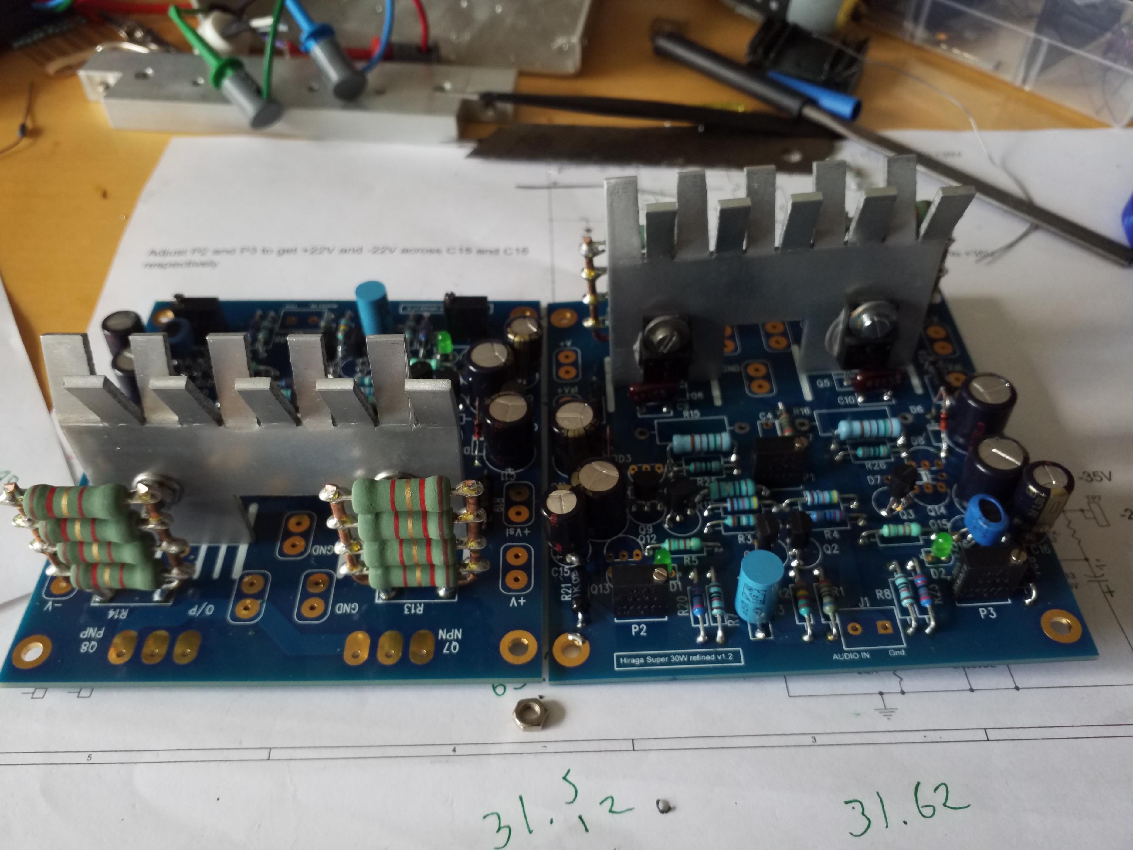

Further progress, I was unable to find suitable heatsinks for the driver section, but one hours work with a hacksaw cured that, I hope my homemade heatsink provides enough cooling, time will tell, I made them in one piece so that they are thermally the same, Jim's Bom list says mje15034/35, but I've heard praises on the 2sa1837-2sc4793 from Toshiba, so I installed them instead, they are leg compatible with mje.
For output I have a stash of old 2sa117/2sc2608 to-3 any thoughts on if they can work well in a hiraga ?
i just cut small computer chip heatsinks and glued them on the driver transistors on my 30w Hiraga. That works fine.

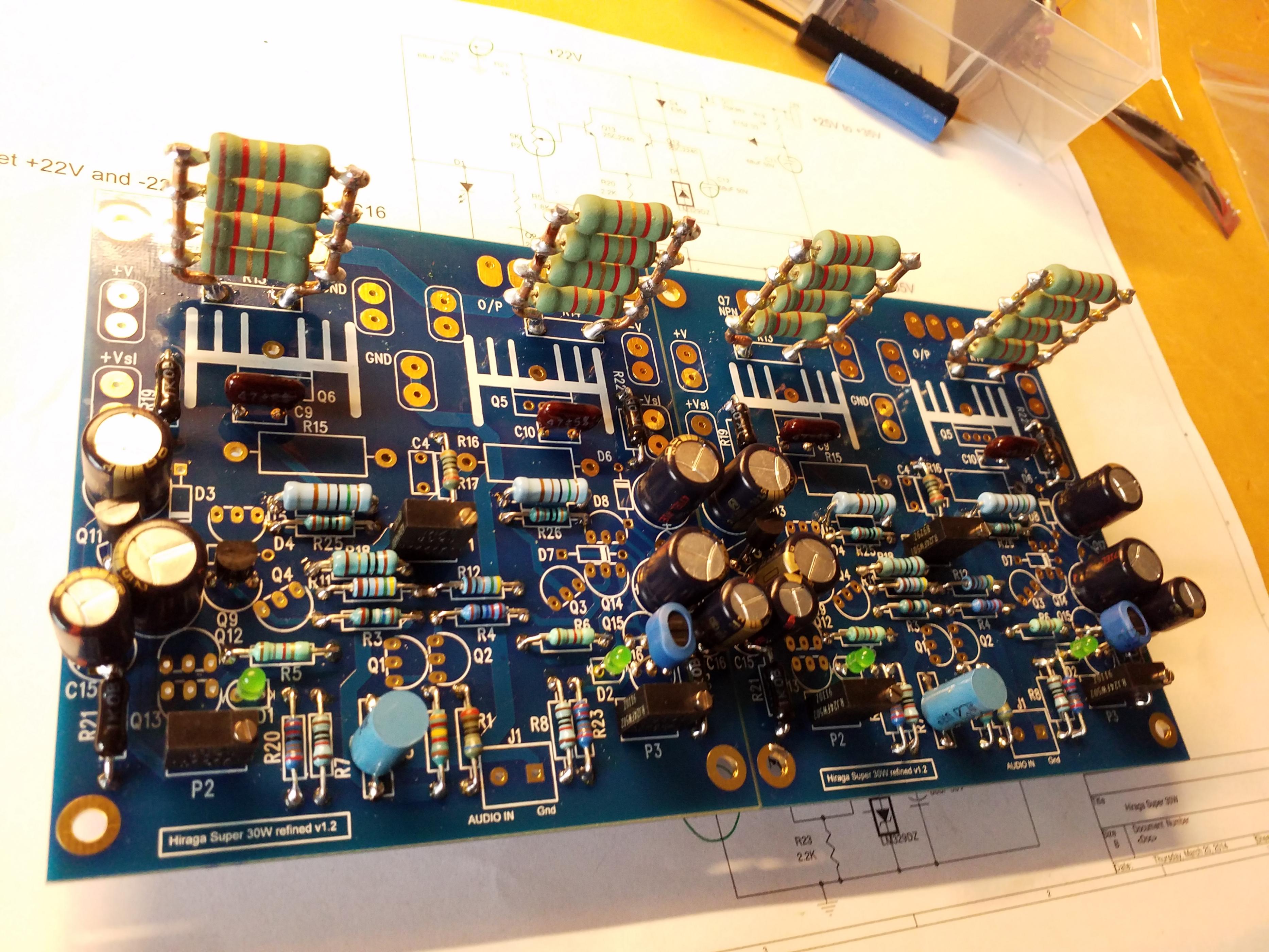

i used selfmade boards, slighly different than the original french boards. i use same transistors as Dan did. All original except of power transistors, Toshibas 2sc5200...
2 monos, with giant heasinks and fan support.
CRCRC psu with 1 F each monoblock, made of hundreds of 2700uF caps.
2 Ampere bias. gets handwarm only.

When i built mine 35 years ago i also found out that it is a good thing to mount the two drivers ( isolated) on the same heatsink. IF i remember well changing the temperature of one of the drivers resulted in a higher DC offset.
Also a good idea to replace the two 1K8 resistors close to the drivers by ones having some extra power rating. Originally i used the Shinkoh 0,5 watt changed them into Allen Bradley 2W.
