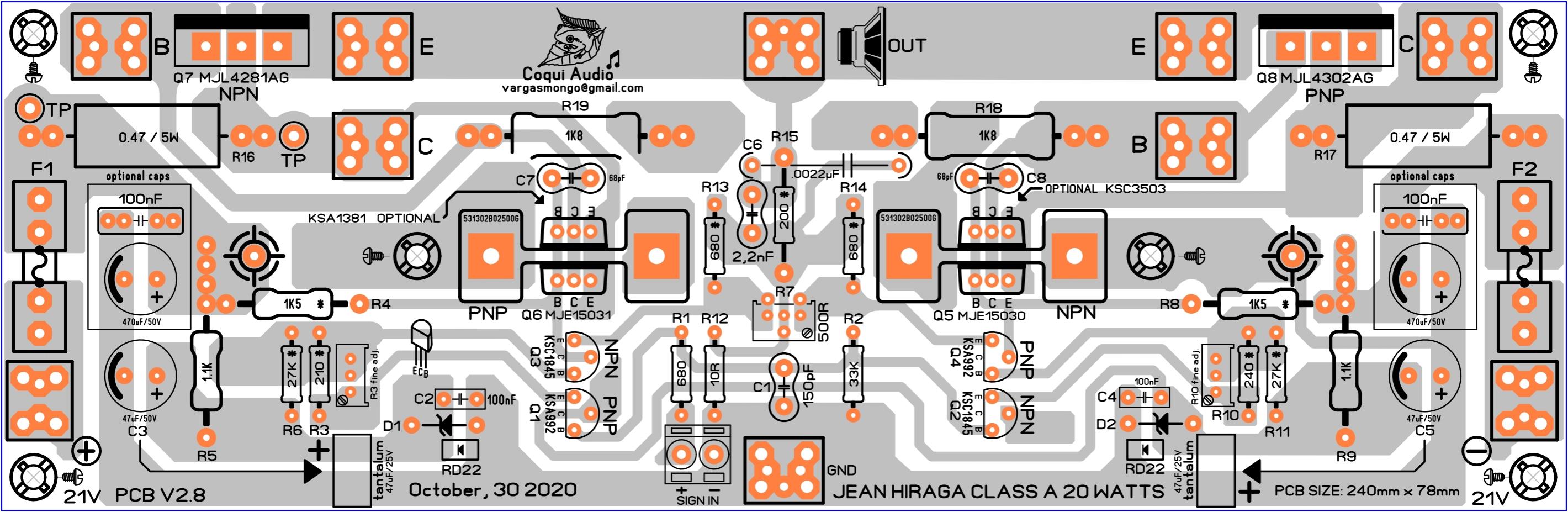

Hi I have a question since this is all about the Jean Hiraga design I design this prototype PCB and I add fuses but I see many that build it with no fuses are fuse not really need it?😕

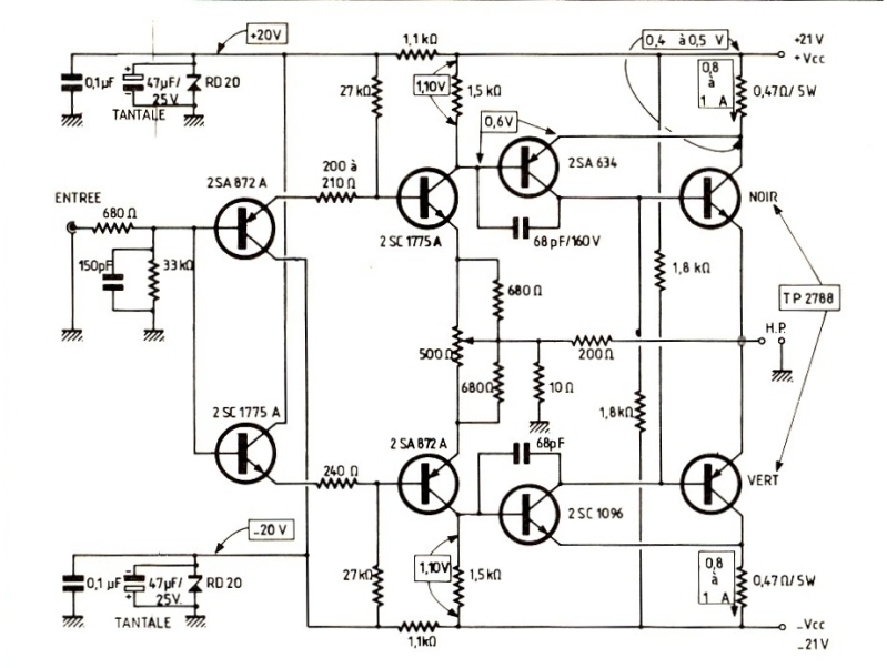

So today I finished both boards from Jim's audio, I hooked one up to 27 volt, and they work nicely, but, bias is a bit low, I measured 200 mili volt across ballast resistors that's roughly 0.6 amps, I would like it to run a bit hotter, 1-1.5 amps, I attach schematics, I hope any of you can help.
Btw offset is pretty good, only slight drift during warm up
Hi! I Have a same problem with my Hiraga with kubota reg. Have you found how to adjust bias? Maybe with R5, R6?
Post 352, r5-r6 I put a potentiometer in instead of resistors and adjusted to the wanted bias, let it cook for a while to get stable reading, the desolder the pots and measure what resistor will be needed approximately, be sure to have adequate heatsinking, they do heat up,.

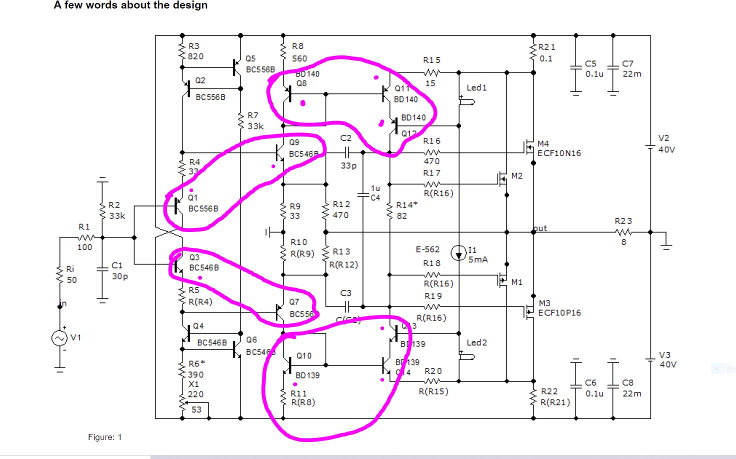

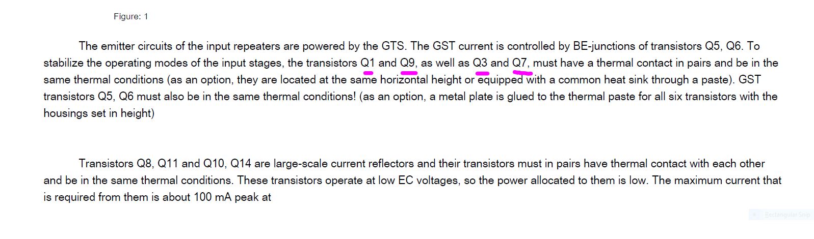

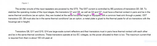

for what I see according to the PDF this transistors with the surround pink circular need to be bound together so that they will share the same temperature?
so is "what I imagine how they go"
Q1 and Q9 they go face each other and united with thermal paste
Q3 and Q7 they go face each other and united with thermal paste
Q8,Q1,Q12 can go on a heat sink
Q10,Q13,Q14 can go on a heat sink
I mean I'm trying to visualize them how they can go oriented on the PCB design
