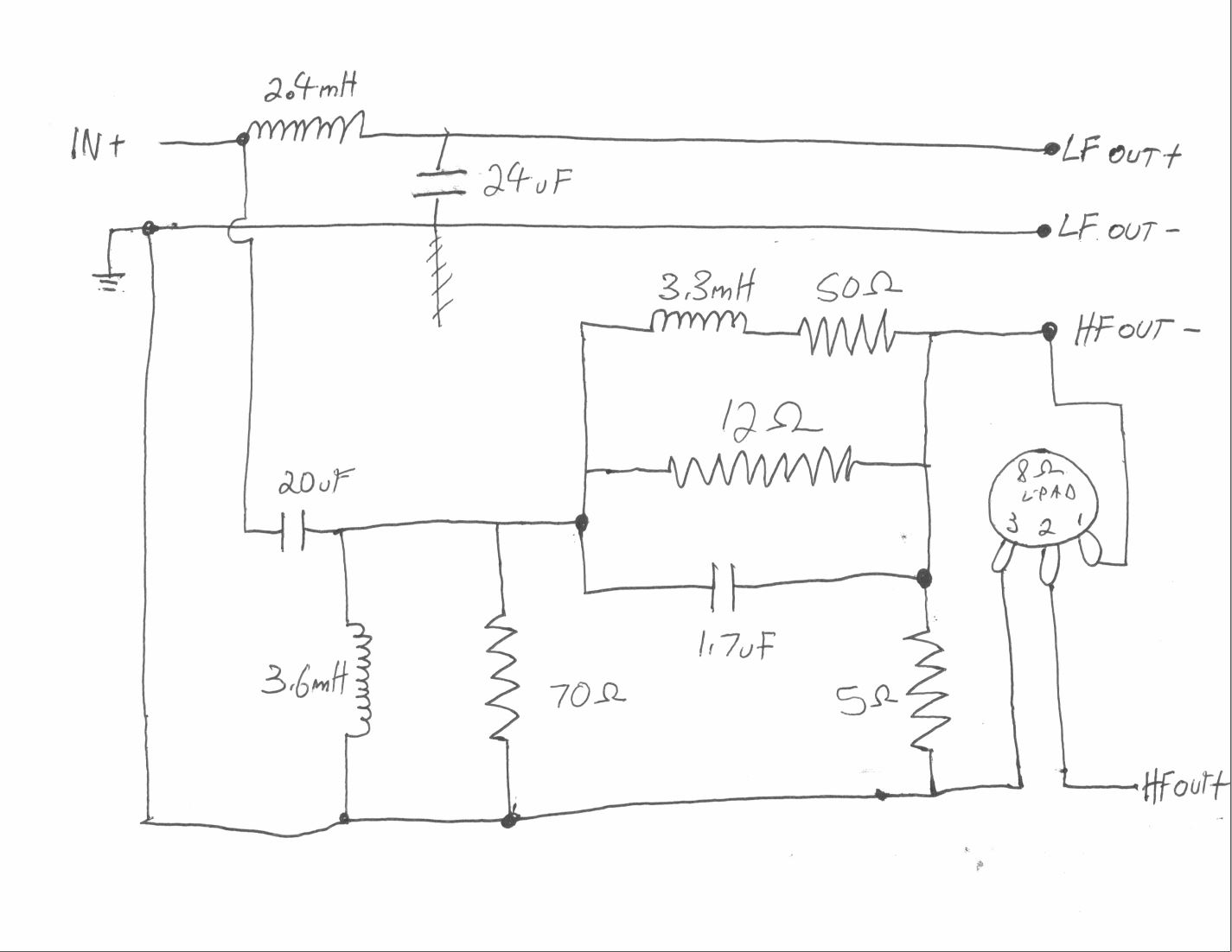

Tizman. Do you have a schematic of your crossover with the actual values you used?

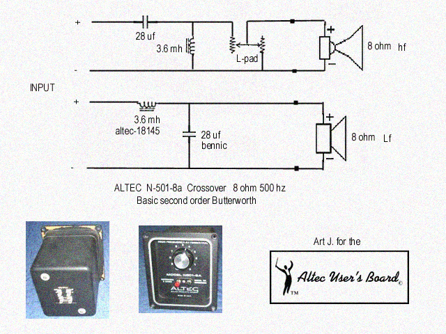

Hello again, you probably have seen this. The A7-500-8 crossover, simple 2nd order, you may already the parts to experiment with.

Thanks for the drawing. That's the Hiraga topology with somewhat different values. I'll have a look tomorrow. Honestly I don't think you need the the horn EQ, or at least not hat much of it. That EQ was meant for a very different horn and driver.
Just a quick question. If I jumper past the LCR section should I do anything with the 70 Ohm and 5 Ohm resistors to ground?

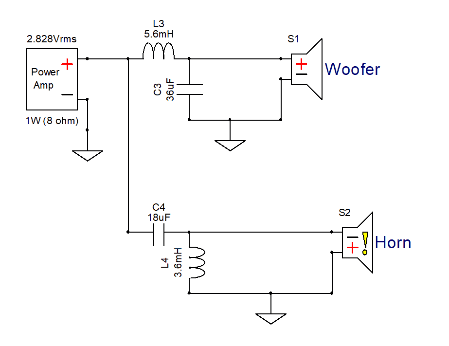

Given your crossover and the measurements, here is what I would try. It still leaves a droop in the top end of the horn, but that might sound OK. Still a small bump near 230Hz from the woofer, but that might also sound full.
If you can find something close to this, give it a listen and a measure, let us know what you think. If you want to buy parts to experiment with, don't bother with high dollar parts. Get some decent non-polar electrolytic crossover caps and you can use and iron core inductor for the woofer. Once you find the component values that work, then buy better parts.

I disconnected the LCR shaping components of the Hiraga crossover as well as the the resistors to ground on the HF portion. I left the L-Pad in just in case I use the crossover with a lower sensitivity LF section. I also moved the HF horn back on the top of the LF section so that the mouth of the compression driver is 25 inches back from the front of the LF cabinet in order to time align the drivers. REW shows the frequency response to be +/- 4.5 DB for the majority of the trace, with a drop at the frequency extremes, and the sound fantastic! Compared to a pair of Klipsch Las Scala, the sound is more cohesive and realistic. The only thing lacking is the highest frequencies when I A/B the two sets of speakers. I will try the A7-500 schematic next...
