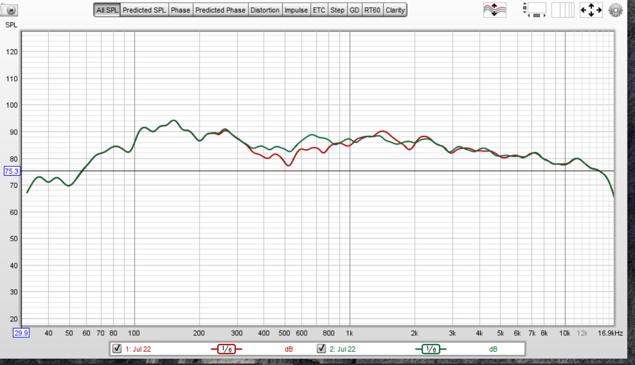

The Glyph: I tried both in terms of measurement, but only when the HF and LF were setup up so that their openings were in line. I’ll try it again now that I set back the HF so as to be time aligned to the LF.
I did a bit of searching a while back, and confirmed yesterday that the minimum set back for La Scala is around 24 inches. the FH-1 a bit bigger, so I set it at 27 inches back. I attached a REW screenshot of the two traces together. Green is reversed, and red is normal. This is in reference to the Riggle and Hiraga schematics, which reverse the connection, so that means that the connection is actually not reversed electrically. I think. I have to look at it again. The green trace looks better, but I haven't listened to them both yet.

For a LaScala the bass bin inside is approximately 24 in deep, 22 in wide and then about 4 inches from the woofer flange to dust cap. so 24+11+4= 39 inch path.
The FH1 is about the same depth but about 30 in wide, so 24+15+4=43 inch path.
Also if you put the horn way back on the top you will get strange early reflections.

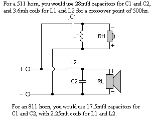

This is a source of ongoing confusion, so a picture always helps some folks. 😉
A composite for the N500-8, N800-8. Notice that the drivers are acoustically in phase when the +power connects to the - [2] HF terminal when the motors are in line [A7-500, etc.]: https://lh3.googleusercontent.com/p...xidZc2936MXweizmeOAzplxIFskkAr_3I6sRsVUmGr7vQ

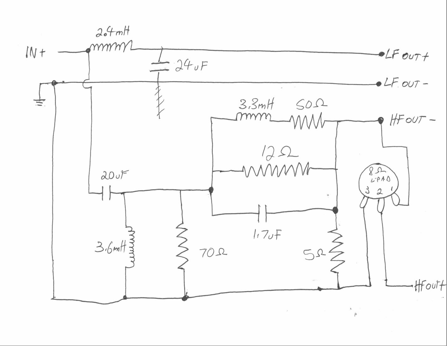

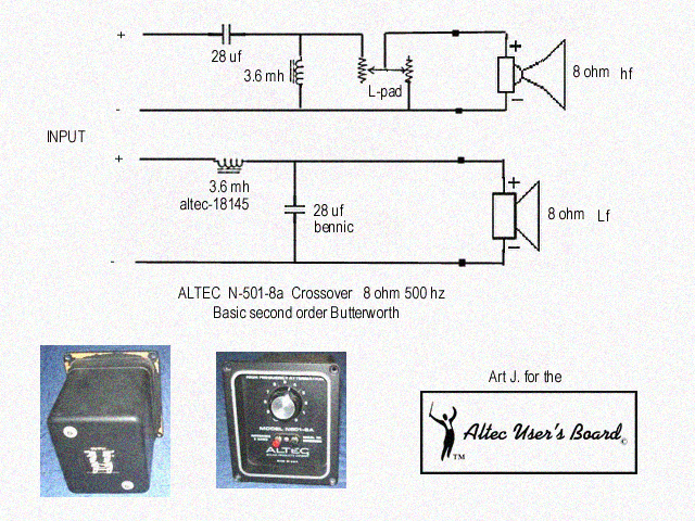

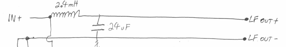

For quick reference here is the modified Hiraga crossover I built and the A7-500 crossover. I took out the 5 and 70 Ohm resistors, the entire LCR in the HF section, and the L-Pad is still there but not required or used, leaving the two inductors and the two capacitors.

"the path length looks to be close to 33-34 inches" that would be the length of the wood horn. I also added 4 inches for the woofer mounting flange to dust cap.
So the FH1 is 39 in path length + 4.

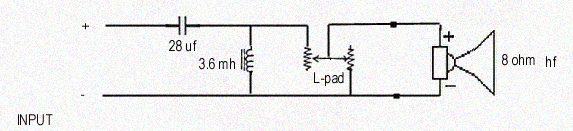

I attached the A7-500 diagram for use of the HF section. As you use a 4 ohm woofer the A7 LF does not apply.
Perhaps a combination of the LF in your pix and A7 HF.

I realized almost immediately that there was an issue, as there was obviously too much bass in the output.
I need to attenuate the bass by around 6-7 DB. I added an L-Pad on the output of the Hiraga, as per Pete Riggle's modification of the Hiraga crossover, in order to control the treble, but there is not enough treble even with the L-Pad set to let all the power through to the HF section.
