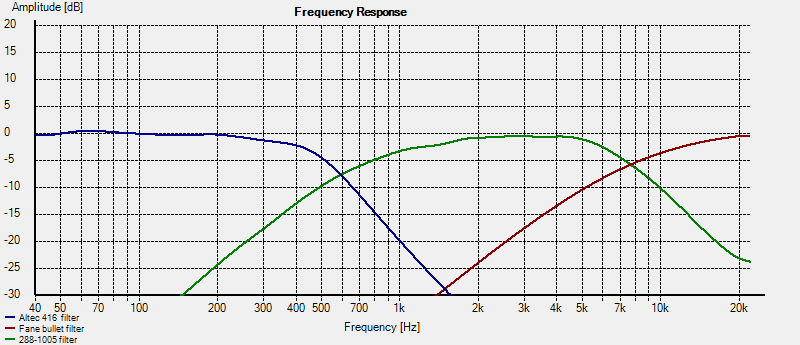

This is were I ended up electrically with my passive A5 crossover. Not shown on the graph is the attenuation of the mid (~12dB) and the super tweeter (~15dB).
Of course the acoustic curves were different because of the response of each driver. Electrically the crossover points were 600 Hz and 7660 Hz.
  • Woofer: ........416A in 828 cabinet. 8 ohm. LP 540 Hz
  • Mid: ............1005 horn with 288 16 ohm HP 700 Hz & LP 7700 Hz
  • Super Tweet: Fane bullet with JBL 'phram. HP 7700 Hz
This is very close to where my active version ended up.
My 288 compression drivers on the 1005 horns didn't play well up high, so I ended up rolling them off circa 8K and filling in with a Fane super tweeter.

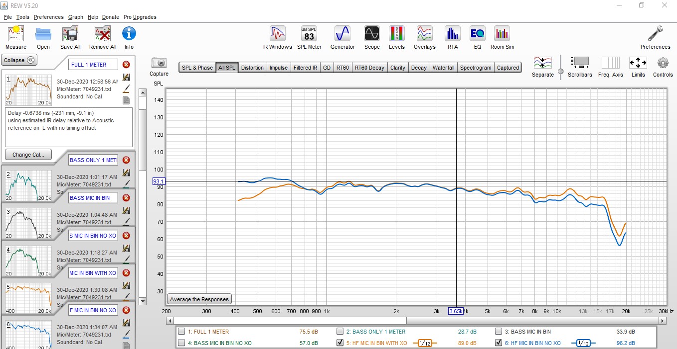

A quick update on my crossover. I ended up splitting the crossover into LF and HF sections, and running the split two way crossover with two stereo amps. After listening for a while, I found that the extreme top end was lacking in comparison to my La Scalas, and I reconnected the shaping portion of the network on the HF section. The bass seems to have filled in substantially with break in. I have a triode connected KT120 amp on the bass frequencies, and an El Mighty Cacahuate amp (WTFamps.com) on the high frequencies. The separate volume controls allow me to balance LF and HF, but can be a little finicky. I am very happy with the SQ. I will post a REW measurement shortly.
New measurements
These are the REW measurements as promised.

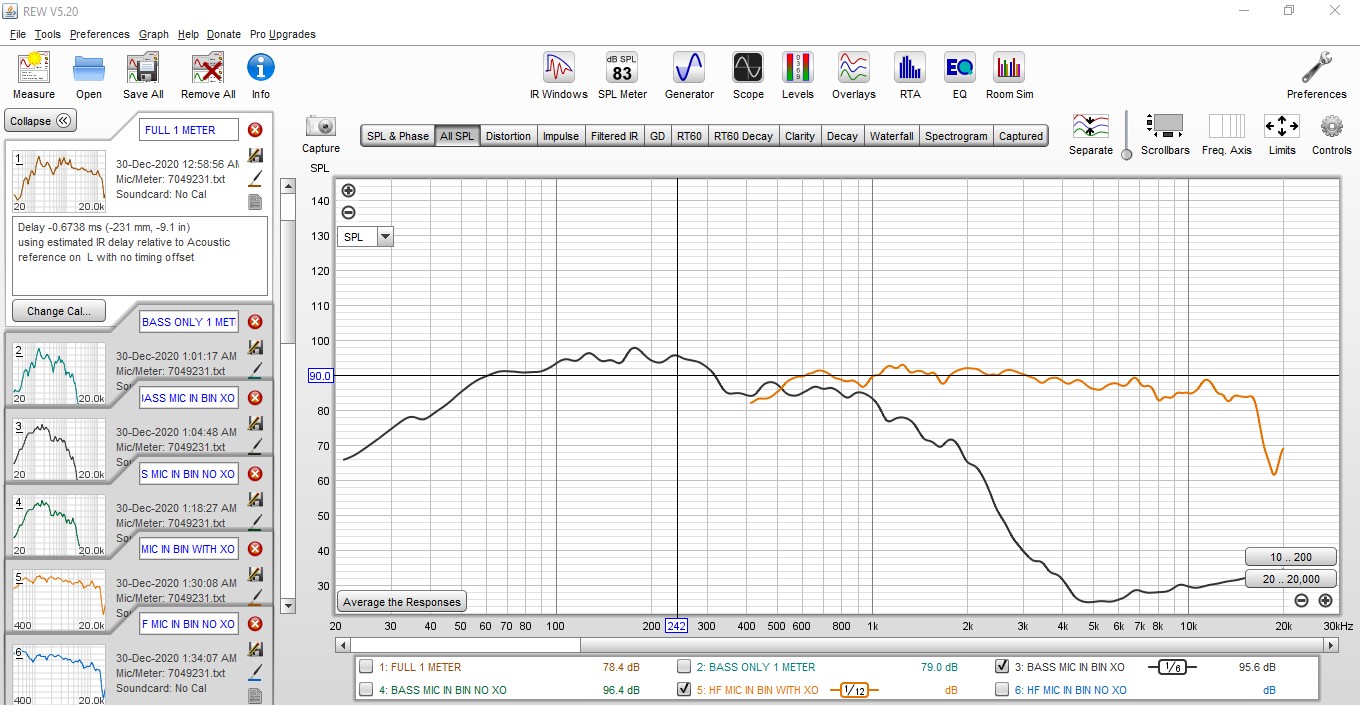

FULL XO 1 METER is a measurement taken 1 meter from the HF horn, of the entire speaker through the crossover.
BASS AND HF CLOSE WITH XO is an overlay of measurements taken of the bass horn and of the HF horn in which the microphone was placed at the mouth of each respectively.

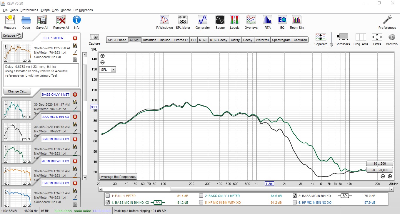

BASS XO YES NO is the bass horn measured at the mouth with with and without the crossover.
HF XO YES NO is the same thing done for the HF horn.
I am very confused about why the BASS XO YES NO photo looks the way it does. The low pass starts at around 1100 HZ rather than at the 625 HZ it is supposed to start at. If you look at the FULL XO 1 METER image, it seems that this incorrect crossover point adds to the excess of energy between 600 and 1400 HZ. The error in the crossover point may be due to using 6 Ohms as the impedance of the Eminence 15C in cabinet rather than some other value. Fixing this looks like it would even out the frequency response.

That's not a bad result to start. There is that midrange bump where the drivers overlap. It looks to me like the woofer is not rolling off fast enough. There a few things you can do to correct that, like a Zobel circuit or changing the values of the low pass filter. The woofer is going to have a rising response, so crossing lower and/or faster is need to get it to sum with the horn.
EDIT: It also appears that the horn crossover isn't doing much high pass. We should see some roll-off, ever with your sweep starting at 400Hz
I'll take a closer look today. BTW, you can use the little camera icon there in REW to export just the graph. You can also include or exclude certain things, and add labels. It's very handy.

Actually, I was up late. I am in the restaurant business, and COVID-19 has shut that down for the moment, but I still keep the late hours. I have a number of components on hand of different values, so I can breadboard them until I get something that works. GM mentions impedance plots for both horns, which I haven’t done and will look into. That’s probably where I should have started.

And what about your horn plot? It does not look like there is a high pass filter. At least not the one you drew.
The HF horn is a Renkus-Heinz SSD-1800 8 Ohm in a 511B. The bass horn is an Peavey FH-1 with an Eminence 15C in it. The Eminence is a 4 Ohm woofer. From reports online, as I haven’t measured the actual impedance of the 15C/Fh-1 combo, the impedance of the 15C in a FH-1 is supposed to be 5.8 Ohms. I know what you mean when you say that neither the HF or LF crossovers seem to be doing very much. I use SET amps on both of that has anything to do with it. The thing is, if using a SETs is relevant, I will need to create a crossover that takes that into account, as I will most likely continue to use SETs.

The SET will make a little difference, but not as much as shown in your plots. Something isn't working right.

The crossover you drew does not seem well adapted to your divers at all, but with your close measurements it can be hard to tell. Is it possible for you to do sweeps with the mic at 1M or 5 feet? No crossovers. That would help us know a little better what's going on.
