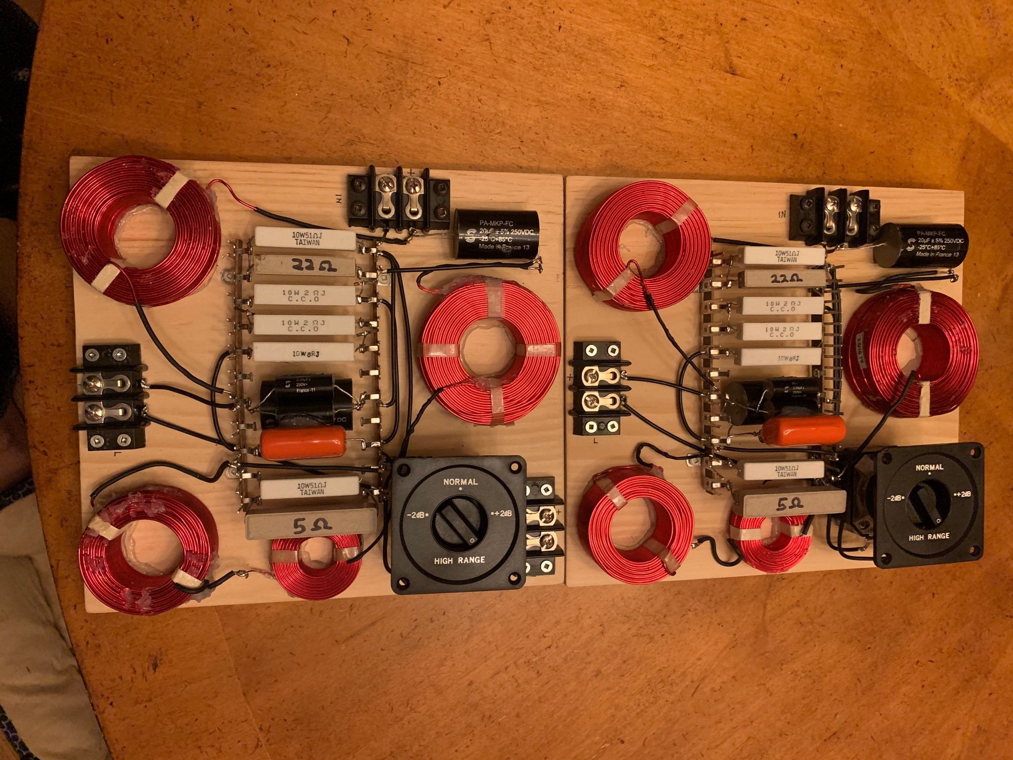

Hello All.
I recently built this Jean Hiraga crossover for the Altec A5 in order to combine a 511B with a Renkus-Heinz SSD-1800-8 compression driver and a Peavey FH1 with an Eminence Kappa 15C. When I started my build the specs that I looked at for the original LF cabinet that came with the Altec VOTT A5 indicated that it would have a sensitivity close to what the FH-1 with a 15C would have. Apparently, I was mistaken, as the specs for Altecs 828 cabinet show it to be substantially less sensitive than the FH-1 with a 15C. Basically the FH-1 combo is 6-7 DB more sensitive than an 828 cab. I realized almost immediately that there was an issue, as there was obviously too much bass in the output.
I need to attenuate the bass by around 6-7 DB. I added an L-Pad on the output of the Hiraga, as per Pete Riggle's modification of the Hiraga crossover, in order to control the treble, but there is not enough treble even with the L-Pad set to let all the power through to the HF section. Looking at the schematic, there doesn't appear to be any mods that I can make to it that will increase the overall treble level while still maintaining the equalization that the horn/cd combo requires. Am I correct in thinking that my only solution is to add an additional L-Pad to the LF section? Should I move the existing L-Pad to the woofer section, as it is useless on the HF section? Or am I missing something? Any advice would be greatly appreciated.

Adding a level control or pad to the woofer circuit will destroy the amplifier damping, retune the bottom end alignment and just about every bad thing you can think of. Either biamp, or get a new woofer. I’m surprised any woofer would be more efficient than a HF horn and compression driver.
You copied the Riggle version Hiagra A - 5 crossover and changed all the drivers ? It isn’t a recipe for a good outcome....... your too far away from the original components to expect this to work well. Having the cabinet and the horn with different drivers Isn’t the same thing.

Unfortunately it looks like you've gone down the wrong path. This published crossover is not at all suited to your speaker. You'll do best to start from scratch. Sorry for the bad news.
Since I was there for the original Hiraga A5 speaker and crossover (I used them for gigs) I know how they can sound. When I built my own A5 and tried to use the published crossover it was not at all satisfactory. I had to start from scratch. The A7-500 crossover was different from that, and the A7-800 a little different still.

You could use a 2:1 autotransformer instead of an L-pad on the woofer.
I originally was going to build the ALK crossover for this combo, but didn’t have autotransformers on hand other than the ones in speakers that are currently in use. Buying them from the US with exchange and shipping makes them very expensive. Also, the ALK schematic doesn’t have a shaping section to equalize the HF response. If the LF section was about 6 DB quieter, I’m sure they would sound good. I may pull them out of the speakers they are in if there isn’t an alternate solution. I have an electronic crossover and multiple amps, as building tube amps is my primary hobby, but tried the passive crossover to simplify things for other non-audiophile listeners in the house.

Also, if I use a L-Pad that presents the same impedance to the amp of 6 Ohms, of appropriate wattage, to take 6 DB of the LF output, why is that not a good idea?

Sure. From the secondary winding, the impedance looking back into the amp is small. In a sense the 4 ohm tap acts like a self contained autotransformer. The only drawback is that this represents -3dB. If you used 4/16 you'd get 6dB.
This is the simplest solution. You might need to make minor response adjustments but it will work. Most of us have probably done it.
Some would declare it a waste of power. I notice that the FH1 is 103dB sensitive. What do you use on it, 10W? The L-pad would now use that as well.. less actually as you're aiming to be running the woofer lower than before.

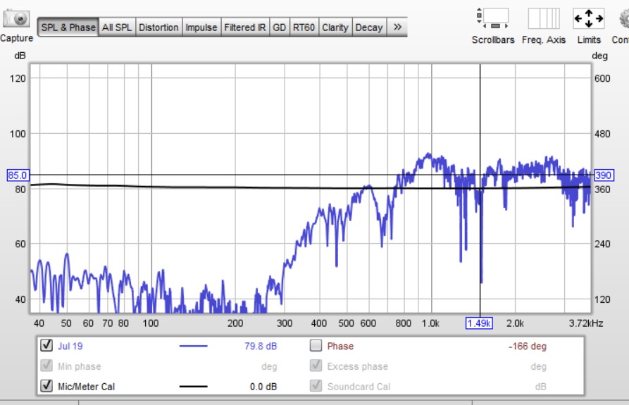

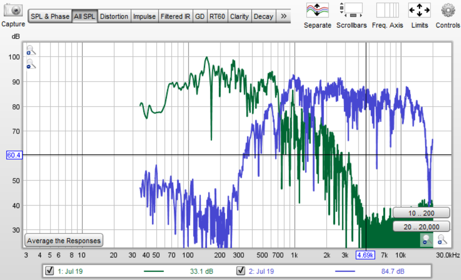

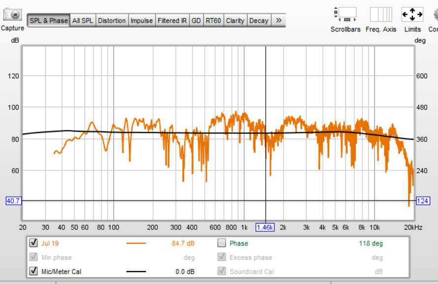

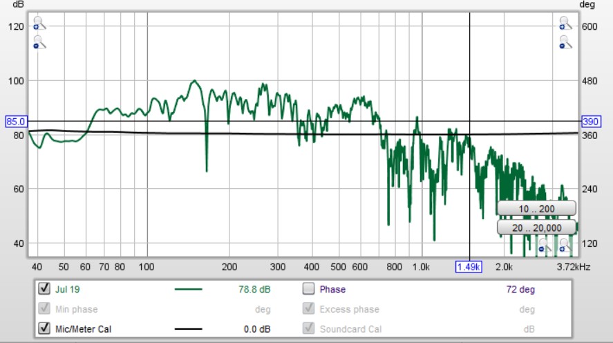

REW measurements
These are four measurements made with the microphone placed about a meter away from the front of the speakers, and placed slightly above the top of the bass cabinet so that it is pointing at the lower third of the 511B. I have included three images. One is the combination of both speakers (combo), one is for just the HF on, and one is with just the LF on. I also included a measurement of one of my La Scala speakers for reference.
