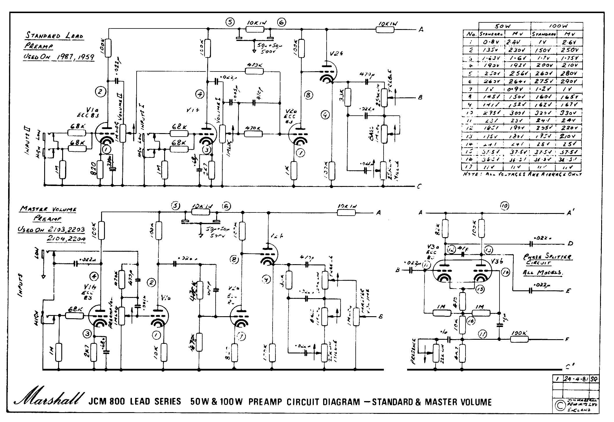

R24-25 is 150k on your other schematics, and what you have is 220k. Why not parallel another 220k? (You can later increase the capacitance of coupling cap if you wish so the freq. response stay the same). In my own test, I can plug in only one tube, I am not sure if you can do that. In this way can test and study the tube individually and isolated to one side of amplification (tube, bias, OT etc). On mine the tubes do not clip as heavily as yours, only very slight clipping as signal is increased as cross-over distortion become more prominent during clipping.
Hi Koonw. In the circuit I've 220K resistors, as indicated in a note in the foot of the Mark Huss schematic. In fact now I'm looking more to the original Marshall schematic (in attachment what I found) that indicate 220K for EL34 models.

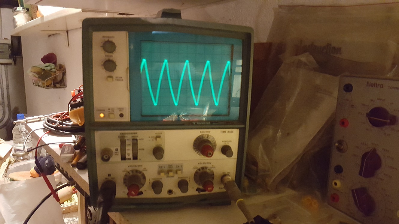

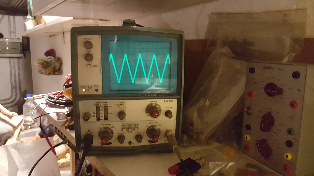

Here the results of the test with triangular waveform - 100mVpp at High gain input. The scope picture:
Controls was
- Presence&Bass = 10
- Middle&Treble = 0
- Master & Gain = 3 (no redplate with this combination)

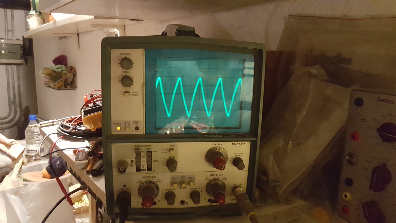

At PI output (after the coupling caps) I measured 50Vpp both for V4/V5 signals. here the pictures:
I take also the scope picture at pin 3 of both tubes V4/V5. Here the pictures. The scale is 10V.
I measured also the Bias sag. At idle the bias voltage is -36Vdc, at full power (master & gain = 10) is -41Vdc. The replacement of C23 improved a lot the situation. Before at full power I had a B+ ripple of 20Vdc (now eliminated) and the Bias voltage at maximum power drops to -58Vdc (may be the 2 values are related?)
Can you adjust the image so that the zero crossing line of the plot is in horizontal middle (centre) line of the screen, we use this middle line as reference.
Pin 3 is plate, do you mean pin 5, grid 1?

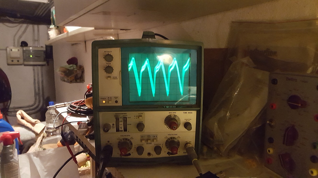

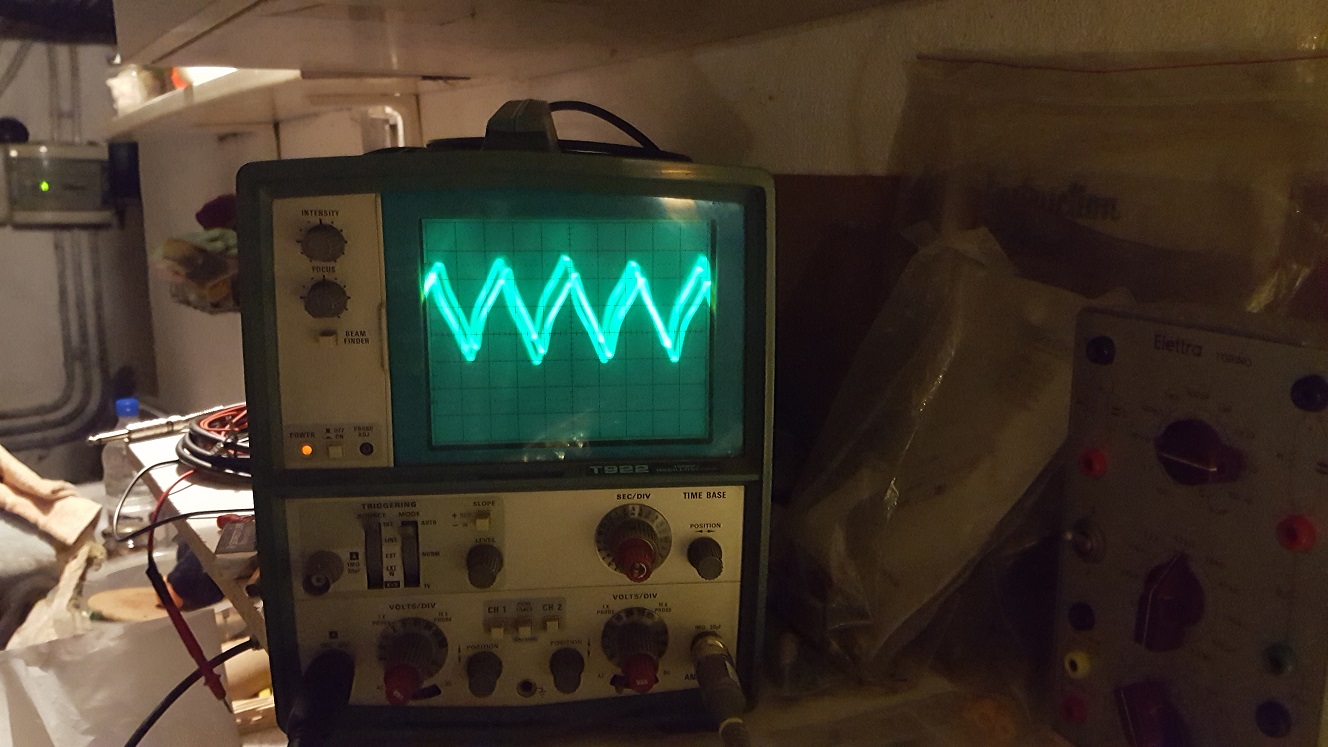

if it is the plate, what's up with the late conduction in the top trace in the last set of pictures?
if it's the grid why do the waveforms look different than the previous set of pictures (output of phase inverter)
also this may be just me... but if a negative voltage increases it become more negative...
what i find bizzarre is that as the amp is driven harder the less gain the output has (if i'm correctly understanding SimoS description)
It's plate, between pin 3 and ground. I don't know if it's significant.
Ok, the 2 waveforms should look more or less very similar to each other and not so distorted, unless it's due to NFB correction. If so much correction is needed you have distortion somewhere (tubes?). I suggest you get another pairs of tube to compare.
Or remove the NFB to see if distortion now appears in the output and measure again, the pin 3.
