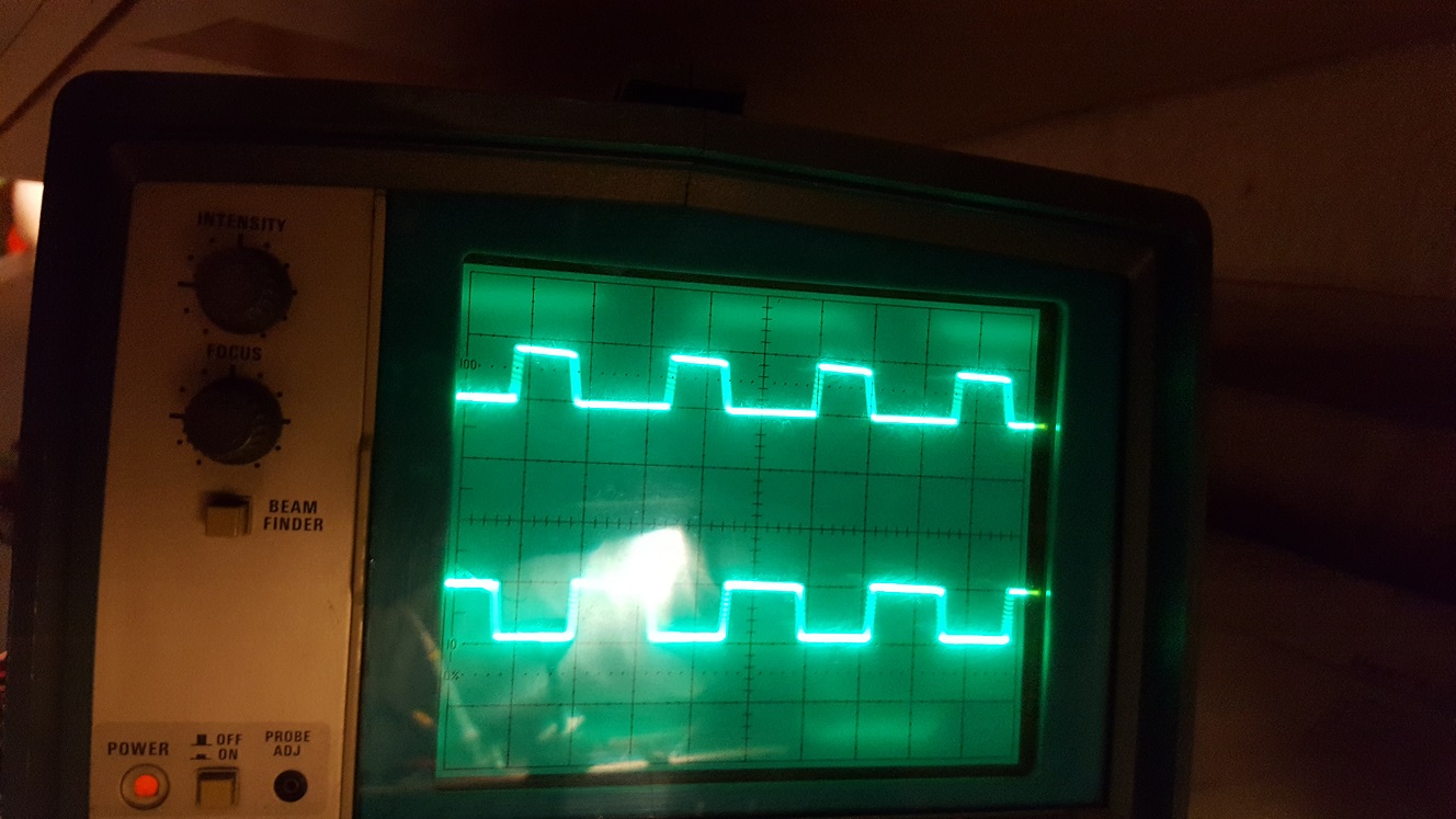

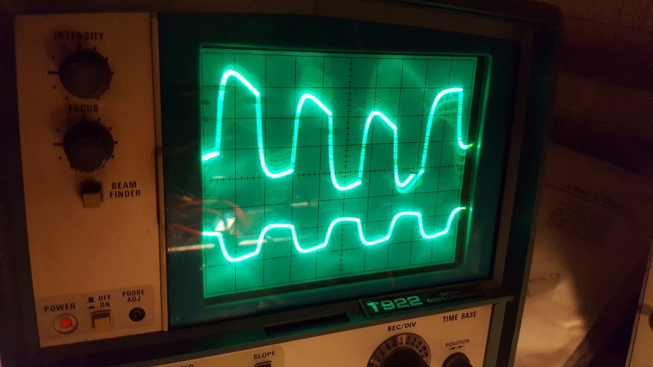

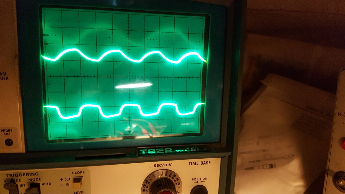

Place the scope across the 1 ohm cathode resistor (noted the ground point) and post the images of waveform for V5 and V6 in dual channel mode if possible. Also HT voltage sage at full output prefer under clipping and heavy clipping and when does the red plate begin? Also the bias voltage when red plate.
The power output is calculated as Output voltage (RMS) sq/load. To convert the peak voltage (on the scope) say 40V peak-peak is 40/2=20V peak, RMS values is 20V*0.7=14, 14*14/8=24.5 rms watts. I strongly advise you install a 150mA fuse on each cathode at least during testing.
In the following the results of the suggested test (in the scope images the trace below is V4 and the above is V5):
1) Pre & Master 12 o'clock
very few red plating in the middle, where plate crossing
Grid voltage V4 -37.5Vdc, V5 -36Vdc
2) Pre 12 o'clock - Master fully clockwise
more consistent red plating, quite more on V4
Grid voltage V4 -52Vdc, V5 -62Vdc
3) Pre fully clockwise - Master 12 o'clock
red plating more than 1) but less than 2), more on V5
Grid voltage V4 -44Vdc, V5 -42Vdc
4) Pre & Master fully clockwise
red plating more or less like 2), more on V4
Grid voltage V4 -56Vdc, V5 -61Vdc

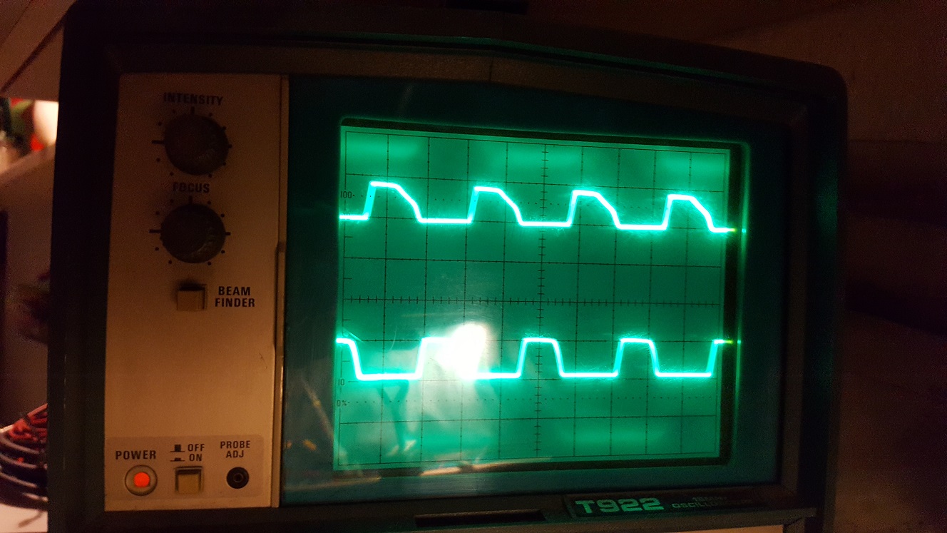

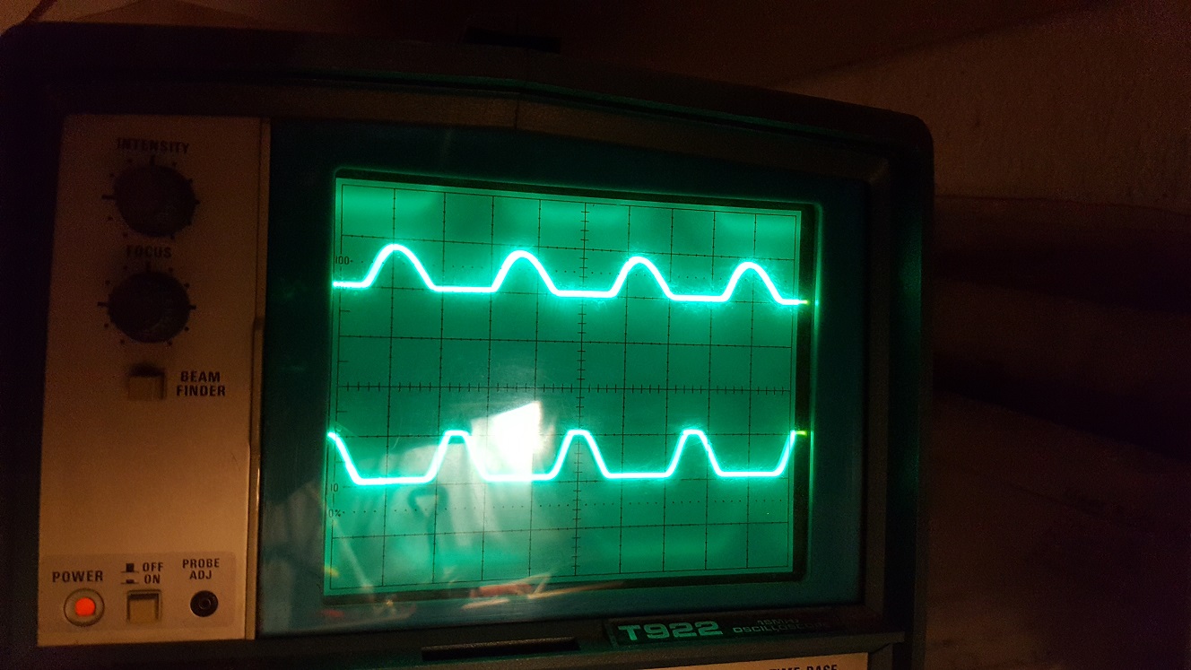

Below you can see the image with triangular waveform before (below) and after (above) the output stage.From the images I saw one tube clipping earlier than the other, so the B+ sag cause a drop in bias voltage some more to the other, making it even lower and hence more tube current and red plating. The tube that clipped earlier has higher transconductance or Mu than the other, unless the PS output is asymmetry. If you have function generator you can check waveform symmetry with triangular waveform before and after output stage.

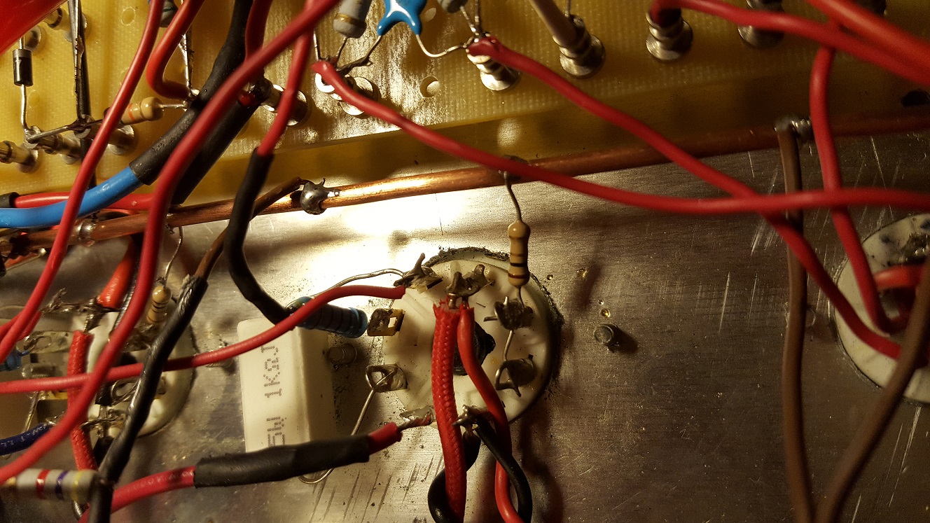

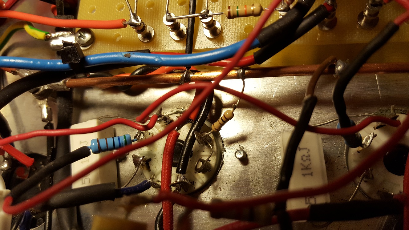

I triple checked the wirings and I quite sure they are correct. Below a couple of picture of V4 and V5.in fact can you confirm that the output tube socket wiring is correct that the screen grids are common to cathode and the suppressor grid 1k's are ok and tied to B+? at this point with all the red plating that these tubes have done they may be cooked!

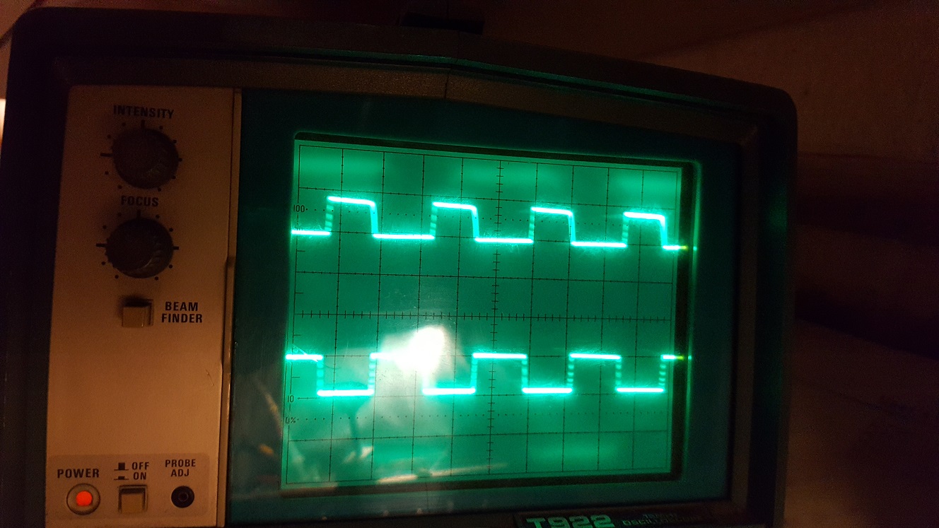

In the image below you can see the input signal to power tubes (below) and the feedback signal (above). They are opposite so I suppose it's correct.the other thing i would look at is the feedback line off the transformer are you certain it from the proper winding and the right phase to produce negative feedback ( if it' wrong and positive that could be what's behind the red plating with increased gain)
I forgot to say that on the scope the image with triangular waveform after (above) the output stage was oscillating a lot.

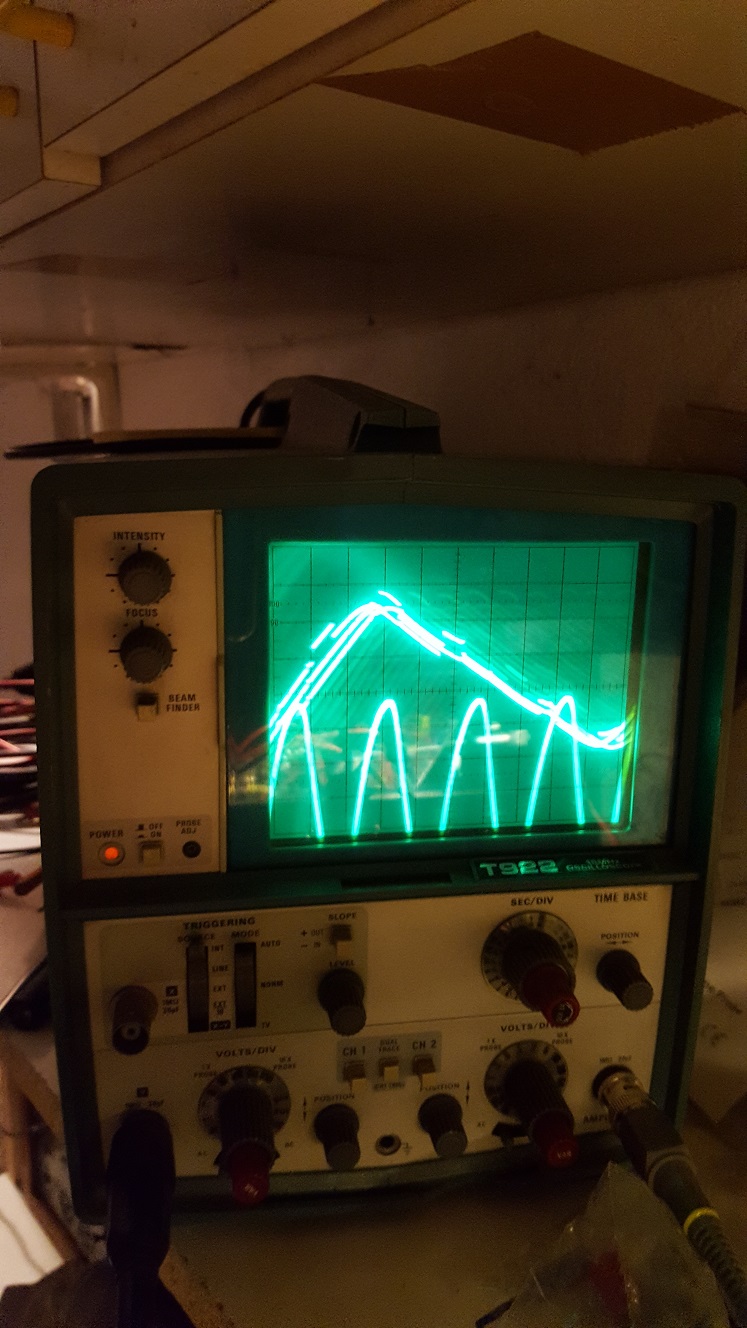

The waveform you used is the triangular waveform, is it? You adjust the tone stack to get more accurate waveform.
From the multiple ghost images waveform of first pic, it appears due the high ripple in B+ supply.
From wavy waveform at top (input), it appears there are some low frequencies, 50/60 hum perhaps, causing it unable to display straight horizontally, so you increase the time base you see it better (or without the input signal).
So you hook the probe on CT of OT to see and measure the amount (between low and peak) ripple voltage under load. Use 0.1uf/600v cap in series if your probe can not withstand 400V DC.

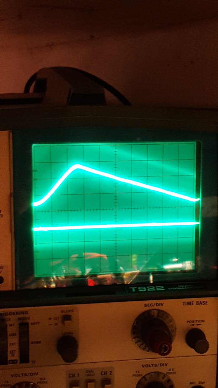

Results of measures on CT of OT (between low and peak):
1) With no input signal and gain/master fully counterclockwise (x10 probe, 0,1Vdc/division, 4 division on screen) --> 4Vdc
2) with triangular wave input, 400Hz, and gain/master fully clockwise (x10 probe, 0,5Vdc/division, 4 division on screen) --> 20Vdc
Frequency (1msec/divisiojn, 10 divisions) --> 100Hz

Yes, I confirm 20 Volts of ripple voltage. What do you think about? Is a value so much greater than usual? Or usually there is no ripple at all? Can ripple generate redplating? Do you suggest to replace rectifier diode (all of them?)? Are there different sources for such a behaviour (ripple)?i wish i could see the waveform in action. (could be diode breakdown happening here)
