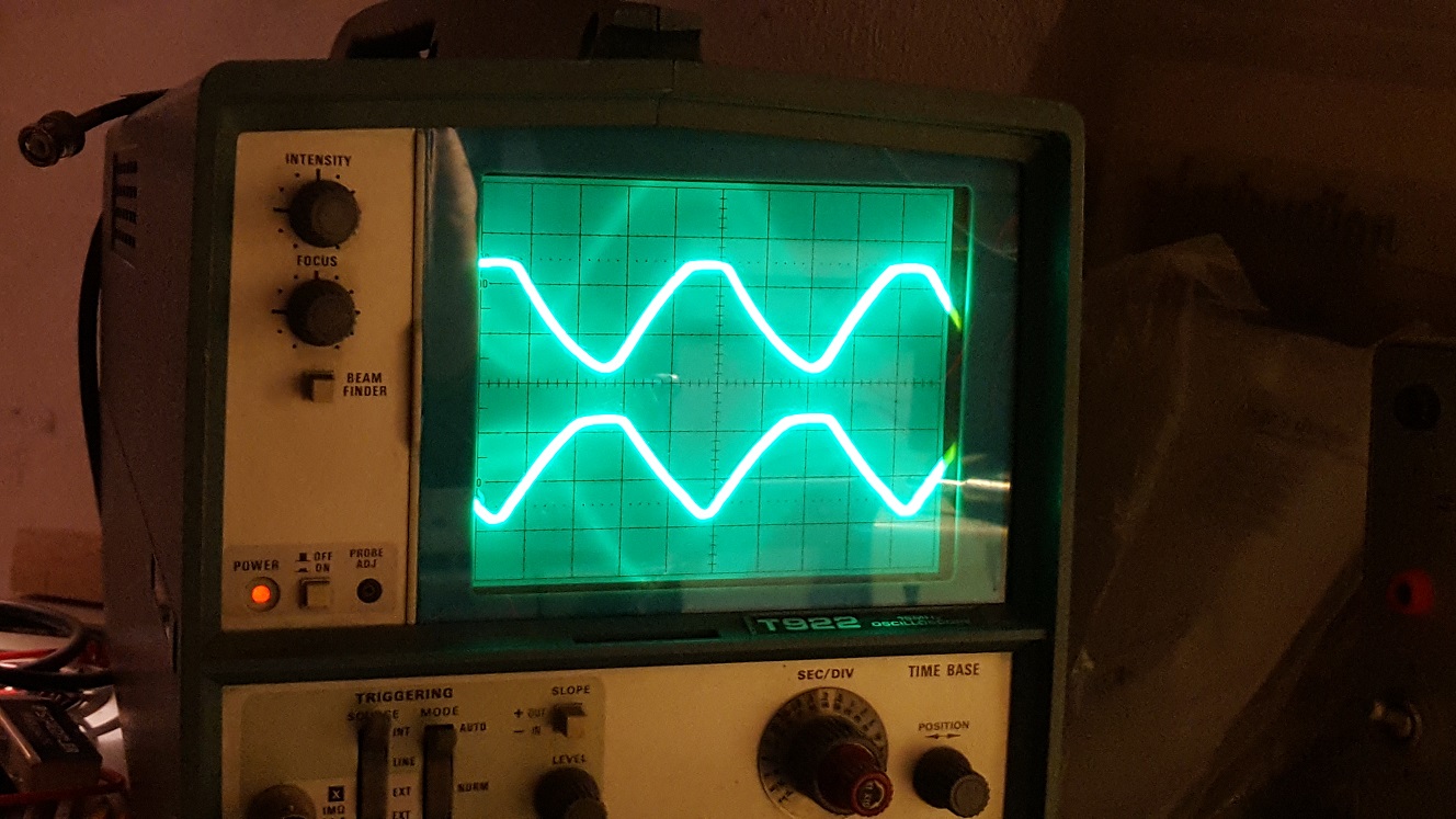

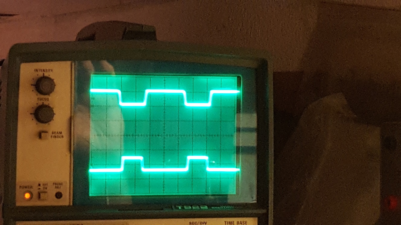

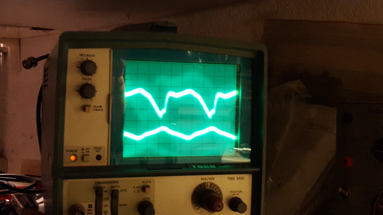

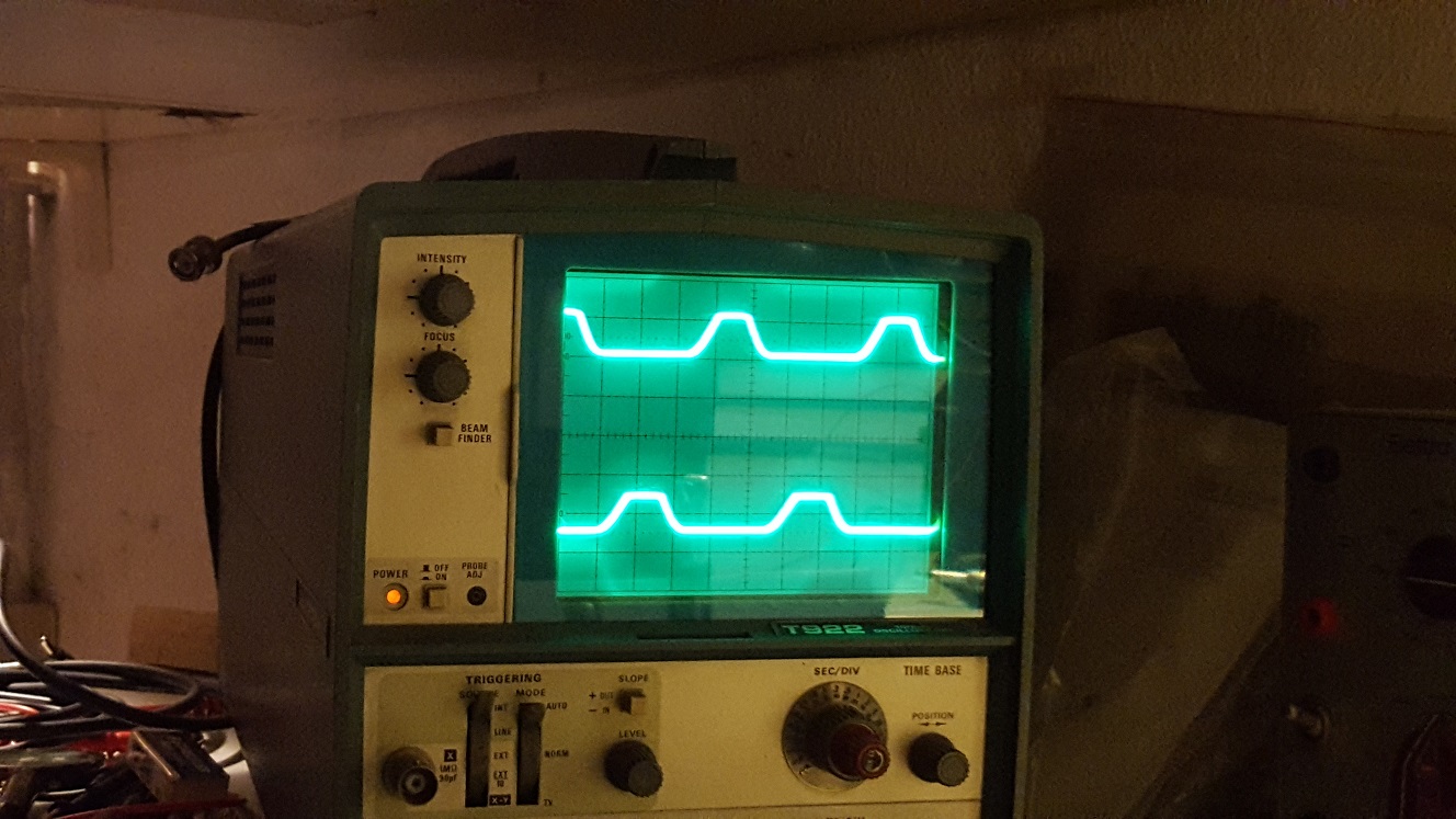

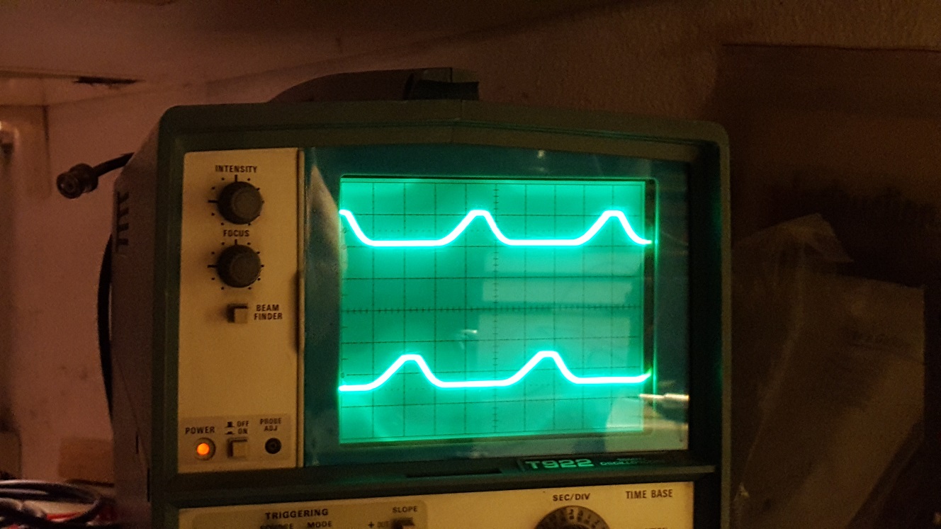

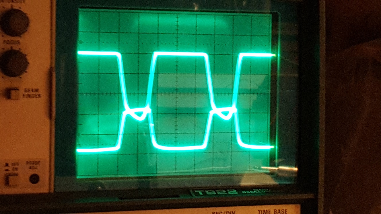

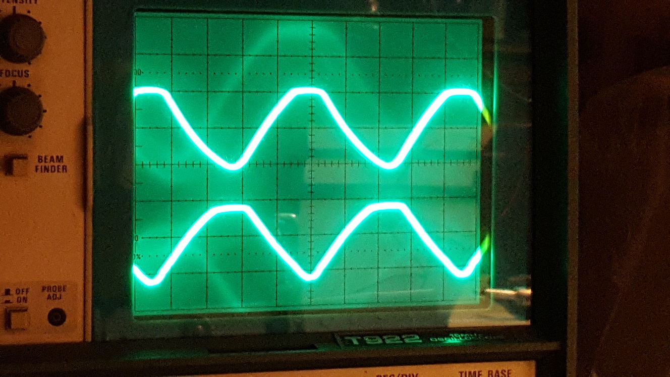

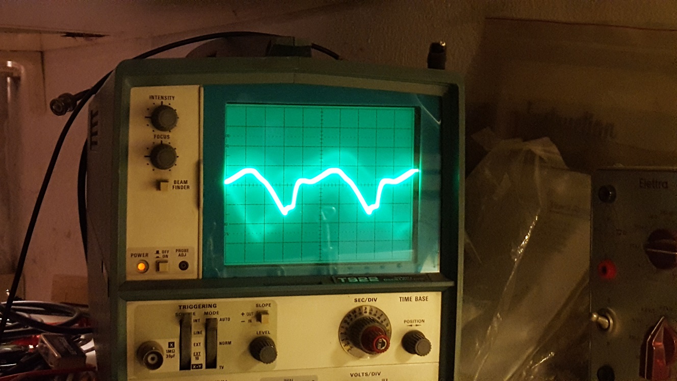

The scope is ready again :) and I've a lot of picture for you:D before starting I've to thank you again for your patience and for your suggestions. You are really kind to dedicate your time to novice like me. So, go ahead.
All what you see in the following is related to an input signal with this characteristics: triangular wave, 100mVpp, 1KHz. The controls are: preamp volume on 5 (twelve o'clock), bass=10, middle-treble-presence=0 --> this settings allow to mantain the wave more triangular than possibile.
All the pictures have 2 traces: V4 is the upper one and V5 is the lower. At idle the two traces (flat) are respectively 2 divisions over the horizontal center line and 2 divisions under it.
I take two series of picture for each case. One with NFB connected and the other without it.

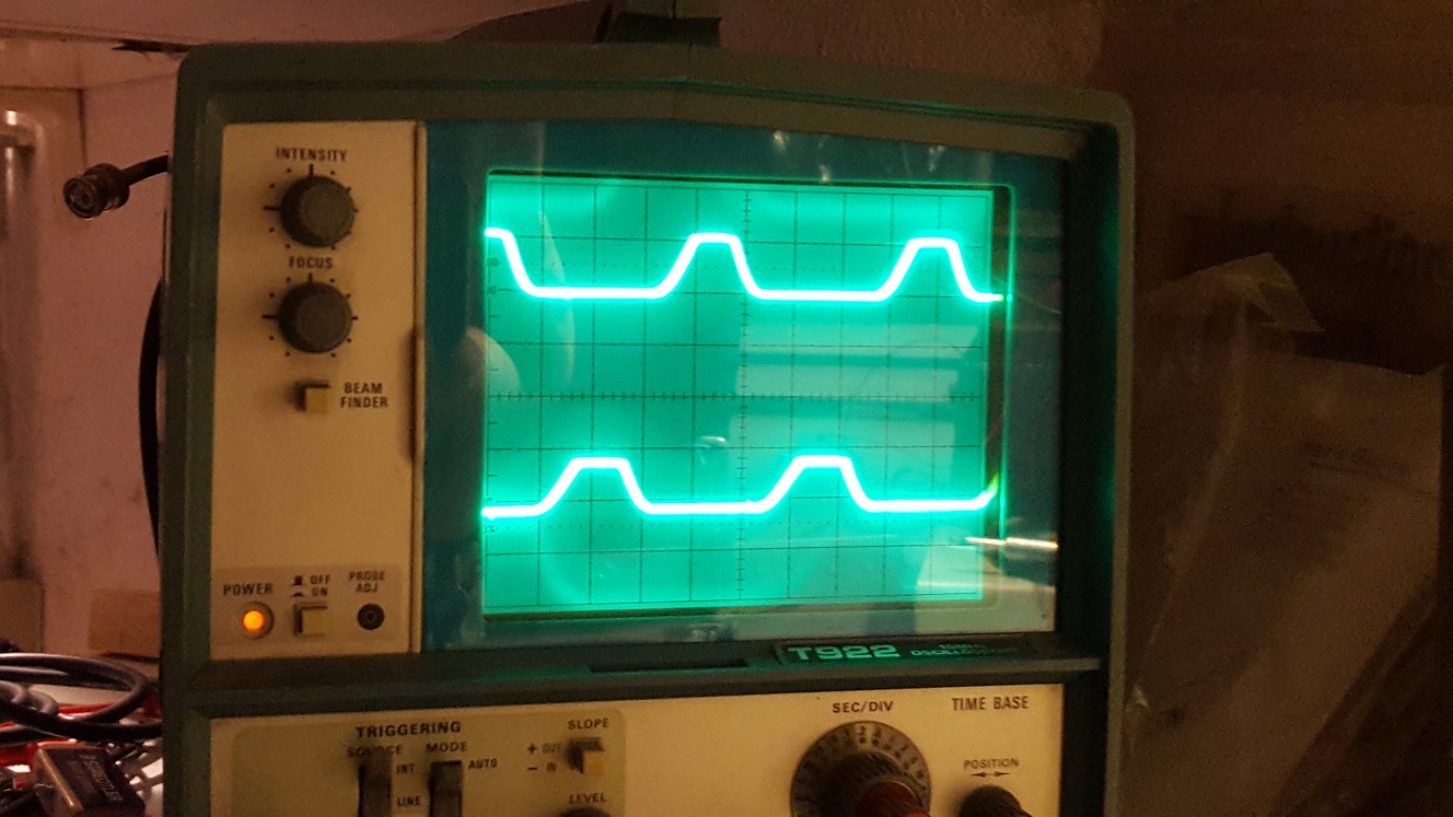

In this first series of pics you can see the output of PI after the coupling caps. I take the pictures with the master Volume in the following positions:
=3 start clipping
=5 (twelve o'clock)
= 10 (max)
so you can have an idea of the evolution.
This is the series with NFB connected:

and this is the series with NFB disconnected:

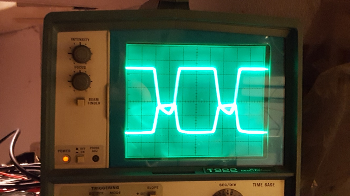

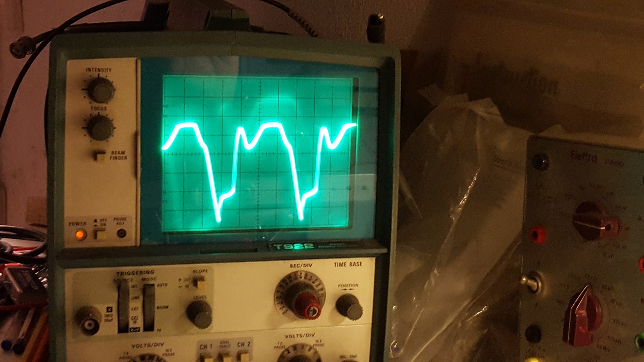

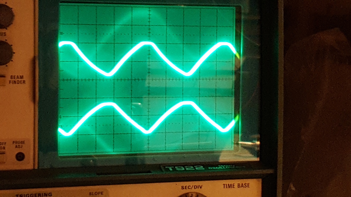

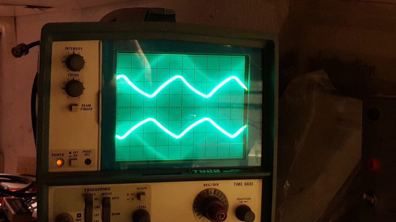

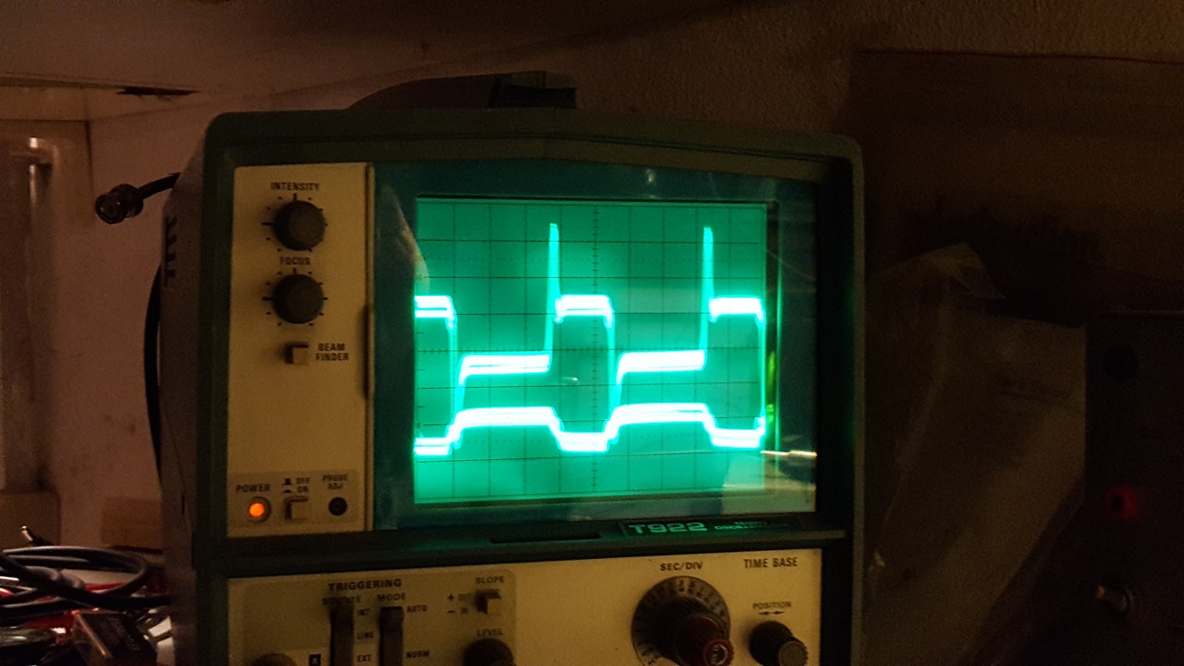

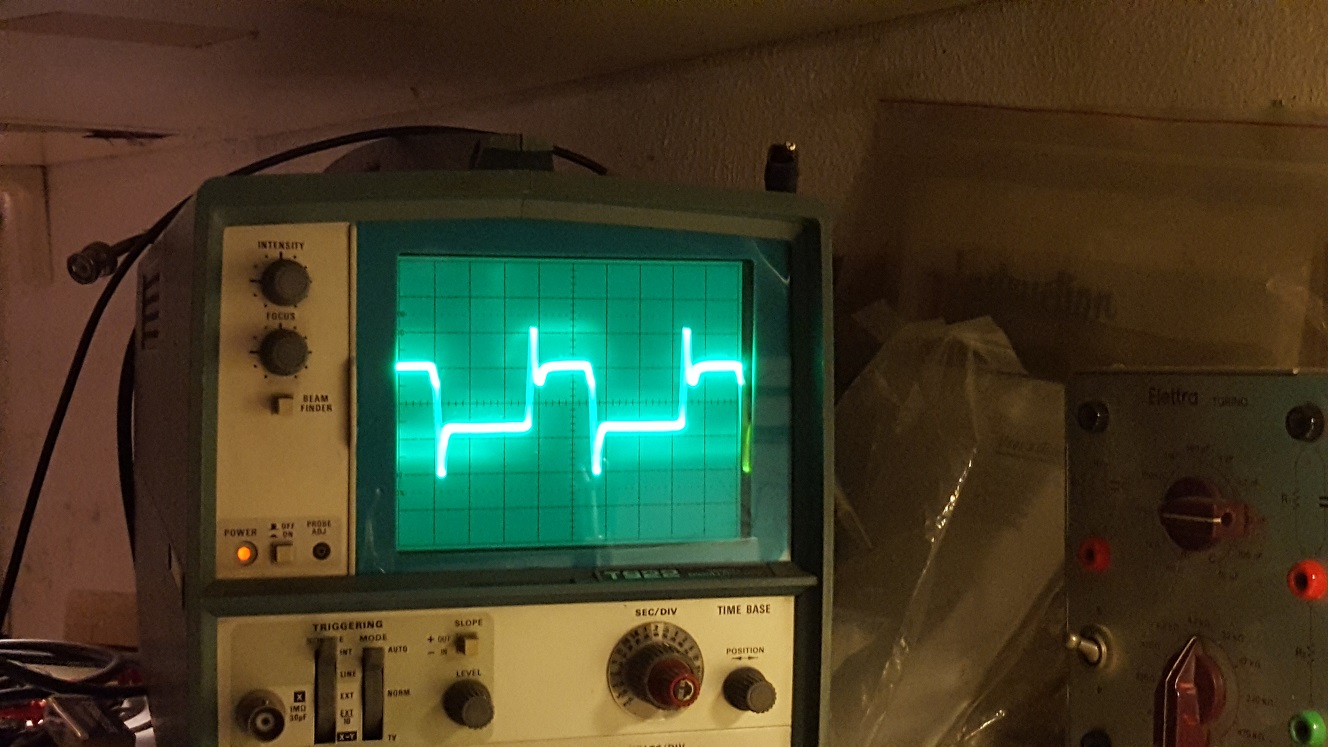

This second series of pics is from pin 3 (plate) of power tube. V4 is the upper one and V5 is the lower. Each series with master Volume in 3 positions:
=3 start clipping
=5 (twelve o'clock)
= 10 (max)

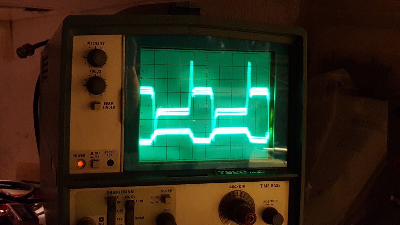

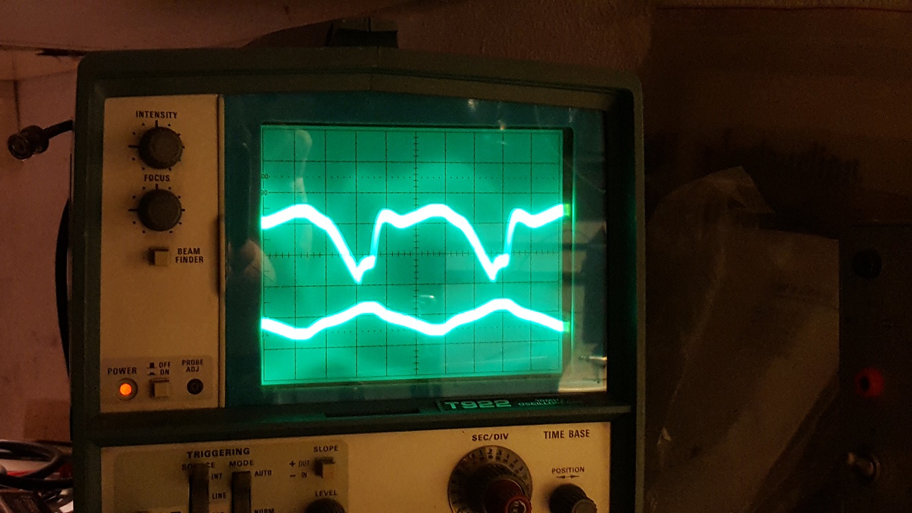

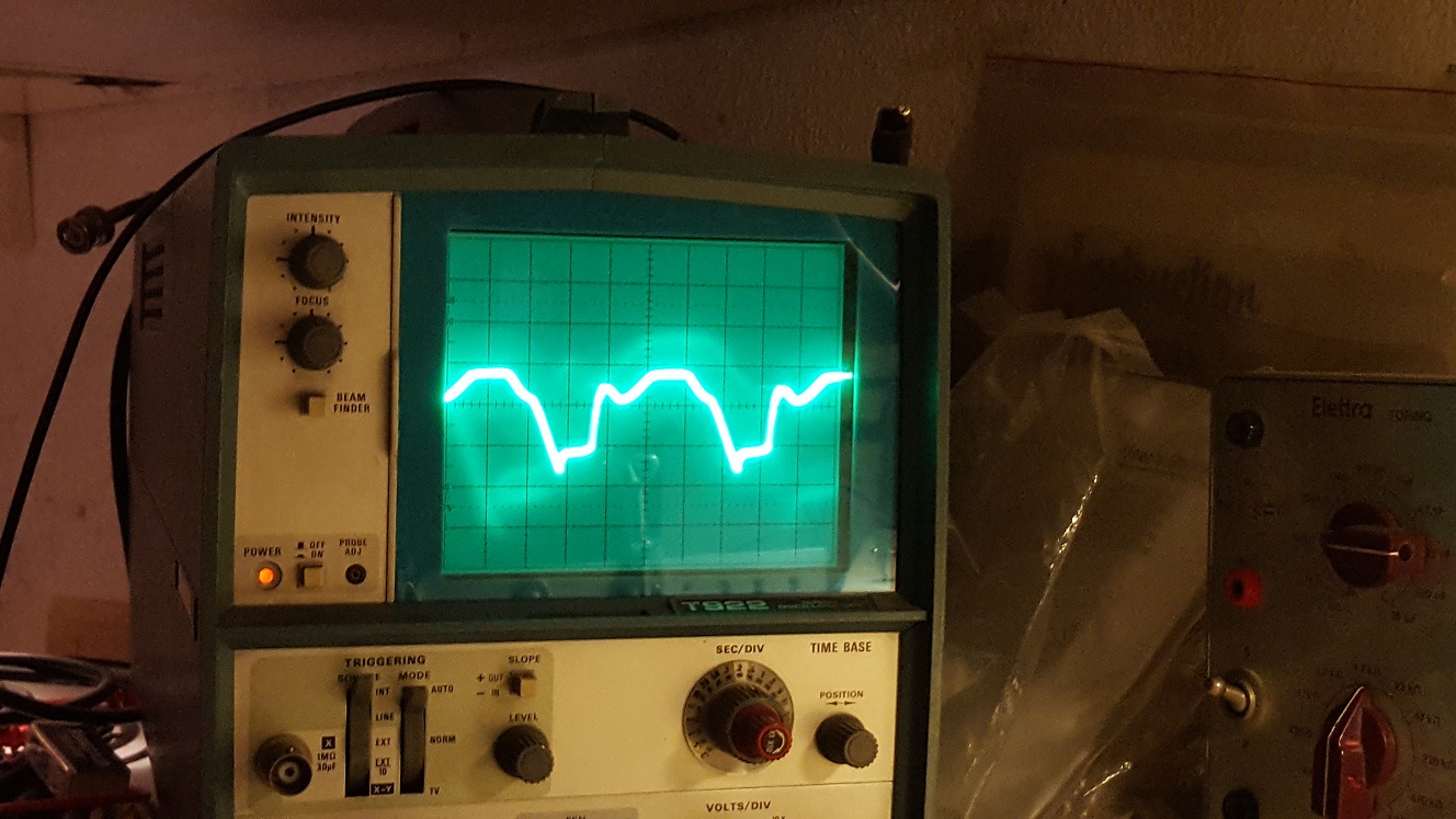

This thirs series is related to Bias. You can see the waveform at taken at the two end of 1 Ohm resistors. V4 is the upper one and V5 is the lower. Each series with master Volume in 3 positions:
=3 start clipping
=5 (twelve o'clock)
= 10 (max)

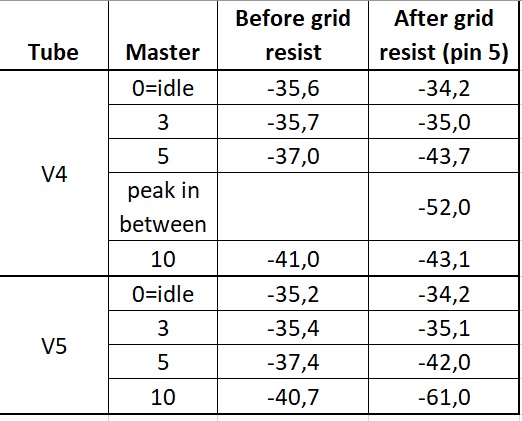

For Bias, as suggested by Koonw, I take also the measures before and after (pin 5) the gris resistors in the same conditions. Here a table that summarize the results:

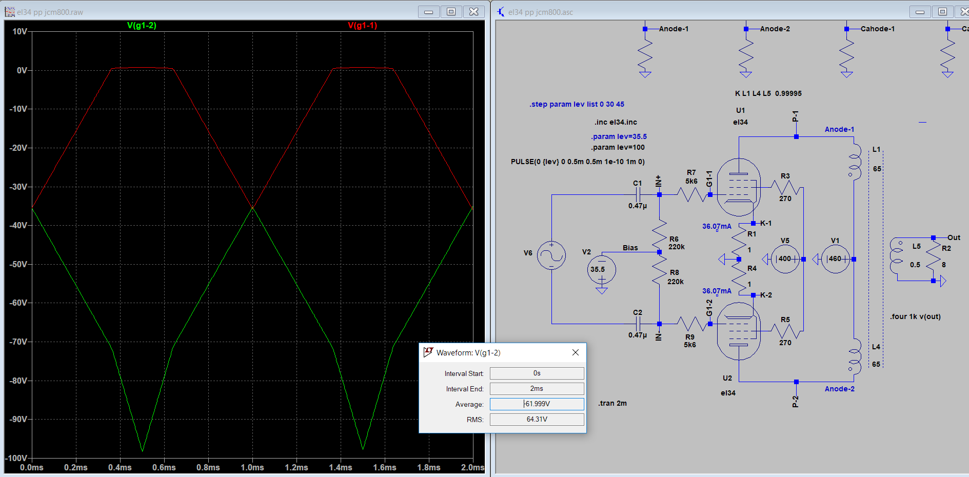

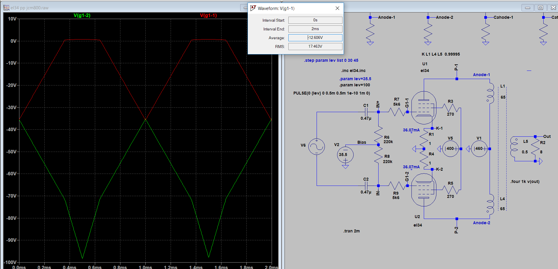

Before I forget, I like to give short reply: Clipping for both tubes should be opposite to each other (as attached). In #108, the 2nd last photos show they are not so. So the driver output must have clipped before the output.
Again in same post last photo show double clipping as the driver output and power stage output both are clipping that form near square wave. So it's necessary to examine the driver output.

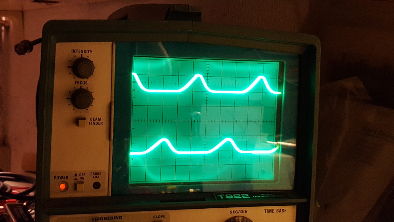

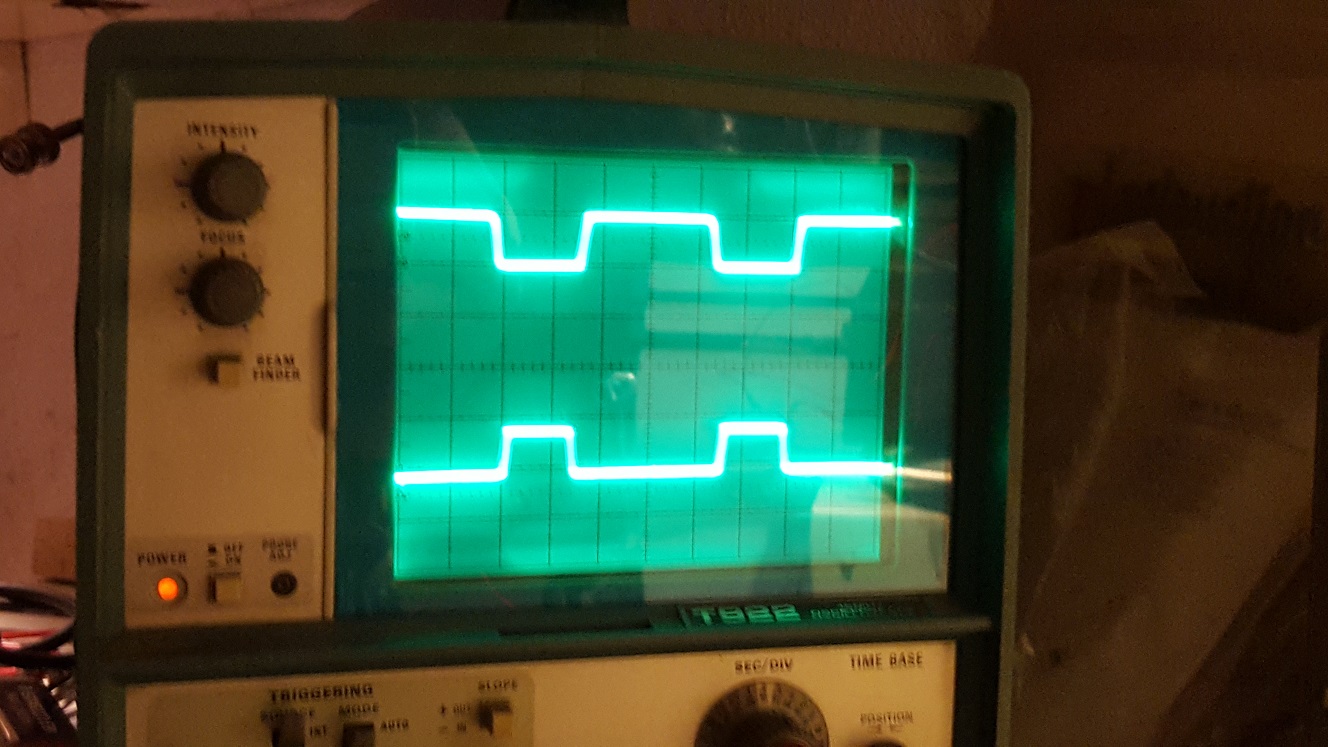

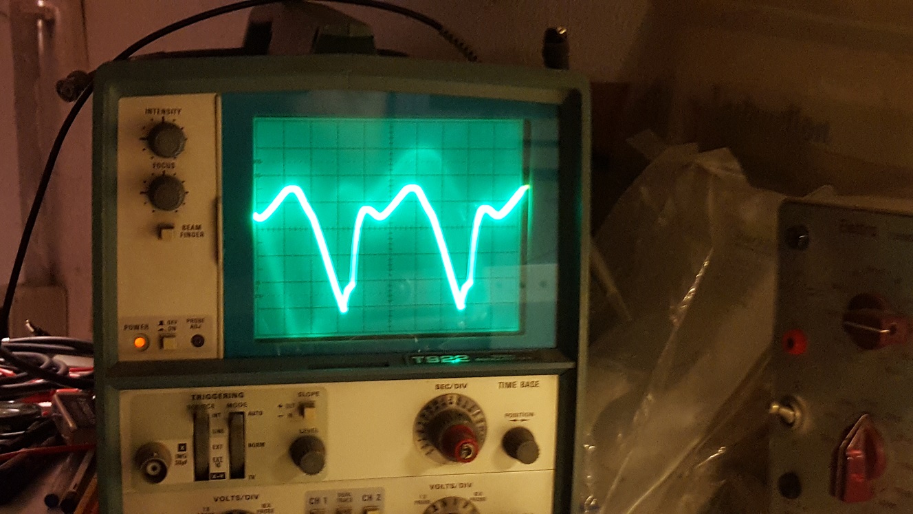

The last series of picture are related to the NFB signal at 16 Ohm pin at the ohm selector and the signal at output jack. Both these series are taken with NFB not connected. For each series 3 pictures with master on 3,5,10
NFB signal series:
Output jack series:

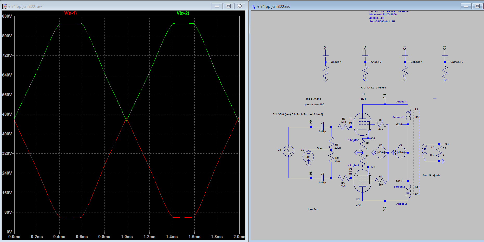

The attached simulation can tell us why the bias voltage measured at grid 1 pin 5 changed during clipping. But the top tube does not quite agreed, it should go more positive, while the bottom go more negative (agreed).
