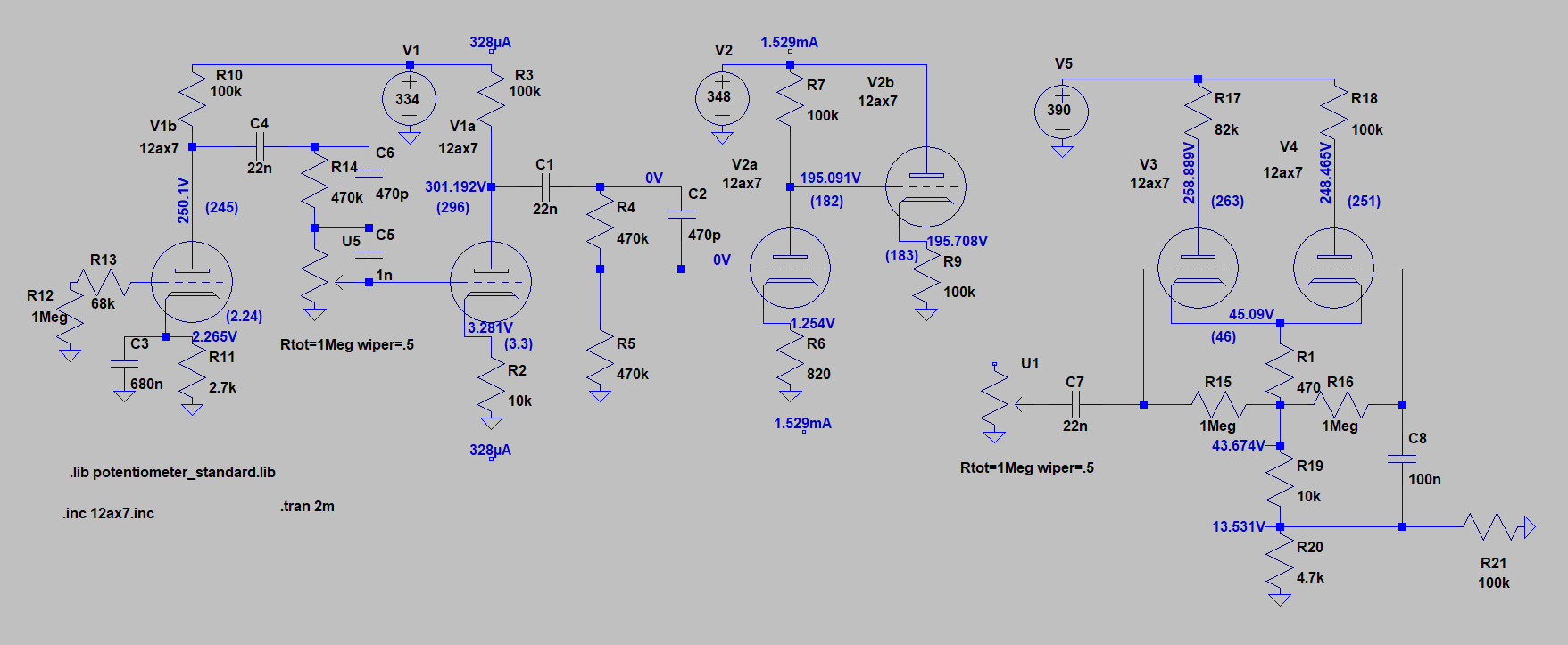

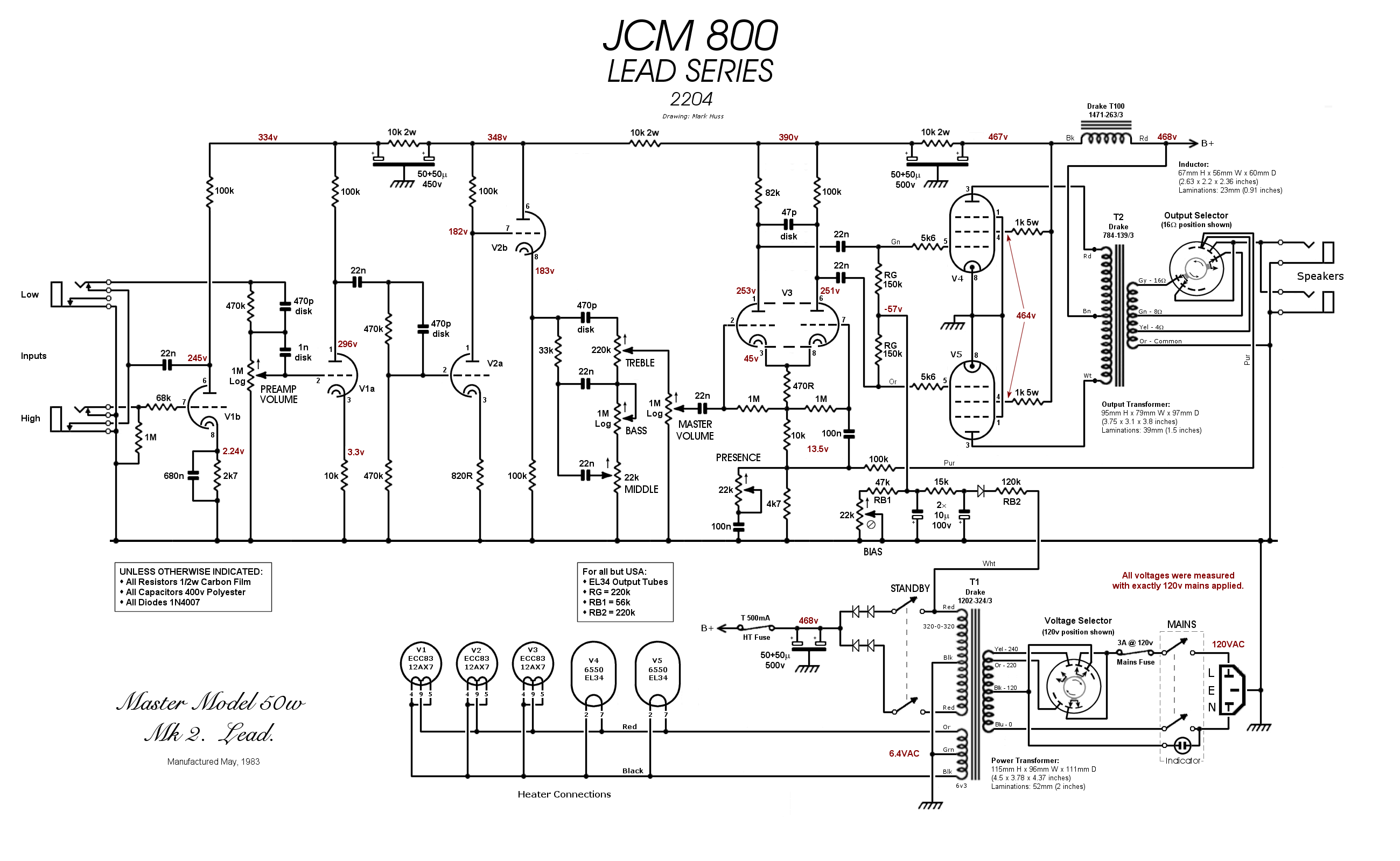

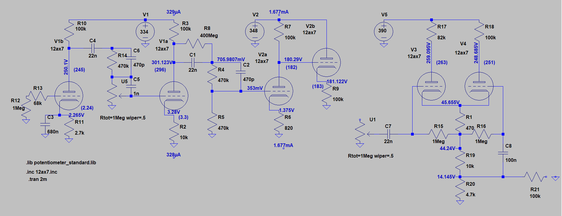

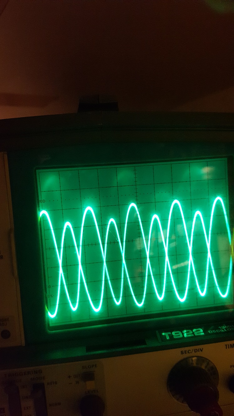

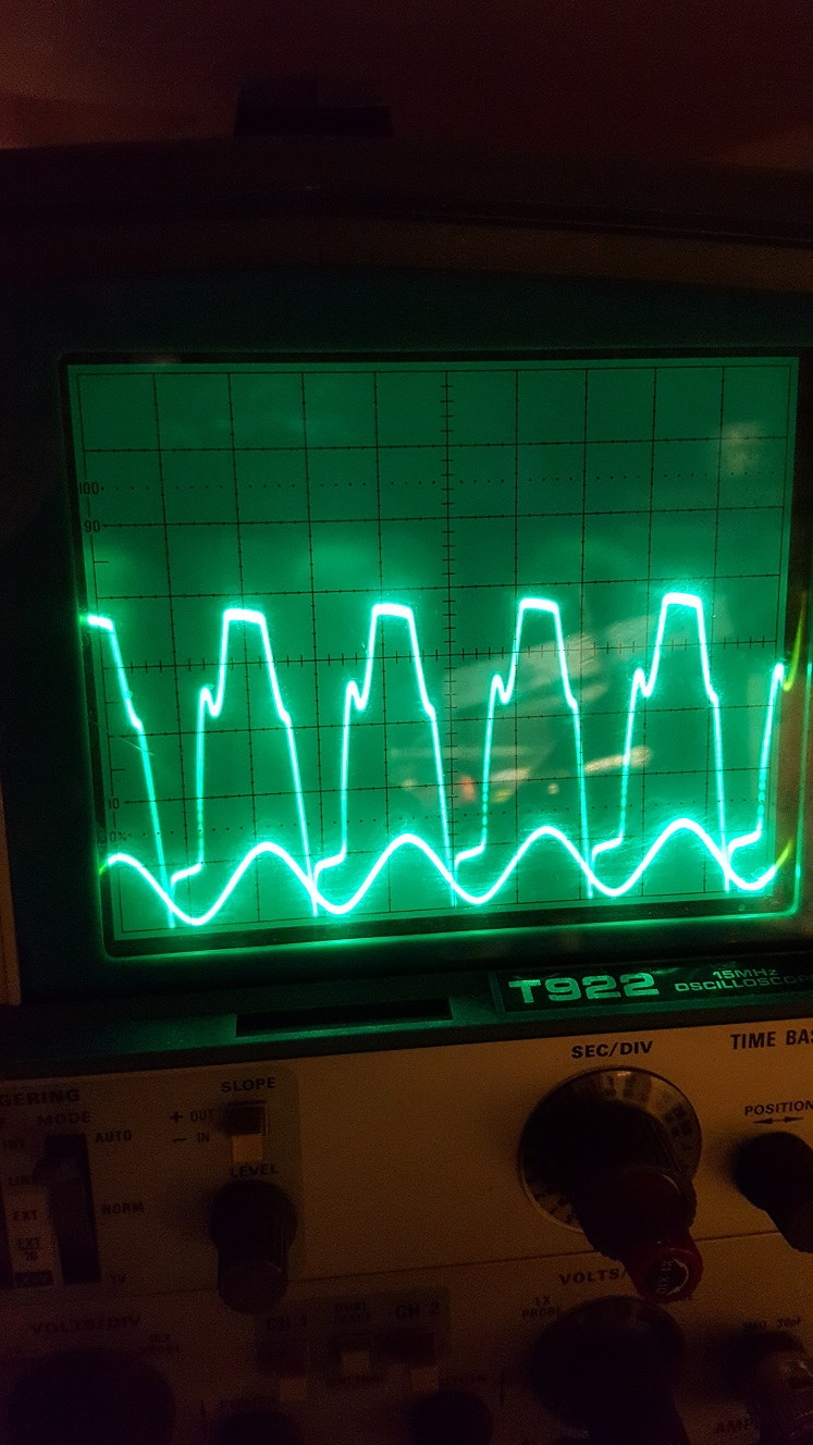

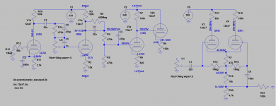

The attached simulation can tell us why the bias voltage measured at grid 1 pin 5 changed during clipping. But the top tube does not quite agreed, it should go more positive, while the bottom go more negative (agreed).
Hello. I'm not sure to understand exactly what you mean, but I had the suspect that the OT may be involved. I pull the power tubes and read the resistance between CT and pin 3 on both sockets (the two windings): they are different.
After that I try to apply a 100Vac to each winding and measure the secondary: 12.4Vac in one case and 9.2Vac in the other. It seems that there is an internal shortage between windings in one of the primary. In your opinion this can confirm the behavior of the amp?
Well they're multiple problems, you have to deal separately. I mentioned before you have mismatched OT or tubes.

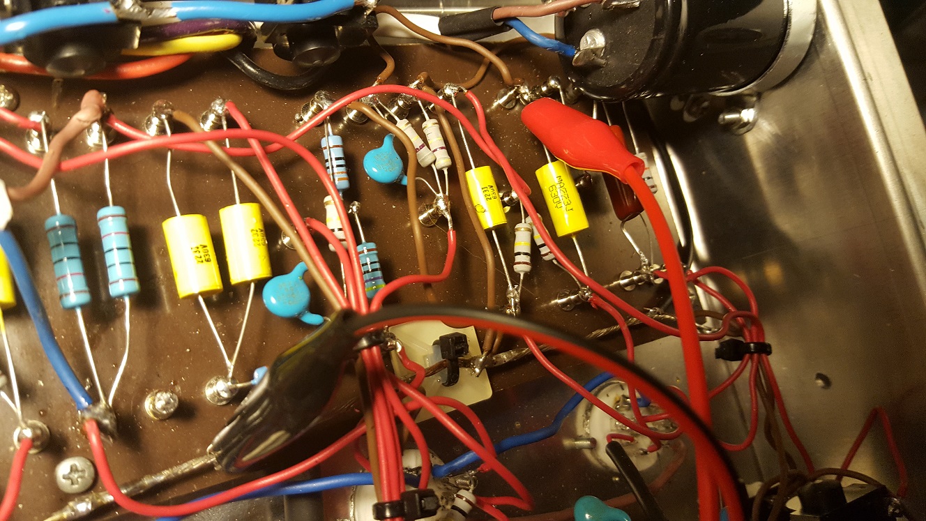

Continuity
Just wondering. When you speak of leaking to center conductive area, can't you get to that area and measure for possible continuity between center area and any turrets.View attachment 705209
I'm quite concerned. Before proceeding how you suggested I try to unsolder the B+ (T3) and mount it in-air to verify if this solve the problem. Nothing changed, I still have 500mVdc at T0. So I try to mount in-air also T3 and this reduce T0 to 250mVdc. Unsoldering and mounting in-air also T2 give a value of 20mVdc on T0 (a good value, I suppose).
But the conclusion seems that every HV turret is involved and the conductive board bring this voltages everywhere. To confirm this I measured the free turrets and now I have 2-3Vdc in this zone (before 15-16VdC) but moving to the right (t0oward the power zone) the voltage raise up to 15-16Vdc in a free turret near the B+ of the PI (now I suspect that the probleam I've on the PI - the difference in plate voltage - may be related to this). I suppose also that the turret connected to ground mitigate the problem. What do you thing about? Any more suggestion?
Hello Spurlte,
a lot of time has been passed from that issues, but I remenber I tried to do so, but without success. The leakehe seems to appear only when HV was applied. The low voltages that a meter apply to measure the resistance probably don't generate the leakage itself.
Have happy Christams holidays.
Ivan
