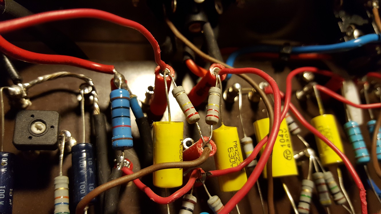

also what's with the nasty looking ground buss strapped to the board that i see in the pictures.

Hello Koonw, we are here again. Yes, I can try to do what you suggest, but if the problem in effect is the board I've to insulate near anything that can have a Voltage greater than few volts to have a good result. In this case is not better to unsolder all and transfer to a new board? Probably is faster and the result could be better and more sure. What about bakelite I mentioned in my previous post?
I can't understand why your board is so conductive, please read this for some clues. If the board has been anti-static treated, there will some leakages. But I also think such coating is not permanent and can be removed or cleaned by some strong solvent (turpentine?).

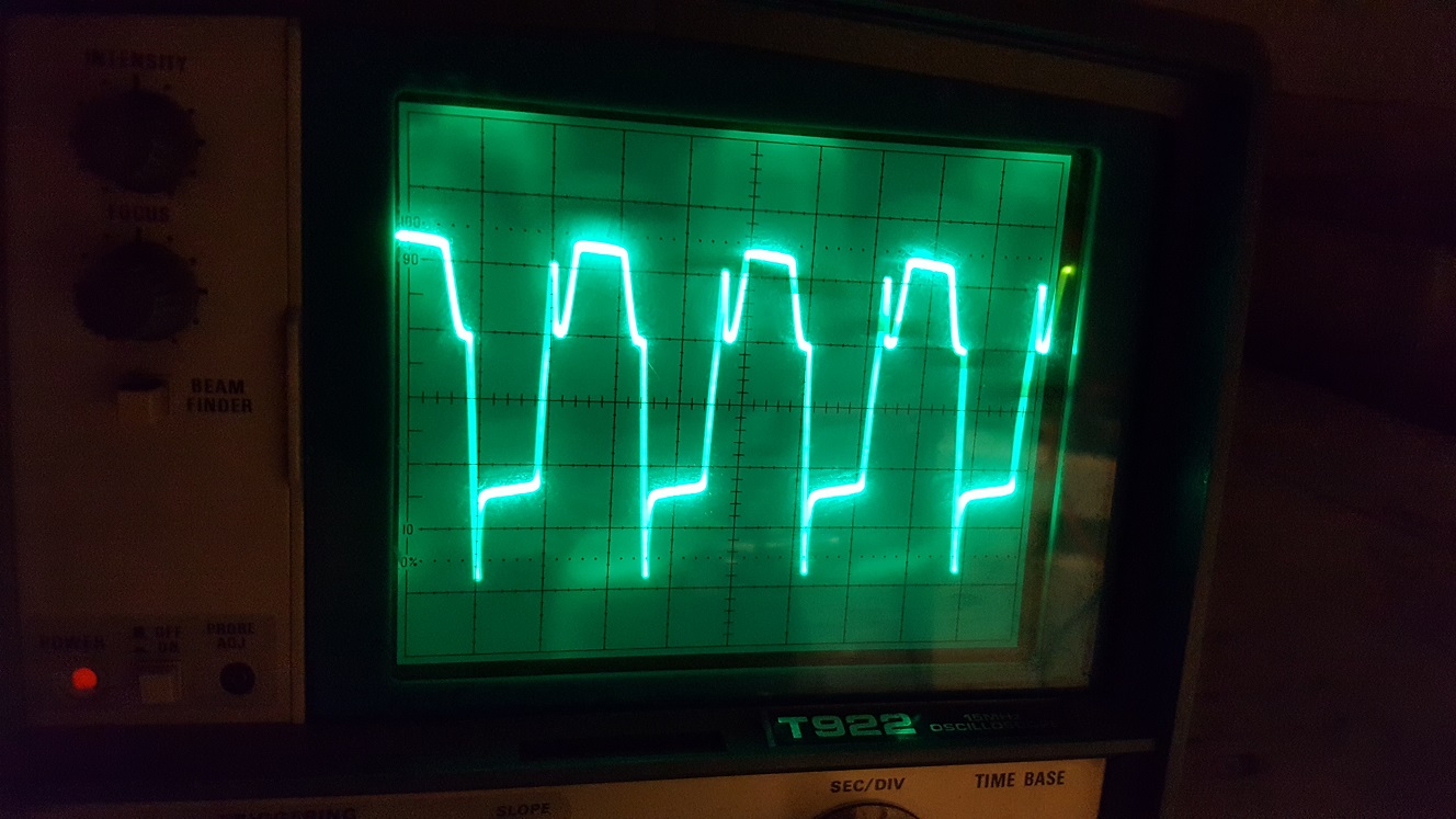

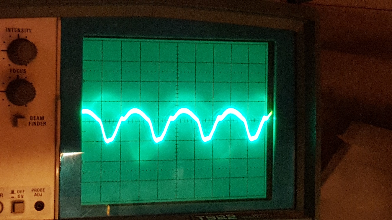

As further information I take a picture from the scope connected to speaker output, with a signal of 100mV, 400Hz, sinusoidal applied to High Input, gain (pre) on 12 and master volume fully clockwise.

turn things down the levels are way high for even test purposes and that scope trace shows some ringing so yes capacitor troubles (random re-capping can create more problems sometimes)

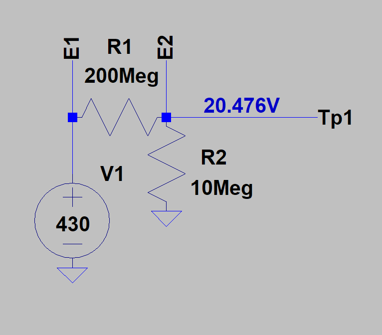

In some case only a Megger (500V & above) can measure the insulation resistance correctly, an ordinary DMM can not (always 0). What is Megger Test and How is it Performed | Carelabz.com

I did a Megger (ZC-70) test of blank eyelet board, the insulation between 2 eyelets is about 200 Meg. The HT is 430V and with DMM of 10Meg, I measure about 20V, which agreed with sim or calculated result.

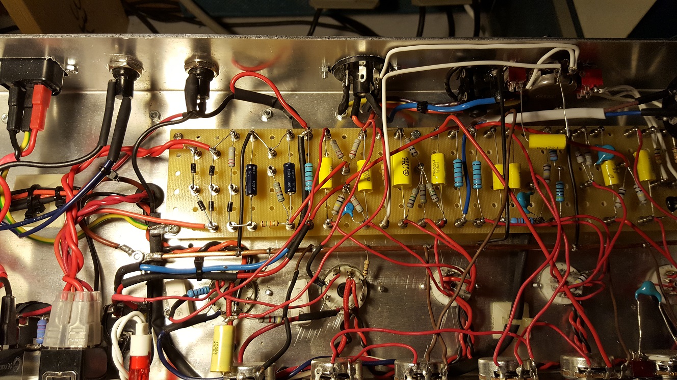

Hello everybody, and sorry if I was not present in the last few days.
I use part of this time to substitute the board, and at same time to make some improvements (twisting of 6.3 heaters, they wasn't - aligment with th e original Marshall JCM800 schematic bacause the first one I originally posted is not completely correct) and a few mods (resonance, switchable cold clipper, switchable bright cap) - in attachment you can see the new layout.

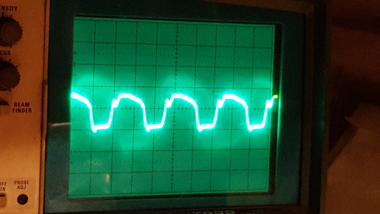

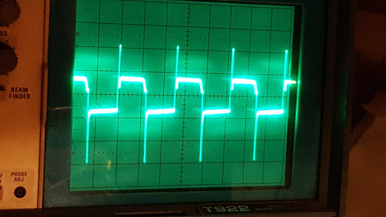

First test: I applied to the input the usual 400Hz, sine wave signal, and the images at output jack are the following:
1) with both preamp and master 12 o'clock
2) with preamp fully clockwise and master 12 o'clock
3) with both fully clockwise

I saw the picture of the new board is not visible. It's here:

No need to send to me the old board as you have reveal enough details. I like your new board, I see got extra holes drilled on them. Your old board, like mine maybe FR2, which has less insulation resistance than FR4, but better heat resistance.
