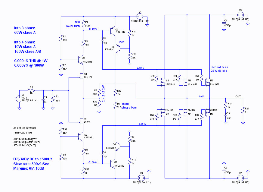

There you go Jeff you figured it out .........now replace the VAS mosfet's with high beta bi-ploar transistaors and run the sim and see what you get. Then you should be able to make a choice.

Thanks, Mark, but those are just SPICE stand-ins for 'E' grade KSC3503s (hFE 100 ~ 200).
I have no idea where either SPICE model sits, but the range for all grades of KSC3503 is 40 ~ 320 while the KSC2682 is 100 ~ 320, so it seemed a better fit to stand in for 'E' grade parts.

Jeff
I have no personal experience running bipolars using zero degeneration (it's usually reserved for mosfets), generally speaking the temperature coefficient of a bipolar wouldn't allow you to be able to do it. This will also cause problems for your output stage biasing circuit. It would be best to have the biasing circuit independent of the vas stage.
If you have the bipolars mounted on a huge heatsink it might work.

How about a KSA1220 and its complement KSC2690?
Jam
They look good on paper, but the higher Cob nukes my phase margin.
I'm sure there's a compensation method to address that, but it would appear to be above my pay-grade.

I have no personal experience running bipolars using zero degeneration...
Ahh... no, that wasn't intentional. I just forgot to put it back when I switched from a MOSFET to a BJT.
How do I calculate how much degeneration I want?

One noticeable difference between the amp examples in Self's book, and the amp examples in Cordell's book, is the (lack of) emitter degeneration in the second stage called VAS. One book seldom/never uses it, the other book always uses it.
Is one of them "100% right" and the other "100% wrong" ? I doubt it.
Particularly when the stage is loaded by a current source, you can fairly accurately work out its gm using a calculator or pencil+paper, in both cases. And that's what you need for stability computations and for open loop gain.

I noticed Papa generally goes with the inverse of the transconductance at the operating point on mosfets, maybe that rule is also a reasonable starting point for bipolars.
Eg If the transconductance was 0.5S at the operating point then a 2 ohm resistor, if it was 10S then a 0.1 Ohm resistor.
Try 50 Ohms and throw a trimpot in parrallel and see how low you can go before the bipolar starts thermally taking off, once you know where that is replace with fixed resistor.
If you go with a single ended VAS with ccs, you can probably go the fearless route.

pico has it .......de-generation is key..............especially with bipolars and their higher trans-conductance.
It think the basic topology is sound, the magic is in the details and optimizing the circuit. this separates a good amplifier from a great amplifier.
Some suggested ares to look at
1) De-generation and where to use it.
2) Optimizing the cascode circuit
3) Choice of bias circuit
4) Choice of output stage
5) Power supply
6) Protection circuit (if required)

Cordell uses Re = N / gm where the number N is usually much greater than one. But is this choice "100% right" ? I doubt it.
I brushed up on Cordell again and his rule of thumb is to have the total effective emitter resistance be about 10 times the intrinsic emitter resistance at the operating current.
So re' is 0.026/Ic. My sim currently has the VAS running at about 25mA. (I assume this is reasonable?)
That gives me an re' of ~ 1, an (Re + re') target of 10, and an Re target of 9, give or take.
