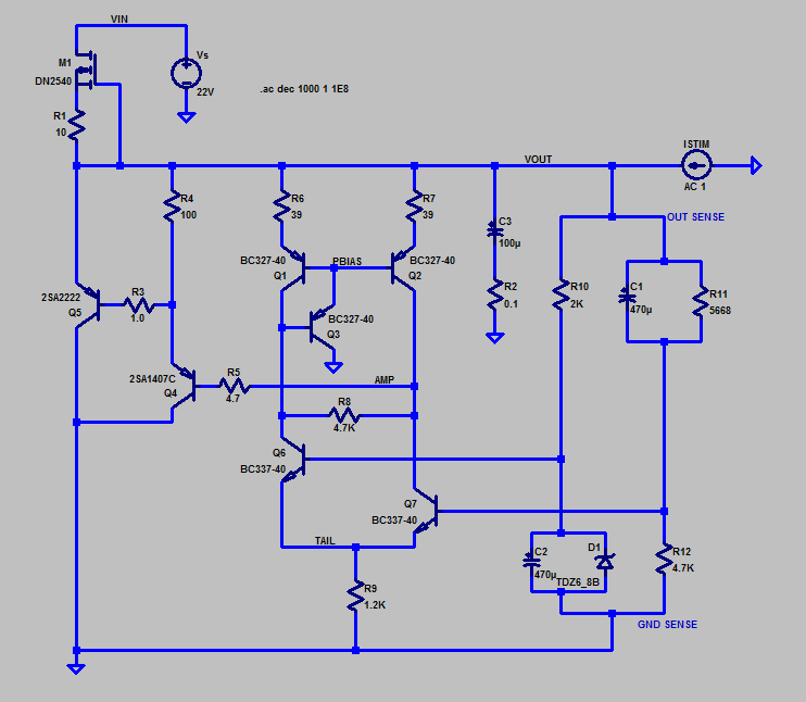

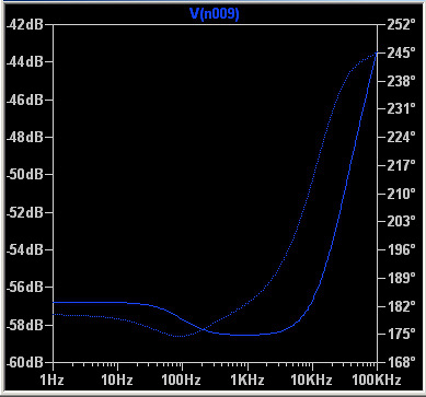

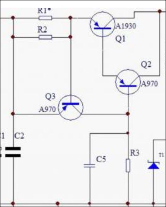

Is it as simple as running an AC sim with the input on the power line?
If so, this suggests I'm good up to 77kHz.
I assume I only need to worry about up to, say 48kHz? Or do I need to cover the amp's entire bandwidth?

That was Beefcake. JamJar's PSRR isn't nearly as good, so it probably needs the CRCR pi filter....

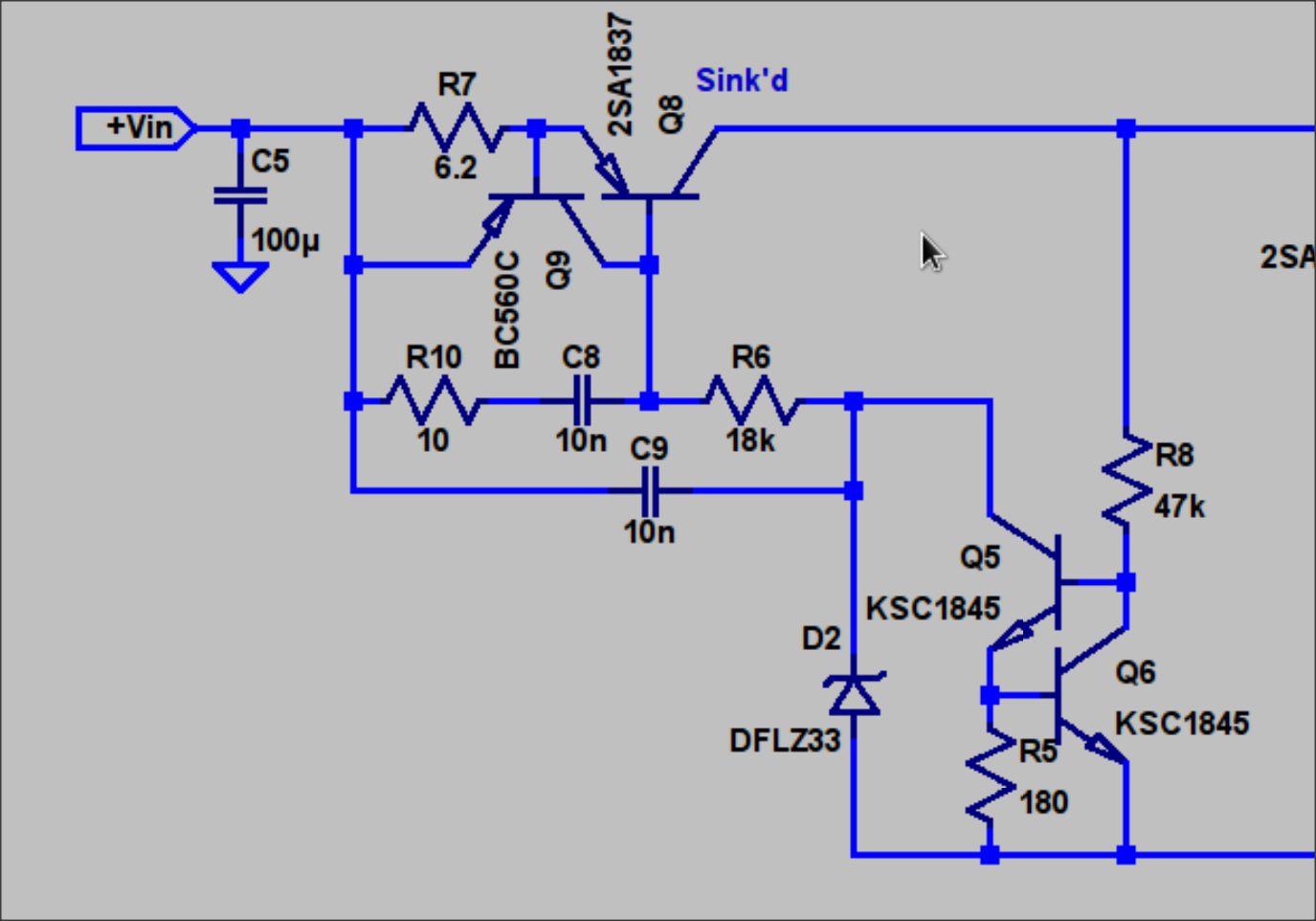

You're forgetting the CRC supply that is upstream of the regulator.
It will be better than this.
The focus should always be to remove the rectified powersupply ripple and it's harmonics.
Worrying about what is happening above 15kHz is like worrying about buttering your bread with a stainless steel knife or a silver plated knife.
Having said that it isn't hard getting good performance up high.
I much prefer feeding the shunt with CRCRCRCR etc than a Constant Current Source
You could remove the CCS feeding Jam's circuit and put in CRCRCRCRCR
