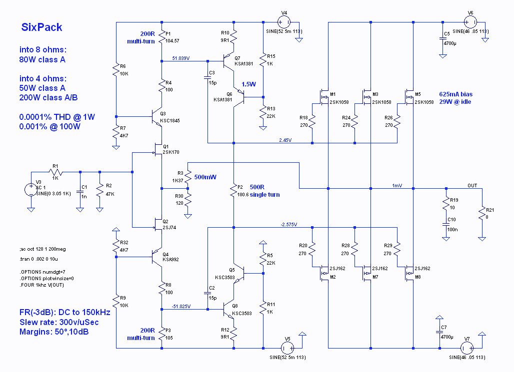

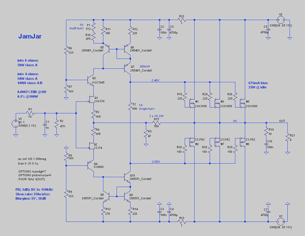

I've made some preliminary topology decisions to get Pico out of his funk. 😉
I'm going to build two. The cascoded push-pull version will be renamed SixPack and go up against Beefcake.
The current-mirror version gets to keep the JamJar name, but now that it no longer needs to go up against Beefcake I can make some changes to address the Early effect in the VAS. I've dropped the rail voltage to 36V, and swapped 2N5401/2N5551 into the mirrors (which have relatively high Early voltages).
Still noodling on the bias circuit (TL431 vs. simple trimmer) and some other details.
As always, comments welcome.
Jeff.

Jeff, I am curious to know, what do you and LTSPICE estimate for the gain of the first stage in the resistor-load amp "SixPack"? Specifically the AC analysis ratio V(Q7base)/V(ampinput)?

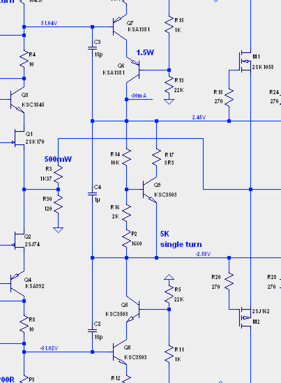

My choice of bias circuit, for consideration , one of a couple of options but for mosfets a simple Vbe (one transistor) suffices. I am not much of a fan of the TL431, it works but sound wise ........I did not use it in the HPA-1 for a reason.
More-or-less unity. Should I be looking for some gain there?

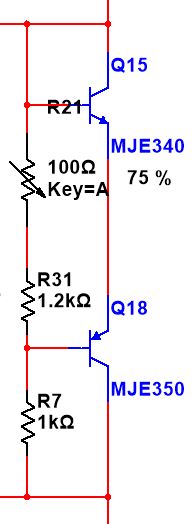

No resistor from B to C on Q15?... My choice of bias circuit, for consideration ...
...I never did square that circle...

If the first stage's gain is ~1 then all of the amplifier's gain comes from the second stage. Will that be enough?
Also, the second stage's noise contribution is divided by the first stage's gain. Since the first stage's gain is ~1, the amplifier will be noisier.
