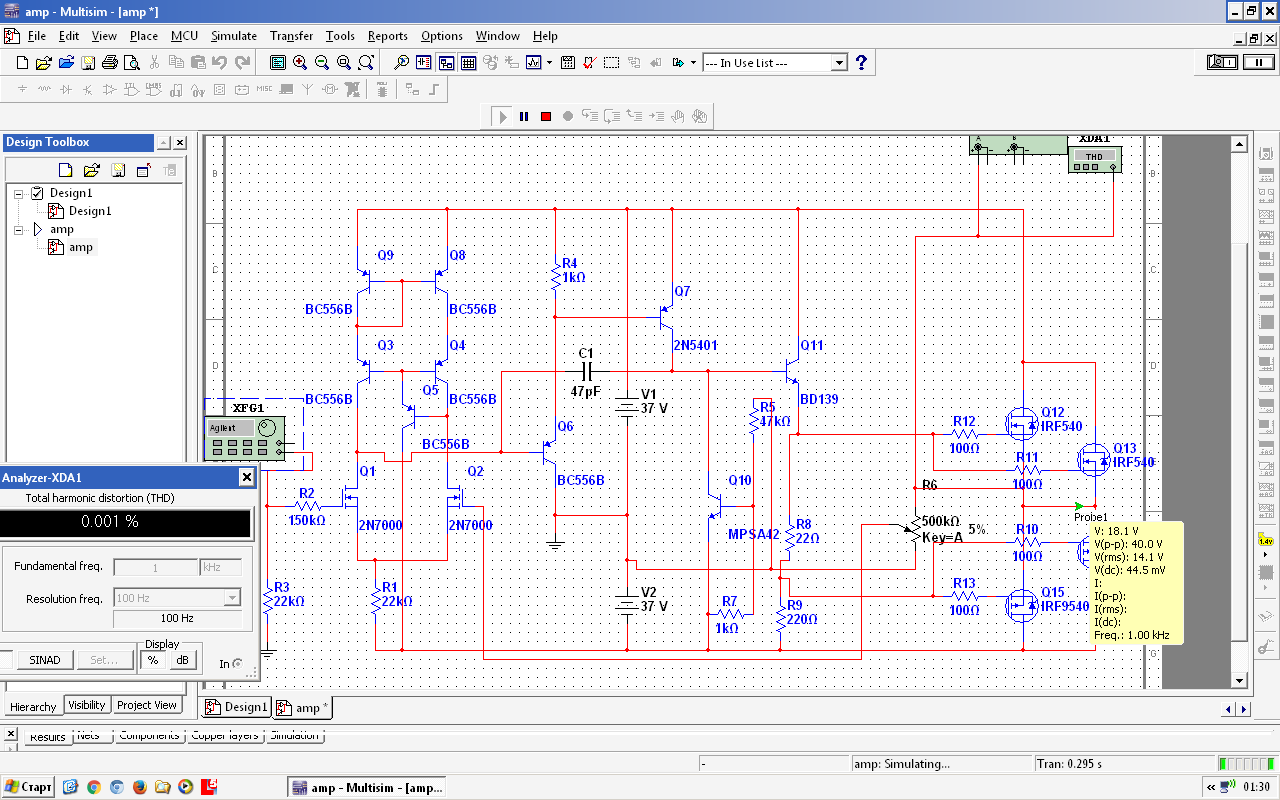

Is this good ?
Hi there :hohoho:
i was mistaken the vbe connection, now better now.
thd dropped to 0.001
there is 64khz oscillation at the output but its not visible on the scope at all.
Note: there should be dc decoupling cap @ the output because at high temps vbe forces to the one side instead of regular vbes to the middle.
I think its possible to omitt the vbe and using Q11 (two functions) mounted on the heatsink as Vbe

mosfet54,
maximize the use of your multisim, use the grapher function there embedded more analysis of your circuit...ac analysis, bode plot, transient, fourier, open/closed loop response etc. It'll help a lot than just displaying the THD window.
BTW There are 3 ways to get the THD in Multisim, via display window, via grapher function-run transient analysis right click on the wave - choose click fourier, via grapher function-scroll select fourier - a table of harmonics will be shown.
Hope it helps!

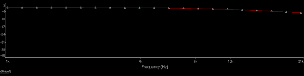

Thank you abetir, Here there are:
including zoomed AC analys + zoomed 64khz oscillation
its very small and i dont think its problem 😕 :snoopy:
Its <200nV

Firstly I tested without load..
Here is updated sch and updated test.
:magnify:
i think i used badly the vbe in the 1st sch and omitted it in the 2nd.
i think there's no need of vbe at all because of the NFB correction.
its impossible to get thermal runaway because FB always corrects this. correct me if im wrong, if i am -> will add sziklai drive at the output and vbe instead class a low impedance stage.
p.s. No No, Im too stupid will add BD139 high power VBE but only if NFB cant correct this 😀
AC analys is similar.

No, check datasheets for 2N5401/2N5551: Fairchild Semiconductor - datasheet pdf.
Your threads seem to be more about you learning to use software properly and doodling an amplifier design. Simulation can't teach you much unless you begin with a solid knowledge of the problems with vertical Mosfets (hexfets) that aren't covered by simulation. You aren't making sense with efforts so far, so how about reading up on basic Mosfet Audio amplifier design requirements first, before scribbling out more flawed circuits. A cheap Ebay kit is a great start to learning how Mosfets work best and the way to achieving better things.
There are a lot of amplifier designs posted on beginner level forums everywhere. Very few will work for long in the real world at the rated power suggested, so please don't assume that anything a simple simulation shows to have low THD, is going to work properly. We are always interested in circuits that work but they need to be proven reliable by realistic load testing or proper thermal modelling first 😉
If you don't usually read authoritative books or papers like Bob Cordell's, at least begin here: Using HEXFETs in High Fidelity Audio

To the original question, 'is this good'.., the answer is NO.
Still no idea how to design a properly biased output stage, and I would bet my private parts that you have no idea why Q8 and Q9 were there (so you removed them later) in the first place, which is what happens when you copy other's designs without understanding them. BTW was your BD139 from the first and second schematic heat up a lot? I so wonder why....
You keep looking at things like distortion without looking at key points in your schematic to see if currents and voltages are behaving properly and what happens when say, the amp goes into clipping, or the power supply ripple is high. Somewhere in there is the reason why your output stage would self-destruct if used under continuous high output. Also, simulated Vbe multipliers often do not work the same in the real world, neither do distortion figures...
Also you have some very low quality equipment to test your amps quality. All the while, having higher quality equipment eight under your fingers - if only you knew how to use it for that task. It would be very revealing.
