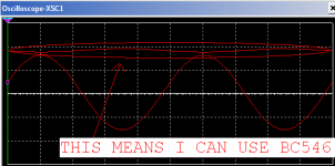

Why the perfect OPS didnt work with load, i just found out that ?
it works but with 2 diode bias, i tried with 3 (two resistors instead middle diode drop injecting signal there) and its the same as 4 😕
i want it with three or four 🙁
with two there is 0.08% thd without correction. with 4 there are 0.000 without load and 3rd harmonic is zero magnitute.
help me with this.

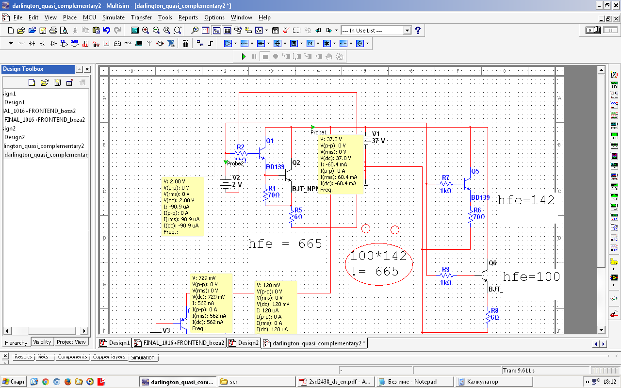

i tested the hfe of the two stages of a darlington.
i found out 142 for the 1st and 100 for the 2nd (virtual).
i read somewhere that darlington total beta = b1*b2 => 142*100 = 14200
which is not equal to 665 (total beta of the simulated circuit)
another paradox fuks me -> what is better -> to simulate my darlingtons as bd139+virtual as in attachment or to use one virtual with high beta and a series diode to its base to simulate another drop. (i change the drop in the model but theres no difference like when i change beta)
