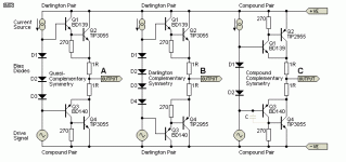

Fundamental issues here. I mean, if the goal is to create a "real" amplifier circuit with real actual components. There are different types of mosfets. They have different properties. They have to be used properly in order to function correctly, depending on the application. Generally you have lateral and vertical. Also there are different vertical type architectures. One cannot just place any transistor to any function and expect it will magically work. It appears there needs to be more research committed to.🙄
You must be joking. If you have no clue other than the amplifier makes loud sound, then there is little or no bias current if it seems cold. If you try to increase the current to that recommended for the Darlington transistors though, you have no facility like emitter resistors to measure it and you will need to estimate from the total circuit idle current. Your bias control circuit likely doesn't have enough voltage drop to generate the correct bias for Darlingtons, which in case you weren't aware, probably have a lot more inside than just 2 BJTs.Mine works perfect.
I heated up a lot and there is no thermal runaway.....I was 😱 that the heatsink was COLD. Only very little warm. very very little
Maybe this is from the bootstrapping. 😎
For goodness sake, arrange the circuit to test the bias current after startup and immediately after playing a while - read up and at least learn what makes a proper circuit design from simple examples, before bombarding the forum with a load of half-baked ideas and omissions. A gadget that plays music is a start but how does it perform? Does it have correct and stable bias? Steady temperature at idle? Is the distortion harsh at low levels? Does it clip acceptably? Does it have slight HF oscillation? Full audio bandwidth?
If you are going to try to design electronic devices by trial and error, you are in for a lifetime of failure. You can use student Multisim to draw and test the steady-state of amplifier circuits but it will be useless for practical amplifier design where dynamic load changes and factors like heating, instability, safe operation and protection from typical forms of abuse is involved.
Many here are professionals whose business it is to read a schematic and likely problems with certainty- it's their job. We aren't just out of high school so we can help with most design issues and practical choices too but first start correctly with the basics yourself - a good book of theory and practical building as previously stated, read and study ESP website etc. It's all free if you have no cash but can obviously afford a PC and the internet fees, so look carefully, there are no excuses if you really want to learn about analog audio electronics, as we might hope in this Forum.
No Im not joking, and there is 73ma bias current measured between emitters.You must be joking. ...and you will need to estimate from the total circuit idle current.
I dont think so and think u all are in big error here. U all think that darlingtons voltage drop is double because of the two transistors, but its not !Your bias control circuit likely doesn't have enough voltage drop to generate the correct bias for Darlingtons, which in case you weren't aware, probably have a lot more inside than just 2 BJTs.
There is only one voltage drop, because currents flows through the first emitter to the second via resistor !!! Then another current helps from first collector.
My bias voltages are exactly +-890mV. Bias current 73mA.

What about this people think darlington have 1.4v drop ???
And use 4 bias diodes, this is silly. Also with quasi, they all must be same, 2
There is only one drop, the first via the 270ohm resistor to out
No.
You have no argument, explain.
When voltage is 0.7 Q1 starts conduction and current flows from its collector to the 2nd base, this current is with voltage of supply voltage.
Look @ ur signature: "If you can't explain it simply, you don't understand it well enough (c)"
That's very easy to explain - you can find the explanation in any book on transistor basics.
In order for the transistor to work in the linear region (transistor is open, collector current is not zero), it has to be properly biased (Vbe has to be applied).
In Darlington arrangement you've got 2 base-emitter junctions in series, so you need 2 x Vbe for them to open. The fact, that the 2-nd base-emitter junction is shunted with a resistor does not change anything - that resistor just increases the 1-st transistor's (driver's) collector current (increasing linearity).
See a simulation fragment of the working circuit. Each Vbe = 0.55V (roughly). Power transistors' bias is slightly lower than average (0.55V instead of 0.65V).
Is it... sort of... clear?

With it is like i said in my post (the same here), just because the first transistor starts conducting through this resistor and allows conduction of the second @ only 0.7V.
If - as you are saying - the first transistor starts conducting through the resistor, there is a voltage drop over that resistor. That voltage drop forms the second transistor's Vbe bias. And it's not 0.7V - it's less in practice, as I have already mentioned.
On your picture, you've got 1.4mA overall current with 1V overall bias. Your second transistor is closed completely - that 1.4mA goes through the first one only. Put the probes in the right places and see the collector current of each transistor (like I showed in the previous post).
You contradict yourself.
Within a number of threads you're trying to argue on things you don't know well enough with people who's everyday job is designing the circuits.
What's the purpose? 🙄

Im trying to catch smth ofcourse 😀If - as you are saying - the first transistor starts conducting through the resistor, there is a voltage drop over that resistor. That voltage drop forms the second transistor's Vbe bias. And it's not 0.7V - it's less in practice, as I have already mentioned.
smth tricky 🙄
And i catched it 😀 This bootstrapping technique. Its known but nobody uses 😉
