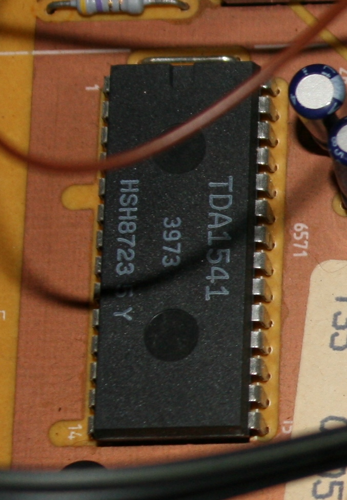

Is this a real TDA1541A?
DEFINITELY FAKES
For the simple reason that the S2 is printed (probably at the same time as the rest of the label) rather than being stamped on at a later date.
The S1 or S2 were selected items. Every one I've seen (genuine that is) has been 'hand-stamped'
Not quite true - this isn't a fake... 😀
With all this fever surrounding the TDA1541 chips and the special S1 and S2 selected versions, you'd think Philips would cottoned onto it by now and start re-manufacturing these chips.....
Maybe we should start a petition haha :scratch2:
On that pic the S2 was not printed at the same time as the TDA1541A, Andy's statement remains true.
They won't use different font set just for the S & 2, just a second machine to print 😉
On the S and 2 on the main print it's obvious, the S2 is more fat. (and for me slanting a bit).

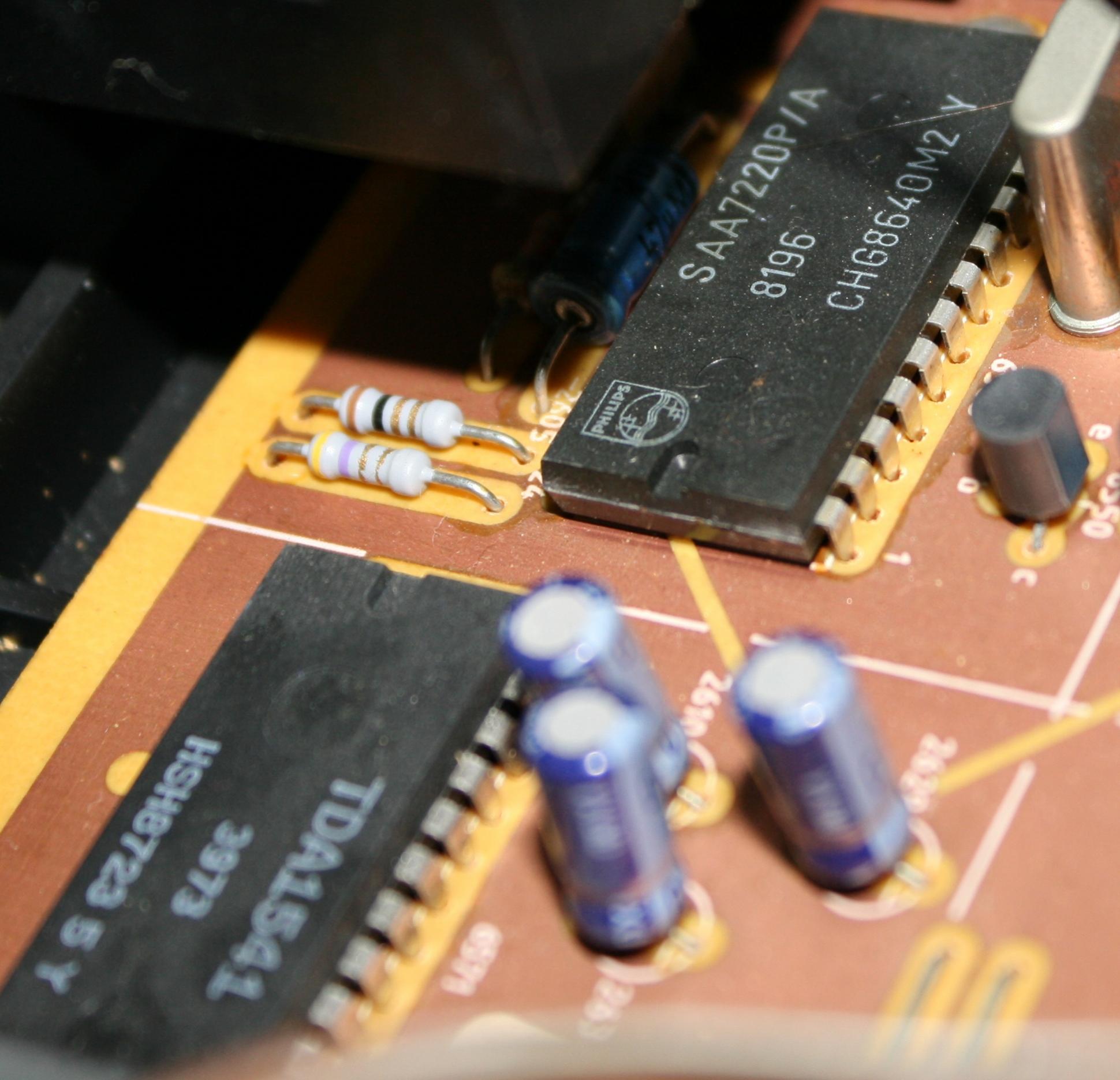

I am posting for comparation, pictures of two original cips (Philips CD473) - SAA7220P/A and TDA1541 (non-A but it might help with the datecodes).
Looks like at some point, Philips stoped stamping the company sigla on the cips (cost saving?).
