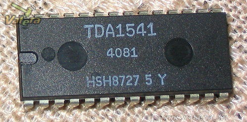

Is this a real TDA1541A?
Fake or real?
Hi!
I just bought this for ~ 5 USD.
Is it fake?

Well, if you want to bring fake 1541A on the market I think it is not very smart to put a production date on it that is immediately questioned. Isn't it?
This I agree with also as the photo I showed has a 06 manufacture date why go to the trouble and not even get the date right or the appearance for that matter .
Call me crazy but it seems they are still being manufactured the guy that was trying to sell me the TDA1514AS2 for $10 , it is not worth the sanding or reprinting effort if you ask me .

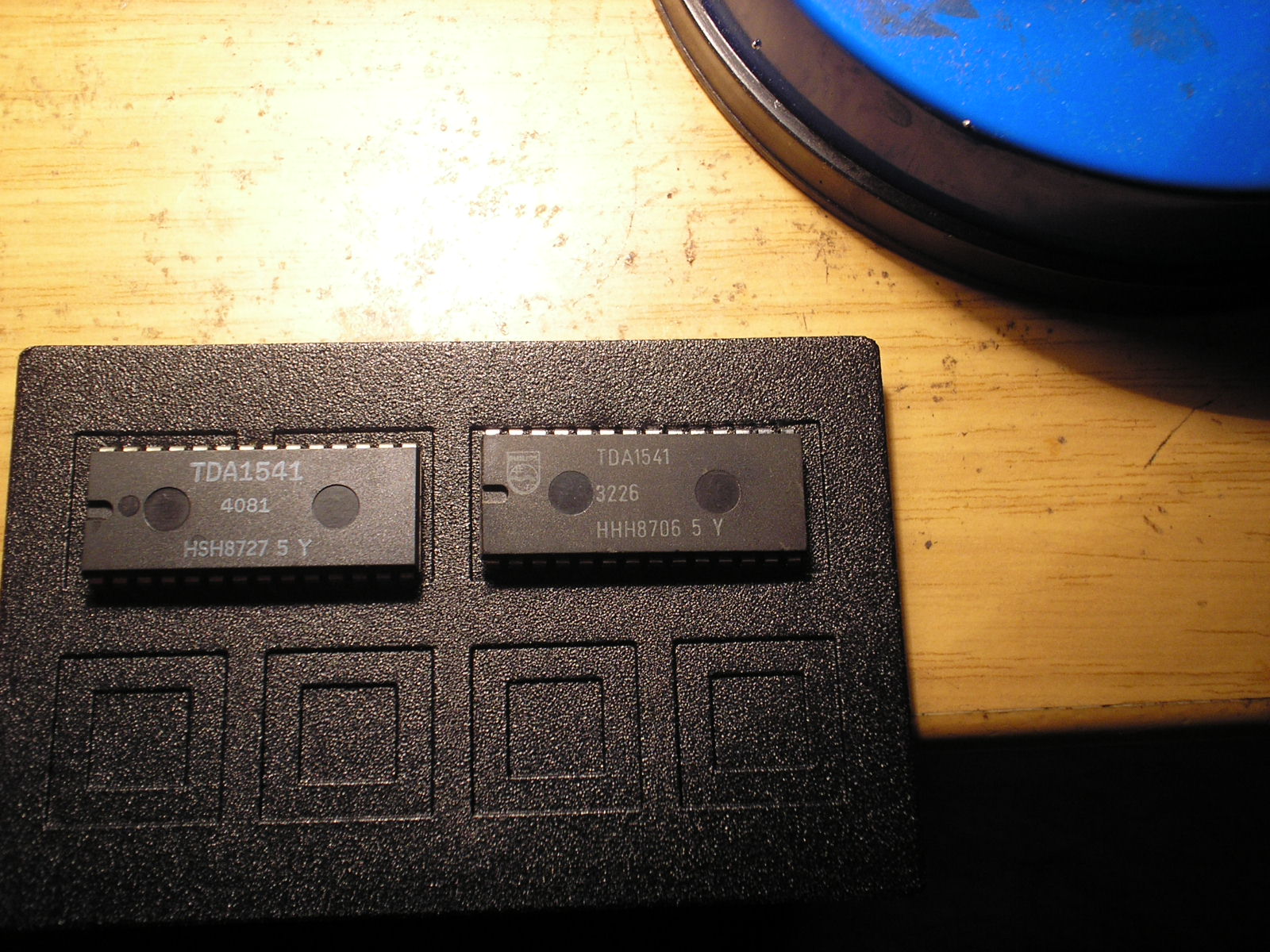

I think 06 refers to the week, not year. So a date code as shown would signify the part shown was packaged during the sixth week of 1987.
Does not necessarily mean it is not a fake if the screen printing and other details don't match the known profiles at the time of manufacture.
It's a bit naive to assume that a $10 chip would not be faked, it could have cost the perpetrator a dollar or less each to make, providing a great profit on a relatively small quantity of parts. The average salaries in many parts of the world where these fake parts originate are <10% of pay in the West for comparable work.
Hi, the chips were again in production in 2004. I had one of those and doubted it was real because of the date code. I sold my last batch including the 2004 chip with that remark to a forum member who already bought chips from Marantz Spain with exactly the same batch/date code. Please note these were laser engraved like modern chips and not stamped. BTW I seriously doubt the story that they were hand stamped in the eighties. AFAIK only the crown symbols were hand stamped.
The beloved TDA1541A is being produced again it seems ... Too bad for Ebay speculants.

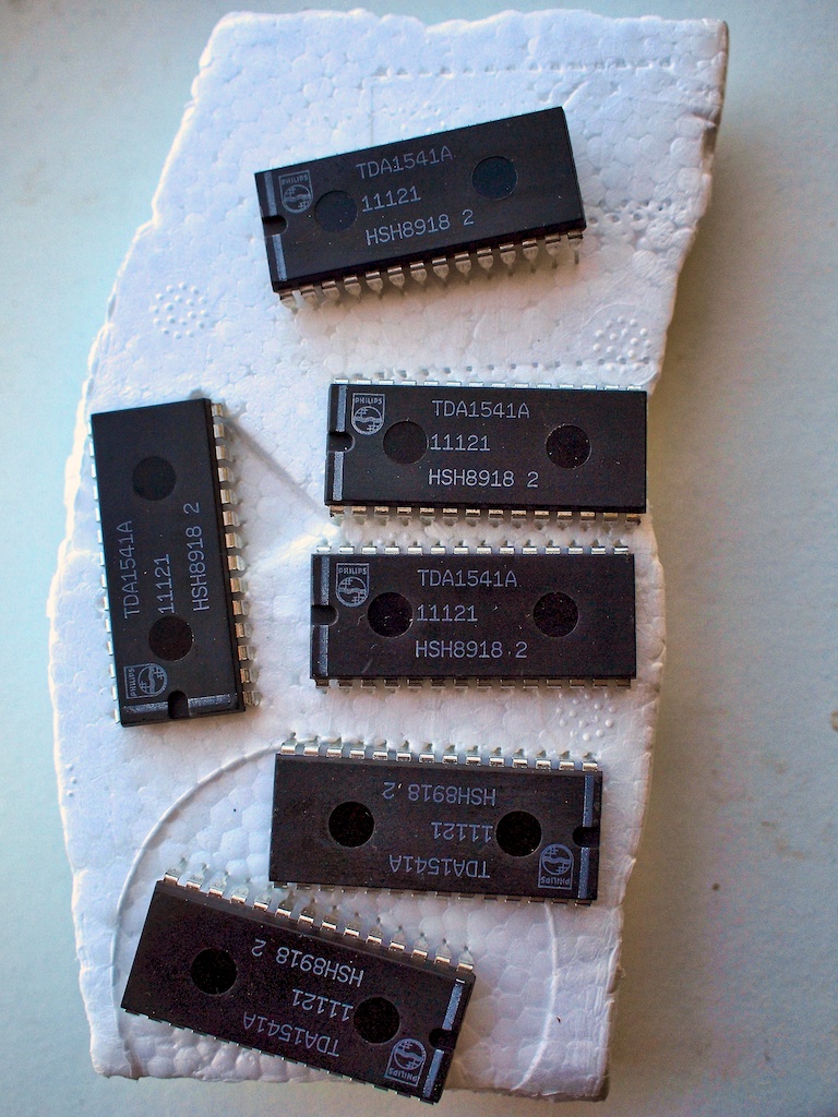

Hi
I have 6 old TDA1541A that I was thinking of selling, had them since 2001 to build this project but never got around to it (that was me in the email)
see
source of tda1541a chips - steveor - Tweakers' Asylum
The text is 11121 HSH8918 2 , all have Philips logo
but did I understand that Jean-Paul state that they were now back in production so essentially worthless?
thanks
Steve
Here are attached pics, couldn't take photo last night
