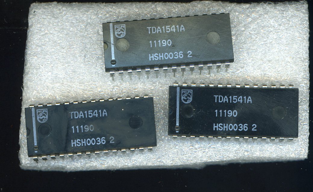

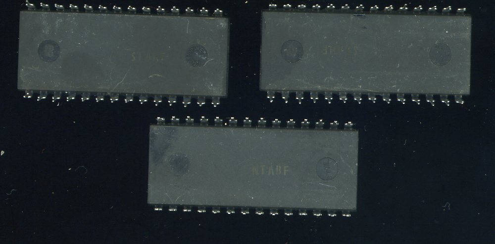

Here they are. The scratches are in black paint Underside show made in Philipines....
All pins have been soldered before.
The static plastic packing is also foolish, clearly amateurs!
and the same indent plus dot HSH00xx...
I don't remember any of my genuine TDA1541A with marking on the underside.

I bought 2 pieces of TDA1541A from eBay:
IC PHILIPS DIP-28 TDA1541A | eBay
At the photo, even though bad one, you can quite clearly see the right font used, but the ones I got are a different story...
I'm not going to risk my player and try them out, as they are obviously fakes of some sort.

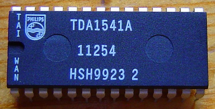

No ohmic contact between those pins is no warranty for real. There are different fakes. Your first one looks good. but should not it RSH for the Taiwan instead HSH? The first HSH from netherland in year 1993 with batch 11201. Over two years later produced in another country only 54 batch numbers further? but i'm not sure. maybe it is a good indicator that thy are desoldered. Good luck

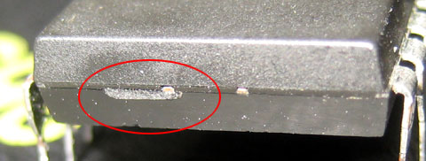

I have 2 genuine TDA1541A Single Crown and can confirm that neither has the indent/casting defect at the front of the IC package. I also ran a multimeter down each side and got open circuit for pin 1 to pin 2-14, and open circuit for pin 28 to pin 27-15. In fact every pin to pin combination I tested (i didn't do every conceivable permutation) was open circuit.
I bought two of the sanded front fake TDA1541A's with indent at pin 1. Most pin to pin combinations gave some kind of resistance. They are absolutely fake.
