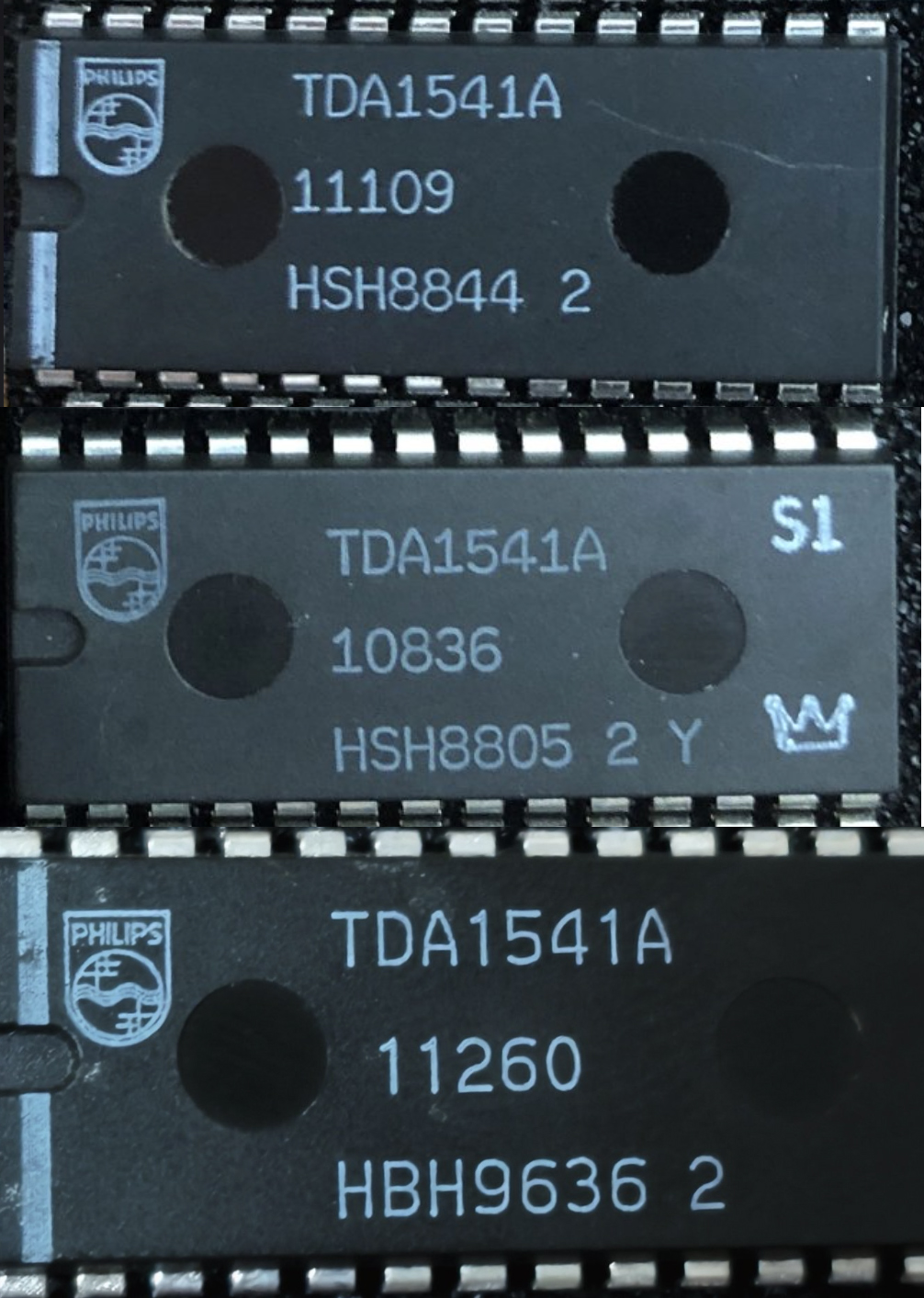

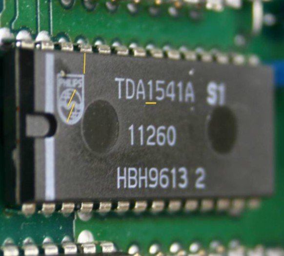

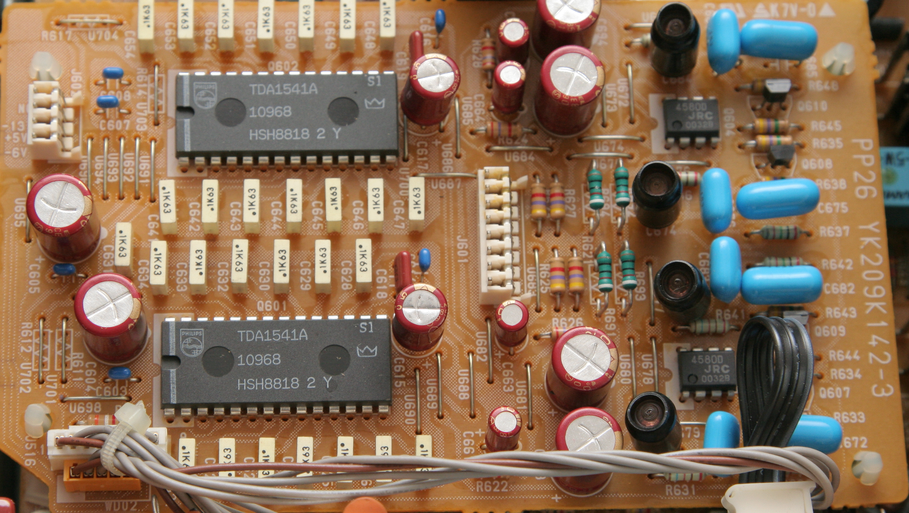

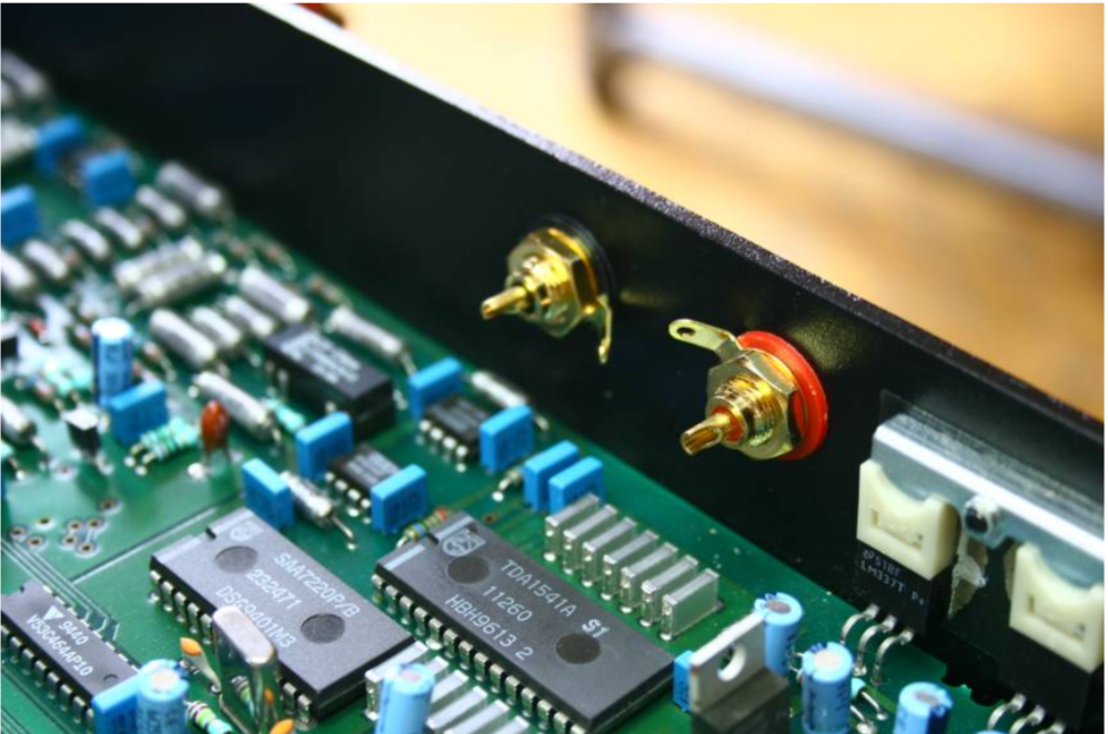

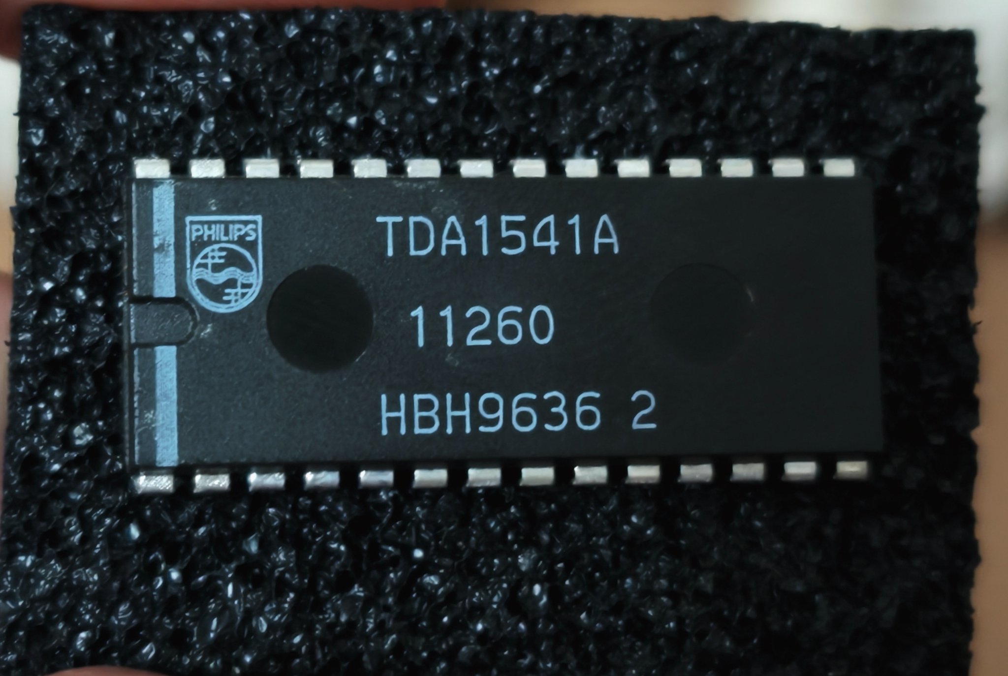

I have such a chip (photo 1), its authenticity haunts me. My preliminary conclusions are as follows: it works pretty well, it does not heat up, the contacts are not magnetic, there is no resistance, the font is similar. But the HBH labeling is confusing, because no one has confirmed such labeling before. I also found an article about NAIM CD3, where the photo shows that a chip marked HBH is installed, although it is S1 (photo 2,3). S1 is an additional marking after the factory one, and I hope that NAIM did not install fakes in its equipment.
What do you think about it?

The first two are mine and are 100% original.
Look at the letters and numbers.... the third one seems to have letters and numbers that are written in a non-continuous manner. I am not sure, though, if that is a sign the chip is not original... Also, the numbers' font is different....
But also, there's a difference between Philips logos... the third one has four horizontal lines that are longer than the horizontal lines on the first two logos ... now that is certainly suspicious, at least to me....
... also, the third Philips logo is not as tall as the first two...
@E.Boky Two questions please :
1. Regarding the two top chips, the font is clearly the same but the colour of the writing is quite different with the middle chip being white grey on a much paler chip - that latter situation presumably is quite usual.
2. The S1 and Crown looks hand stamped in a different font. So how can one tell that it isn’t a fake ? Answering my own question, I guess it came from a legitimate CD Player which normally contained a S1 chip ?
Many thanks

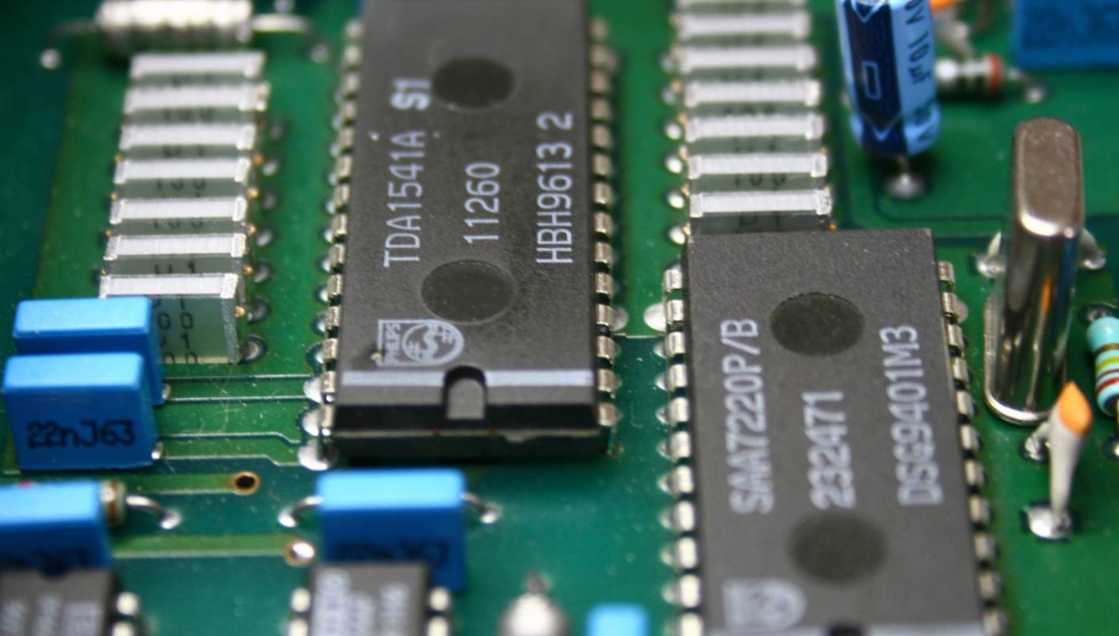

I've read your examples, but pay attention to the chip that NAIM installed in his CD3. It has many similarities to mine and is also different from yours. However, the angle of the photo is not good. I assume that this is the difference in labeling between the 88 and 96 chip releases. 2 photos from this camozzi post. Also very similar.
Thank you for your participation.

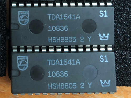

I bought the plain TDA chips many years ago from Wagner Electronics, a reputable seller in Sydney, Australia. I also personally tested them - they are all 100% genuine.
The S1 single-crown chips are also 100% genuine, removed from the Marantz CD94MKII CD player. I can confirm that the S1 and the crown-symbol stamping were not confined to the exact same area.
I modified one CD94MKII for a friend. He had a second CD94MKII he bought overseas... he removed all the PCBs and only brought those back to Australia - less bulky. The two Marantz CD94MKII DAC ICs had S1 and crown stamps placed in different areas on the ICs. Go figure. Someone was checking them all, and selecting the S1s manually, and putting the stamps by hand.
With so many variations, I suppose the only way to be certain about chips of unknown origin is to check their THD.
Reactions: highfell

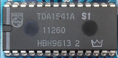

I found an educational video where the author demonstrates a simple way to verify the authenticity of the TDA1541A without using measuring instruments, which anyone can do. Make a short circuit between pins 17 and 18 during playback, which in the original chips should lead to distortion only in the left stereo channel.
