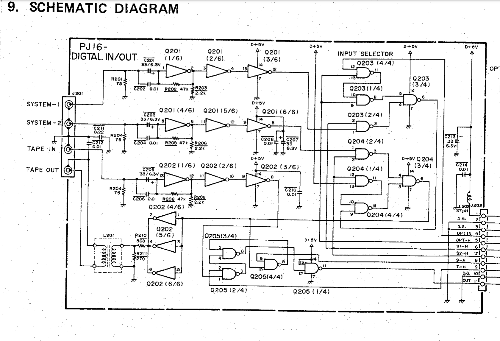

... oh, you can hear them... if the coax is done properly.My gut feeling is that any differences in sound between coaxial and optical inputs (assuming you can really hear them)
... well, yeah... look at what Marantz did with those coax inputs:I have also read that the CDA94 sounds better with an optical input versus the coaxial.
