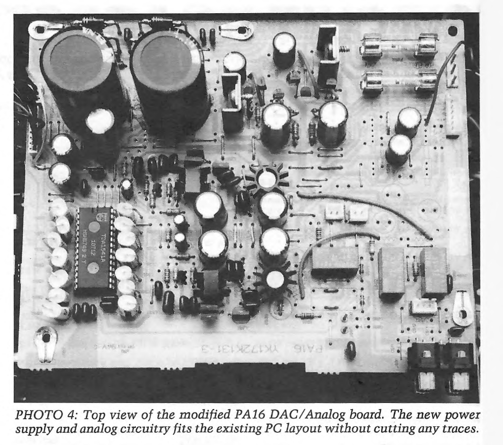

This looks like a DAC960 ,but the one in my picture is modified, (audio amateur 02/92).Thanks all. Very helpful advice. Having looked inside the machine the DAC chip is in a slightly awkward place to remove even with the use such tools. These chip are nearly thirty years old. So I will just have to be very patient and leave it to an expert to do the job.

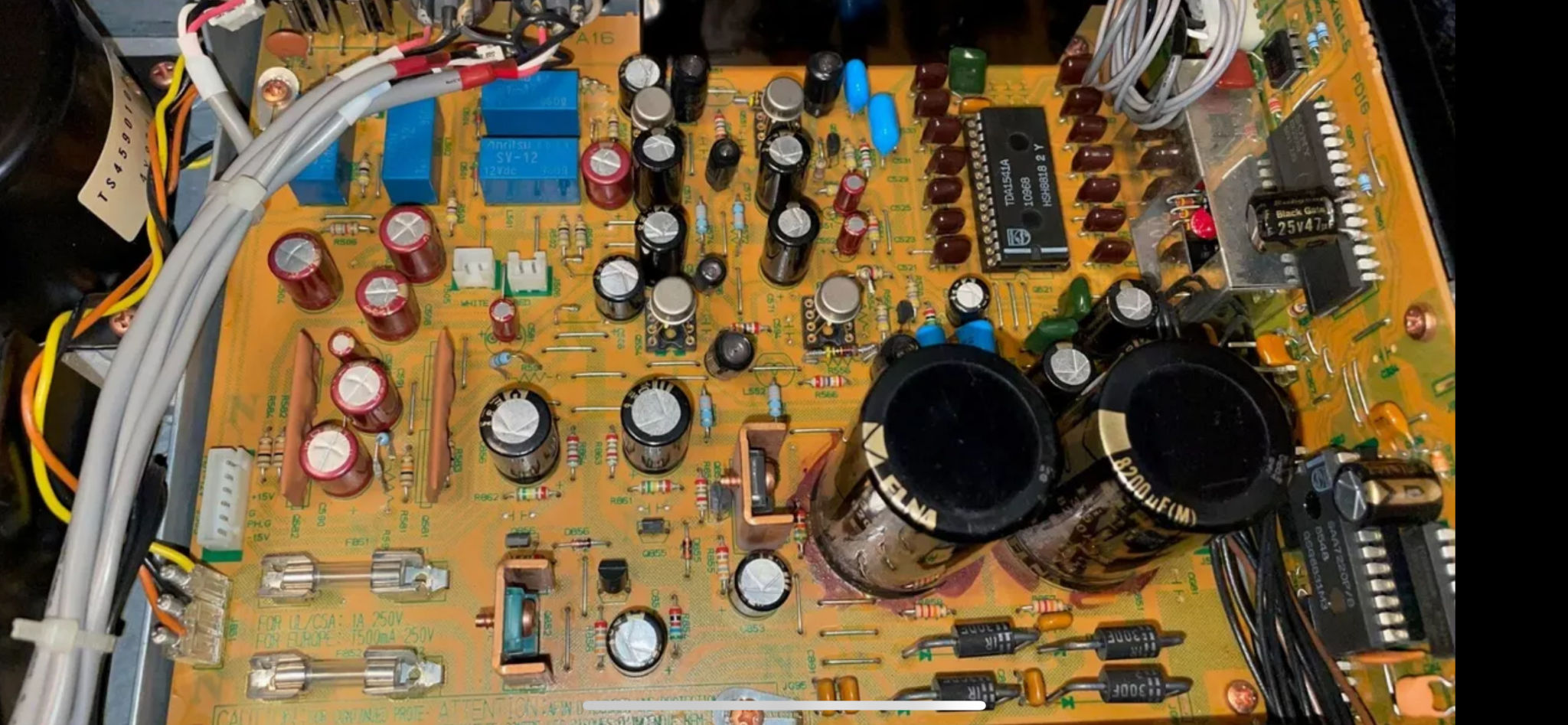

It is clear to me the big Elnas and the little black ones were swapped already (Black Gates).
The black Gate migth add à dark and organic touch to balance the cerafines, The big Elnas are also on the valve side. 8k uF is certainly too much...but well they are there so keep it, seems new swap as well.
Best bet: keep the cerafines or change them for Panasonic FC for near the same behavior. Keep the Black Gates in lieu.
Some caned op amps gave good spec due to their métal packaging.
Too bad the dac chip was swapped for a lower grade one in spite of the S1 , hence the socket.

As regards the existing DAC chip, I believe it is original. The socket was put in by the upgrade specialist who did offer my vendor an 'S1' chip instead (and he listened to it and compared both the 'A' chip and 'S1' one, but he felt the better sound of the 'S1' didn't merit the additional cost he was being asked to pay. Any way I have a 'S2' to put into the socket, so that is fine.
I am not aware that the two large 8k uF Elna Capacitors have been replaced. Only the Black Gate upgrade and Opamp upgrade was mentioned.
The other major modification was to the board itself in order to make the signal path clearer ie no headphone output, no XLR output and no variable volume output.
When you state that the Panasonic FC will sound similar to the Cerafines, you are referring to the small Red coloured capacitors . Is that correct?

To me the biggest Elna seemed newest plastic package but I can be wrong. Yes Pan FC to swapp the Cerafine (the reds) if you think it needs to be swapped. Maybe the guy did that already with NOS stock and reformed caps, we don't know.

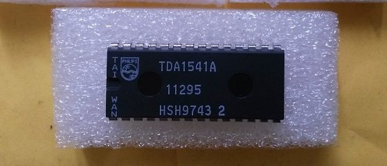

That's not a Taiwan chip.Thanks all. Very helpful advice. Having looked inside the machine the DAC chip is in a slightly awkward place to remove even with the use such tools. These chip are nearly thirty years old. So I will just have to be very patient and leave it to an expert to do the job.
I think the expiring DAC chip is also Taiwanese but obviously it is just the 'A' version.

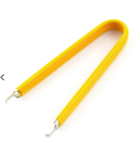

I have that tool, I don't like using it for TDA chips, too narrow and the chip can come out at awful angles and bend legs.
To lift the chip grab a stiff lengthy of plastic slightly narrower than the chip width so as it fits the width under the ends, then applying heat bend the ends about 8 or 10mm at right angles, and also bend the piece in the middle, so it looks like that tool someone posted, but this way it will be supported evenly across the underside at each end.
Then slowly work it up and out while making sure it is lifting evenly.
Sorry, I missed the "S' in the code.That's not a Taiwan chip.
So HSH8818
H = Nijmegen (Holland)
S = Kaohsiung (Taiwan)
Manufactured in the 18th week of 1988.
