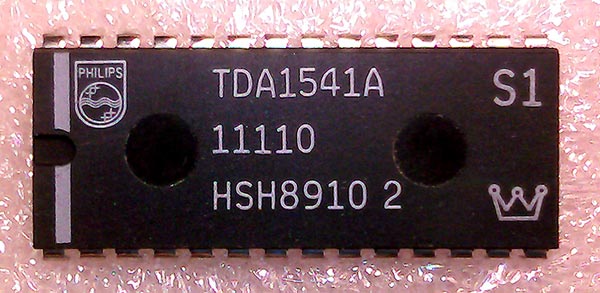

i dont know... I bought 2 tda R1 for my projects but i have no idea if they work or not...
i paid 25 $ each if i remember. I dont know what do to with the one in my cd player... I liked it very much... its miles better than any pcm56k but the sound of only one doenst satisfy me.

Hi Amauta,
I can't really tell you whether it's real or not, there are some things that are right and some that aren't or are a bit.
- Production date and location match
- Batch seems pretty ok
- The crown and S1 mark are too bright white, can be NOS though
You have a good chance of buying an original one, so not fake.

Fake on Ebay ??
This is now on Ebay.
HSH for Holland manufacture ... or .... Taiwan
Maybe it's a fake ?

EDIT :- The seller is Tzeng-Albert .... a well-known scam artist

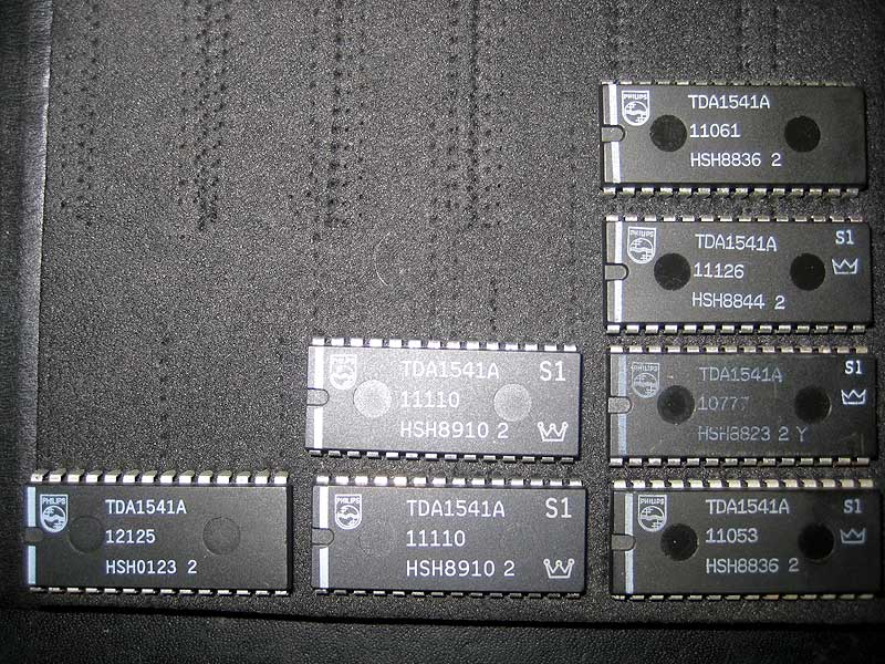

I bought one because of that photo but I got a different (and fake) chip, that overloaded the -15V supply.
I complained about it and he told me he would send a "Taiwan" chip like the one in the photo.
This was a month ago, I'm still waiting for the replacement part (but shipping is pretty slow to Italy..)

Finally got the replacement chip from Tzeng-Albert, ant this time it looks like the real deal.
In this photo the first I got from him was the second in the left column, marked HSH0123. This was a fake that overloaded the -15V supply.
The second I got is the one in the right-bottom corner. This one works well and if you compare the markings with the double crown they are identical so the chip is really a '98 Taiwan chip.

This is a real thing ! TDA1541A S1

In the attached pic: left = fake, middle = not sure, right = original
The most remarkable at that fake: Pin 1 to 14 = 5K Ohm, Pin 16 to 27 = 3,5K Ohm
As i see in the right a S1 from week 44 in year 88 with Batch 11126
is it possible to have a S1 from later week 10 in year 89 with smaller Batch 11110 in the middle?
I would be grateful for further information to the middle DACs.
Yes,
Look at the font at the top marking of
"fake"
number "4" and letter "A"
if You see these chrs from the same font as marking,
be sure that chip is a fake.

Your "Fake" is identical to that shown by ANDYPAIRO in post#170.
That came from a well-known scammer, 'Tzeng-Albert".
Where did yours come from ?

Look font at "4" and "A"
Yes, this is a fake in the left in my former attached pic as you shown first in your post 137 and andypairo in his post 170.
If i understand right, the font is not the most remarkable. Look at the chips with productionplace JSS. Those seems to be original and have the same different font.
Maybe more the datecode is an indication for a fake. But in a very dangerous kind the possibility to kill your CDP it is.

Does somebody know somewhat to middle dacs in my pic?
Here, here and here they have the same inscription however deviating ink in S1 and crown.

The only thing I will say is that the grading stamp, whether for S1/S2/crown/R1 , is always stamped after the main markings.
However, take a look at paul_peraic / post#152 ...
The grading stamp looks as if it was printed at the same time as the main body print and I would say this is a fake.
