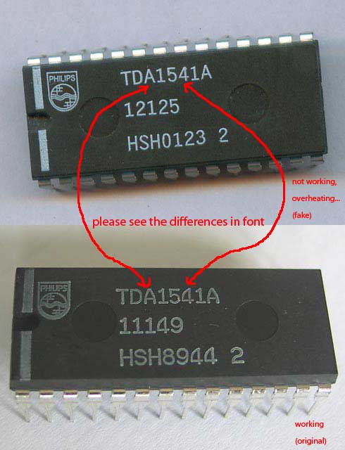

Same batch as mine? I see they are grinded too
http://www.diyaudio.com/forums/showthread.php?postid=861956#post861956
I had 10 of the TDA1541A on e-bay ; claimed to be of the year 2000 none of them was working .
Just lot of heat .
The seller was honest anyway and refounded me .

I have six 1541 dacs ordered few years ago, two are original: moulded surface and printed, four are sanded off (probably with scotch brite) and reprinted for some reason, i guess for a relabeling to "A", the production year could have been anything then.
But they sound all about the same.
stefanobilliani said:I had 10 of the TDA1541A on e-bay ; claimed to be of the year 2000 none of them was working .
Just lot of heat .
ECdesigns ordered some TDA1541A's from a parts distributor and received relabeled TDA1540's, allmost fried his dac with them

Does the upper printed black surface have an other appearance compared to the back?: if yes it is sanded/relabelled for sure, i can see that on my JSS9721 2 batch. On your posted photo the round circles are not grinded, and more even black colored compared to the higher sanded surface.
But they can sound good, it is not a bad chip Jon.
When i upgrade a TDA1541 to TDA1541A i keep the dem cap with both chips, only pin 4 can be grounded with the "A", and pin 4 of plain 1541 is connected to BCK (4.6 or in non-os 2.8Mhz)
Here they are; (Sorry for poor photo resolution. Grabbed from an earlyer post on internet)

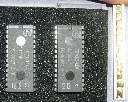

Hi Tubee,
I've had a closer look at the JSS97.
The centre circles are shinny whilst the surface of the chip is smooth. This is just like the other HSH89 and HSH93 chips I have. (I have seen some fakes where the centre circle is smooth)
The Philips logo isn't as sharp as the other chips.
The font is different.
The surface of the chip is smooth. The surface of the others has a slightly mottled appearance. If you run your finger over it you can feel the difference. This might indicate that it has been sanded ? Or perhaps the surface of the chip was cleaned in the factory so that the ink would adhere. If this chip was made in 97 perhaps the original stamps had worn out or had been thrown away so the chips had to be printed instead ?
There is one final thing. The white line at the left hand side of the chip goes down the sides of the indent. On the others it doesn.t This might be an indication that the chip has been printed rather than being stamped. This might also explain the fuzzyness of the logo.
I don't think that any of this clearly proves that the chip has been sanded and reprinted or is a fake though.
Jon

Yes i discovered too there are differences in letter types used.
The printing is usually done with a silicon rubber stamp, this is the same way to print dials of watches. The indention in the chip is then printed too, the soft rubber touches deeper area's also. The ink is drawn with the rubber tampon from an with typing etched plate.
The smooth surface could be indeed indicating sanding, because a (blacker) mottled surface is the original surface finish from the plastic mould of IC body.
When i have a camera post some very near difference pictures.
