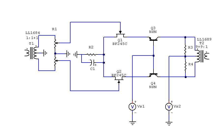

I want to build a non feedback (NFB)amplifier now... Is there some body knows [...]
This one is local NFB.
I really wonder if it could be improve with simply methods;
because the schematic is too simply to work proper from the start – probably there should be used precision current regulator thermally coupled with output devices?
I had many problems with regulation of the parameters during simulation.
But to whom it may concern?
Maybe anyone could give any advises (except “go to ....”)?

Very original idea, padamiecki.
I like it
And I think it can work good.
Of course, selection and matching of JFET and MOSFET
would be needed to make best possible results.

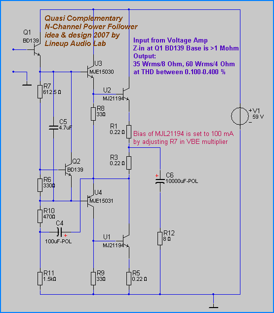

This one below shows good and low distortion
!without feedback!
at 60 Watt / 4 Ohm and 35 Watt / 8 Ohm
It is a Quasi Complementary Darlington power follower
Using 2 N-Channel MJL21194 for output
Is very easy to drive.
For example using a good PreAmp,OpAmp or Tube as voltage amplifier.
Input impedance is tested to > 1 MOhm
Enjoy!

lineup said:This one below shows good and low distortion
!without feedback!
Nope!
I can see lots of local NFB everywhere.
mikeks
you probably don't know what we mean
when we say 'non-feedback amplifier'
but most would understand what we mean
this is the main thing
lineup
